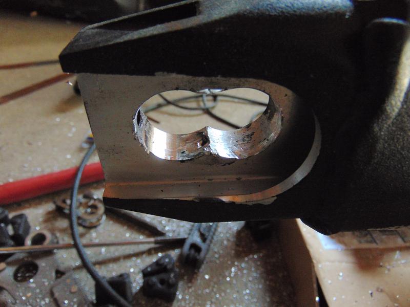

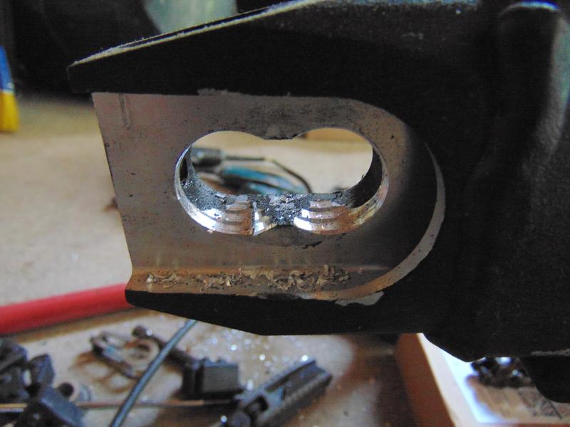

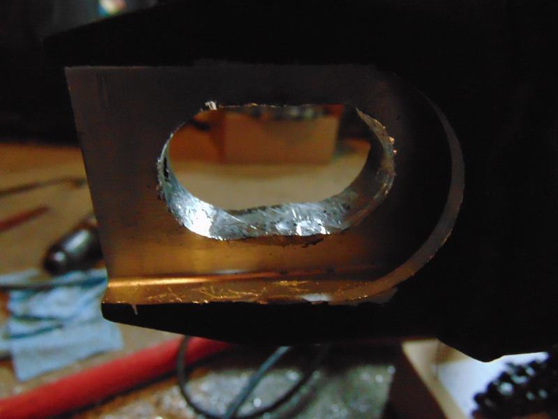

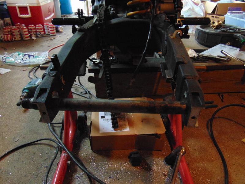

So picture time...
reamed out the swingarm at both ends of the slot with a 1" stepping reamer, hand filed the ridge inbetween, then used the 1" drill bit to make sure its clear all the way front to back. Like I said, its not pretty at all but it does the job...

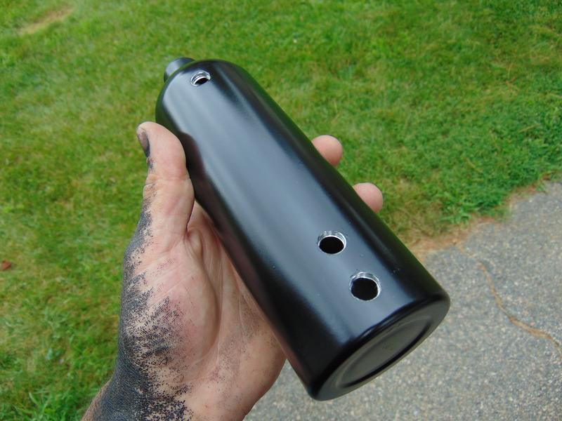

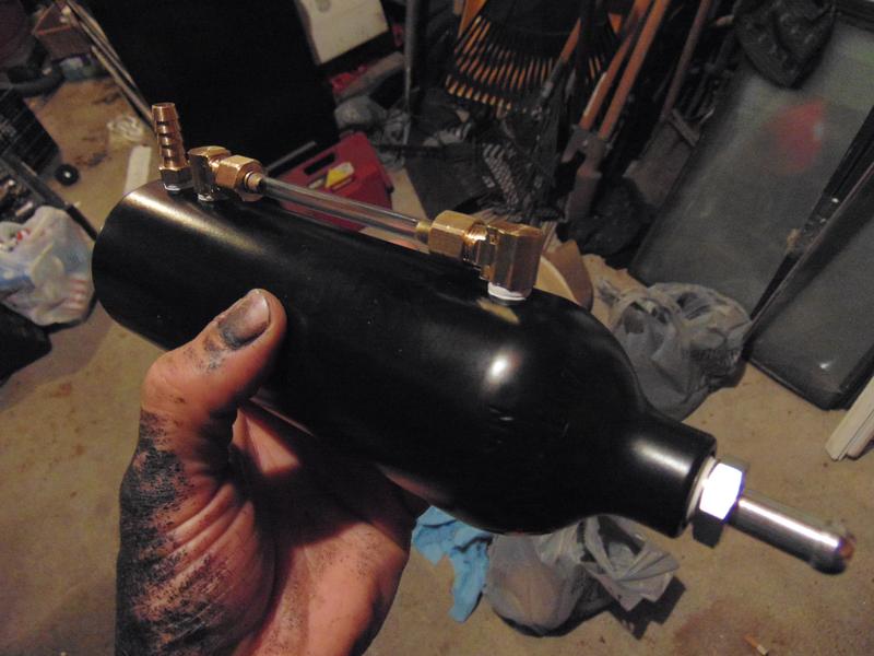

Because i chipped up the finish on the CO2 tank I sanded it down cleaned it up and painted it

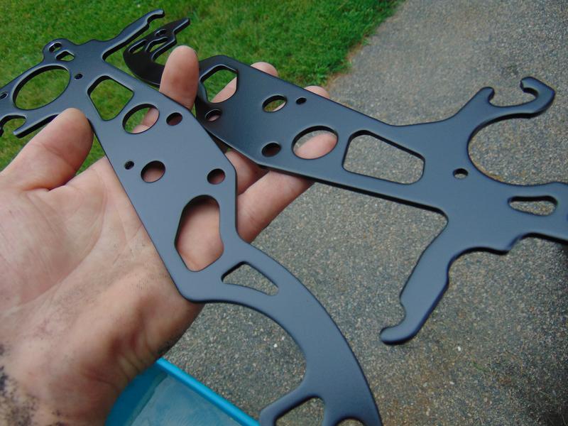

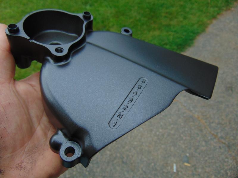

I also painted the front sprocket cover which is the last engine cover to be painted
And lastly painted the carb brackets. Too bad no ones ever going to see them once they are hidden in the engine bay, these came out awesome

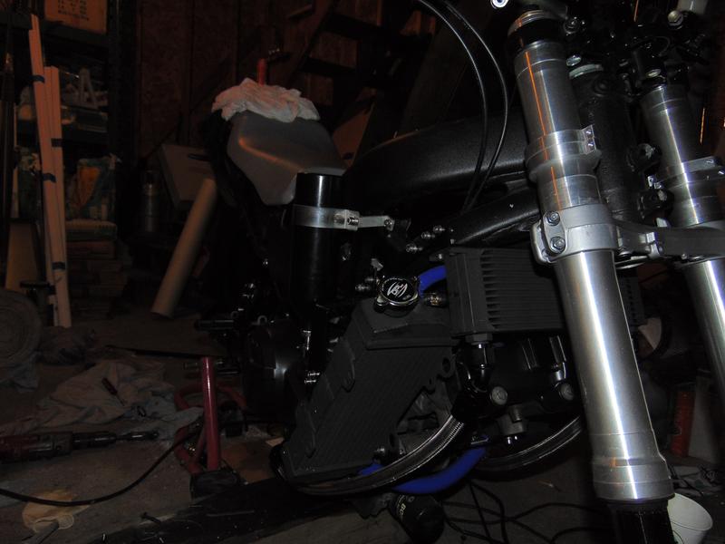

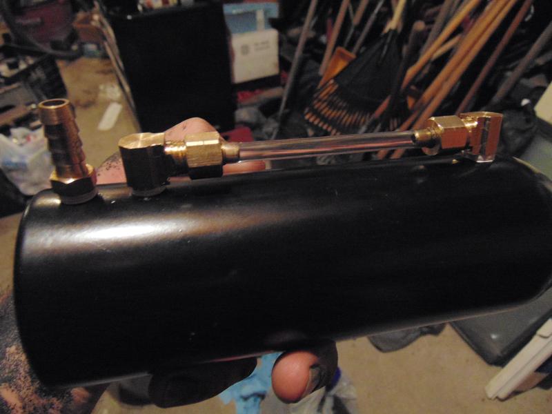

Thanks man

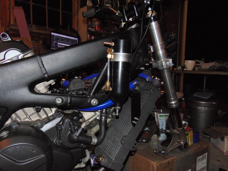

so finished up the res tank, just have to mount it and hook the hoses up

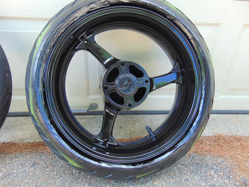

Old Jul 19, 2015 | 08:46 PM
  #350
scottiemann's Avatar
Posts: 1,252
From: boston

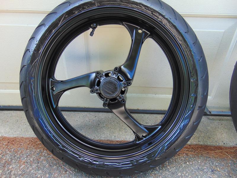

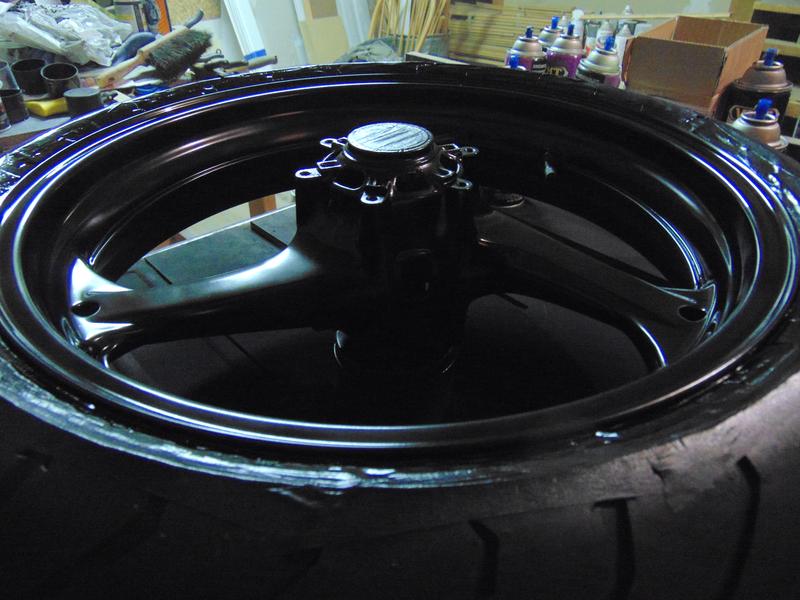

So I havent been able to work on my bike much in the past week, daycare was closed so I had my son all day monday as well as thursday night through a few hours ago. Also started class this past week so I've had almost no time, the short time I did have I was way too beat up from work to do anything...
However after dropping my son off tonight I finished prepping the front wheel and just finished painting it a minute ago, as usual sorry for the shitty lighting but at some point this week I'll have it mounted and can take a daylight pic.
As for the rear wheel, I finally dismounted the tire off my old wheel I just need to get some longer zip ties to mount it on the new wheel. once its mounted I will be doing a quick sanding to fix my fuckups then prep, tape and paint. Hopefully I can get that done in the next couple days...
next up is rebuilding and painting the calipers so I can finalize my brakes...

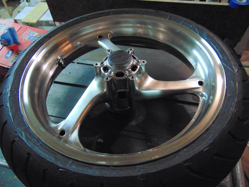

I wish I could start tonight over, I am having the worst luck with this rear rim, all I can really say is thank god I had already planned on repainting and fixing my previous fuckups with this rim...

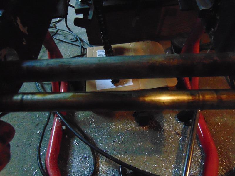

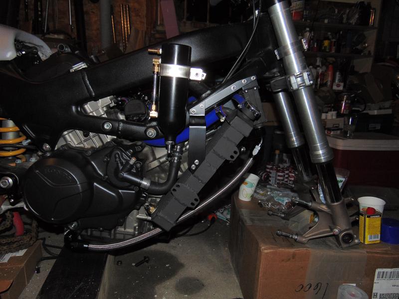

Alright, my original plan was to mount my sweet *** CO2 tank to the subframe but as I was mounting it up tonight I realized I was going to run into some serious tire clearance issues and short of spacing out the peg bracket ATLEAST an inch, I decided to move on to my plan B location, and I have to say it looks ****** awesome...
Thoughts?

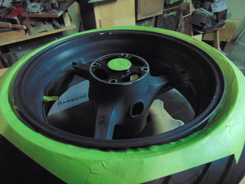

So last night I popped in some fresh new bearings for the rear wheel, finished prepping and then painted. The front wheel is good to go back on the bike once I clean up the rotor mounting surfaces. I still need to modify the CBR adjuster blocks for the rear wheel, pop in a new bearing on the sprocket carrier and I think thats all I need to mount the rear wheel...

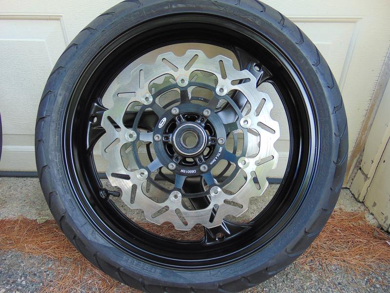

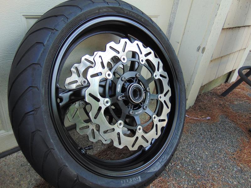

Alright got the front wheel ready to be mounted, next up, the rear...
