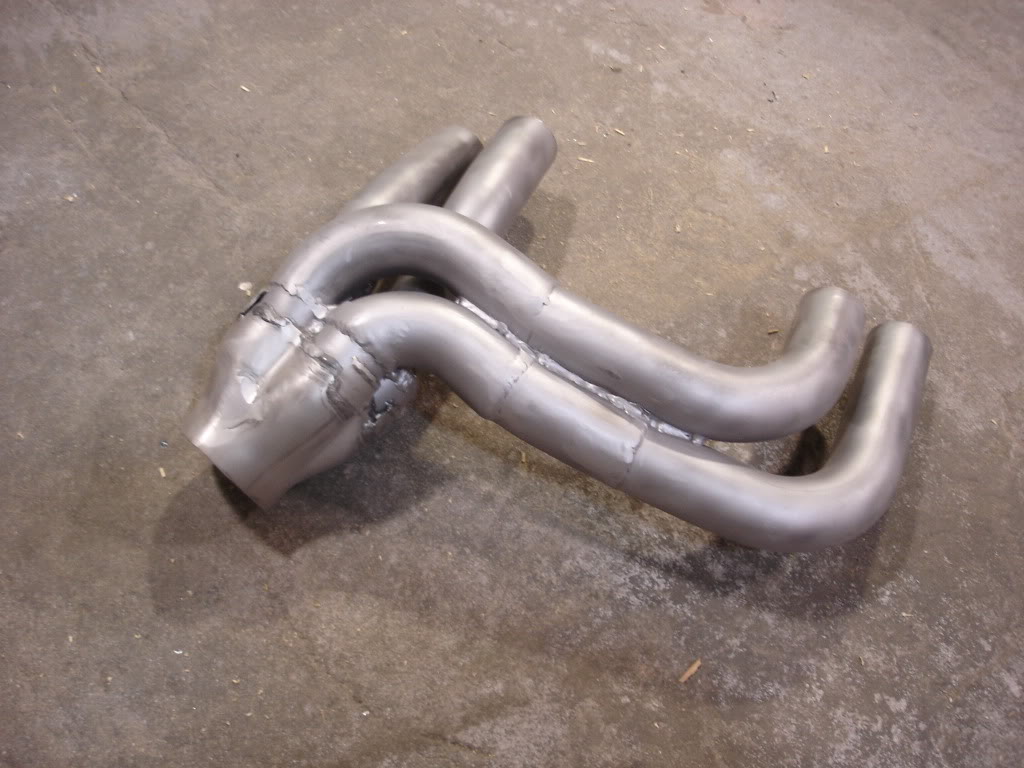

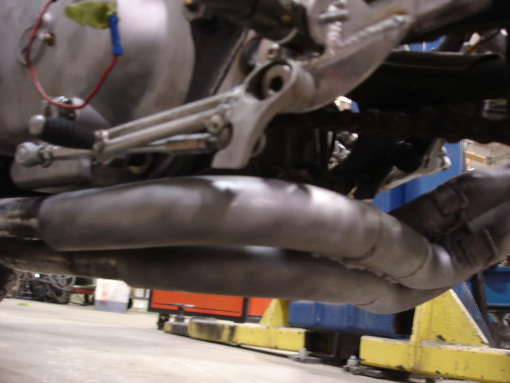

Mid pipe just about done.

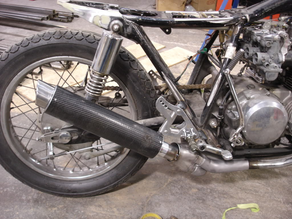

more progress

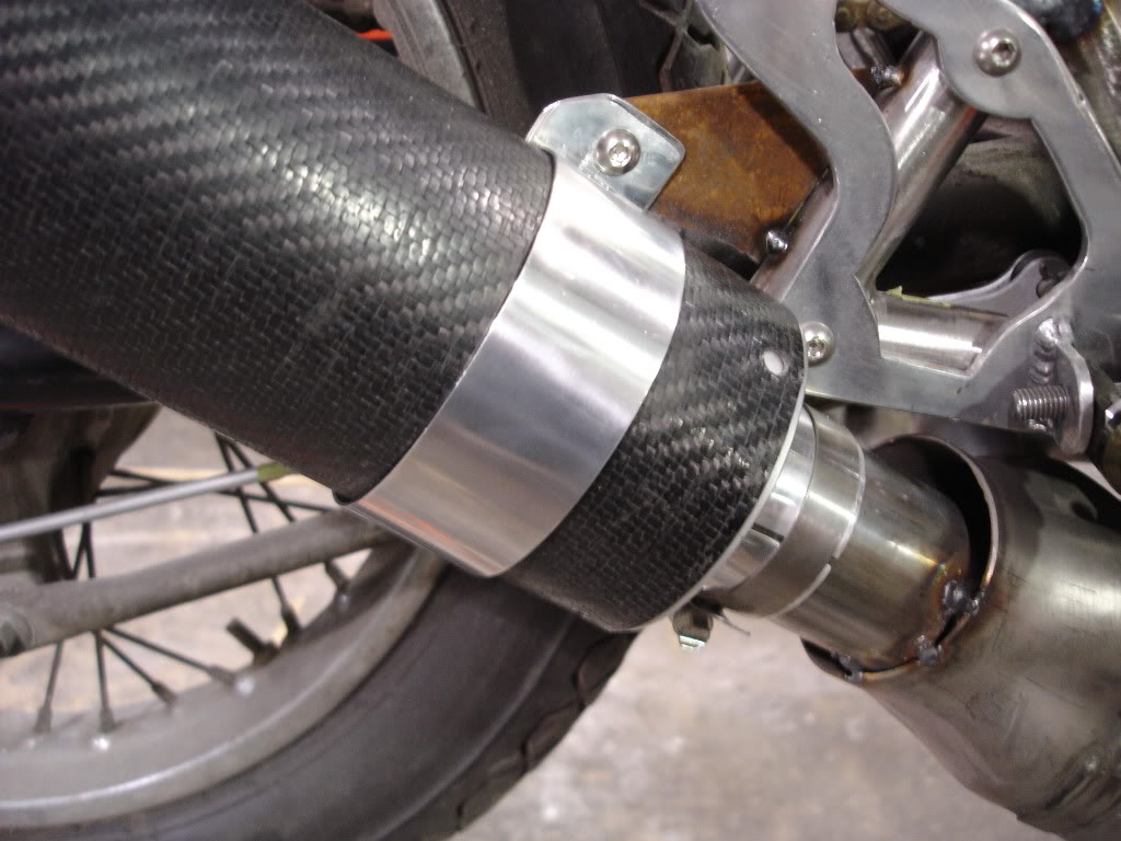

Exhaust clamp...

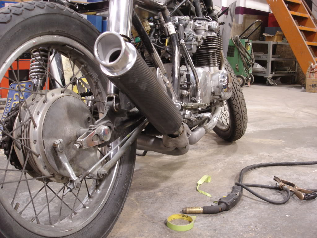

Getting pretty close here, all major fab work done. I still need to make a hugger for the rear wheel. Other than that here is the itinerary.
Finish welding exhaust.
Move seat mount (fix)
Remove Engine
Remove forks
Remove Swing Arm
Clean up swing arm and frame.
Paint Frame and Swinger
Fix engine oil pan leak
Polish Engine covers
Service forks, new seals and maybe new springs.
Now for parts:
Tires Front and rear
Chain and Sprockets
Air Filters
Inner tubes
And more I am sure, but for now thats the major stuff.

is that an Al strap ? imo, it'll crack ( from vibration ) & without the rubber barrier it'll cut into the CF.
i made a couple of clamps for my RC51 exhaust project... none of them lasted long. granted, they are different bikes.
for my current pipes i bought a replacement hanger for like $15. the SS strap sits in a grooved piece of rubber. your pipe is pretty small but maybe a D&D clamp would work ?
looks like it'll be ready for spring ! cool.
are you / were you going to powdercoat the wheels ( black ) ?

I was going to put a rubber barrier between the aluminum strap and the CF. I can always go ahead and make a replacement stainless strap but I think I will test it out first. I have been to D and S, they are the shop I usually take my wheels to for tire mounting and balance since in 1o to 15 min you can have your wheels back. Makes for an easy lunch break trip since they are 5 min away. I was thinking about powder coating the rims, but the process makes a pretty thick coat and I have a feeling that it will crack from the stress of the spoke to rim points. I will probably paint them first and see how it goes.

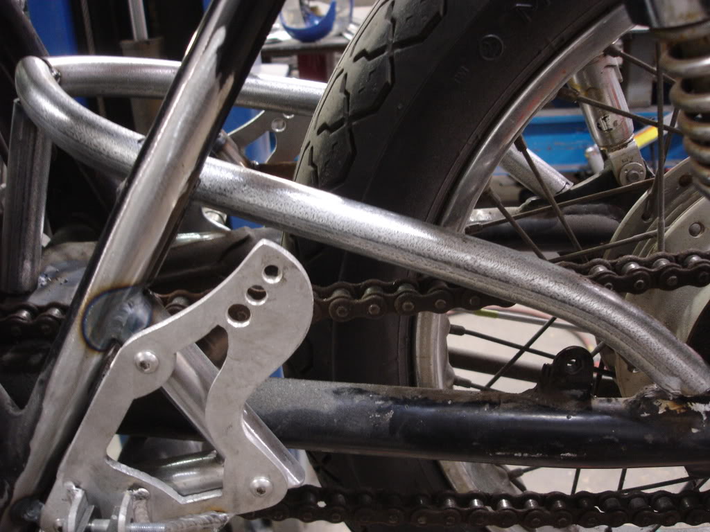

Opinions?
the brace,stay or go?

Posts: 4,517
I love when you update this I can't wait to see it done. Put me down for yes on the swingarm brace.

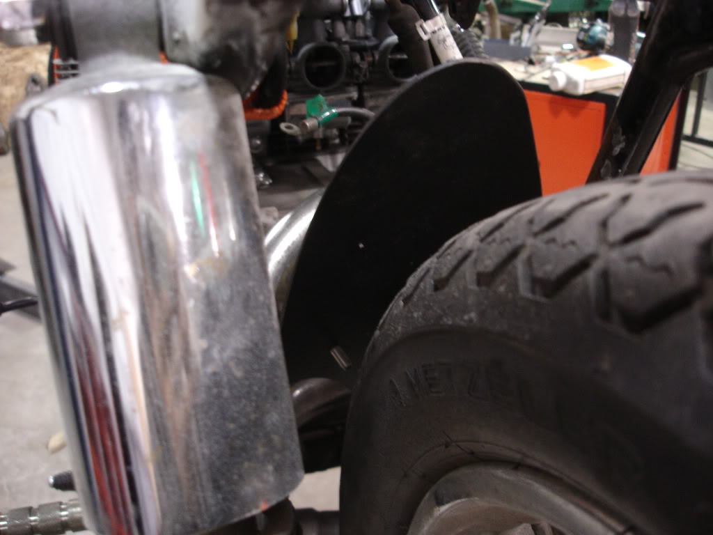

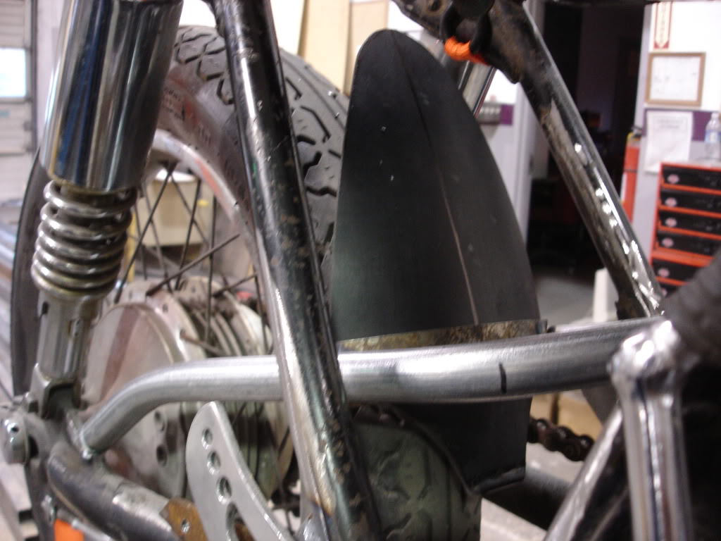

Hugger
Well, keeping the brace makes for installing the hugger easier.
The hugger has breathed a little superhawk DNA into the build, its an old windscreen I chopped.

yes on brace and yes on hugger...great project.

+1 both the hugger and brace. That's gonna look sick. Keep it up.

You will need that brace when you are backing it in to the turns at PIR. Lookin good man!

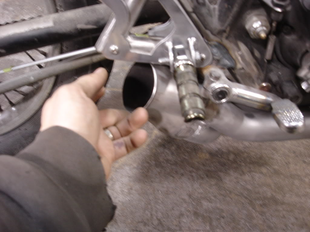

did you put a mounting tab on the collector ? you don't want all that weight / force on the header bolts.
tim
Old Jan 6, 2010 | 04:09 PM
  #268
Little_Horse's Avatar
2nd mouse gets the cheese
Posts: 1,697
From: Beaverton, OR
tim
hadn't even crossed my mind, see I knew putting my build up would make a difference. It should be pretty easy to mount up too. Where is the slaps forehead emo....
Thanks Tim, it shall be remedied!

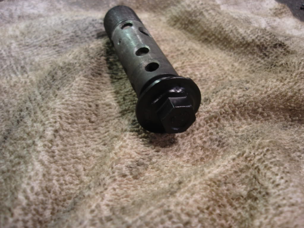

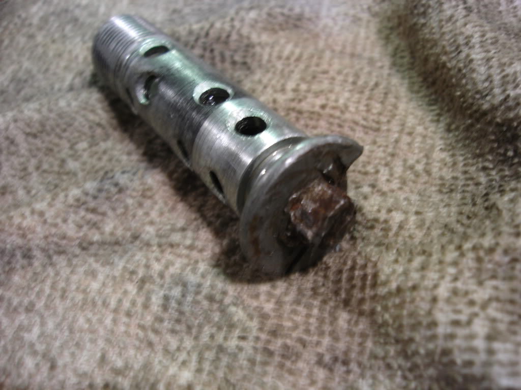

Buggered!
So seems as though a hack mechanic touched my cycle. See it appears as though some people shouldn't even do oil changes. This is the oil filter bolt which as you can see is a specialty bolt and has a buggered end from someone who didn't have a clue. Anyways, before and after.
