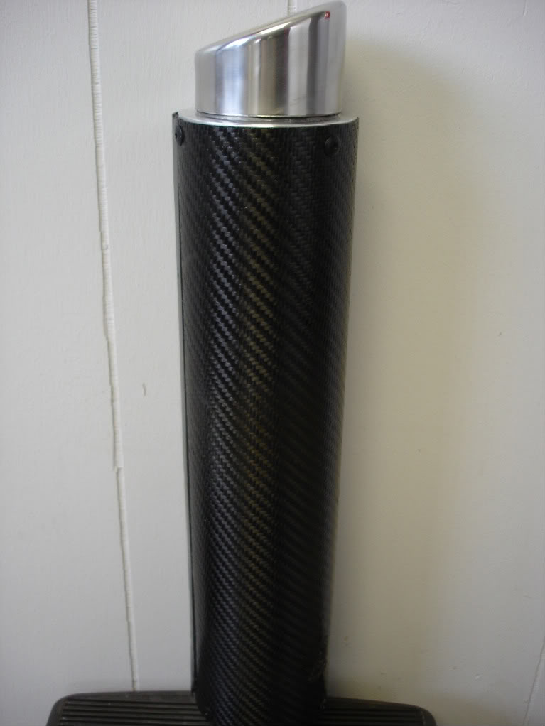

Exhaust can is packed and assembled, check that off of the list.

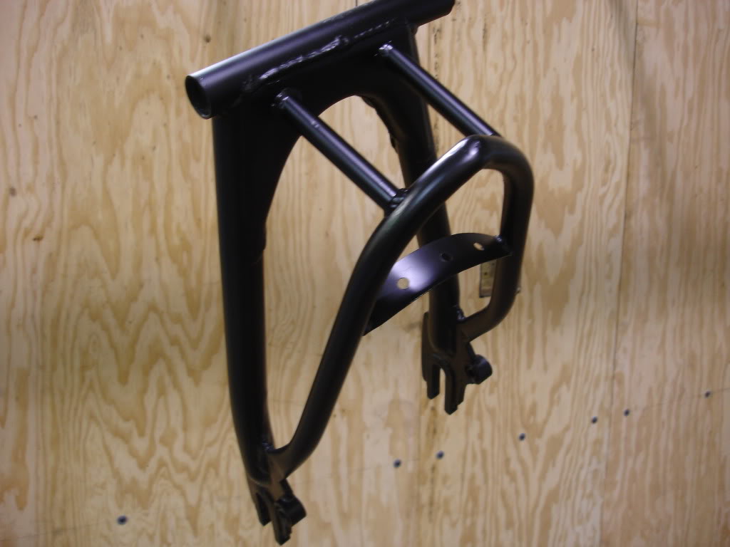

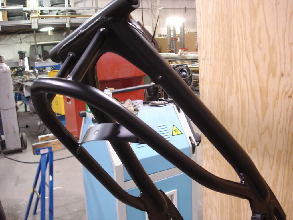

Disassembly begins
Started the tear down process. This could take a little while, a little a day though and it should get done. Maybe a month.

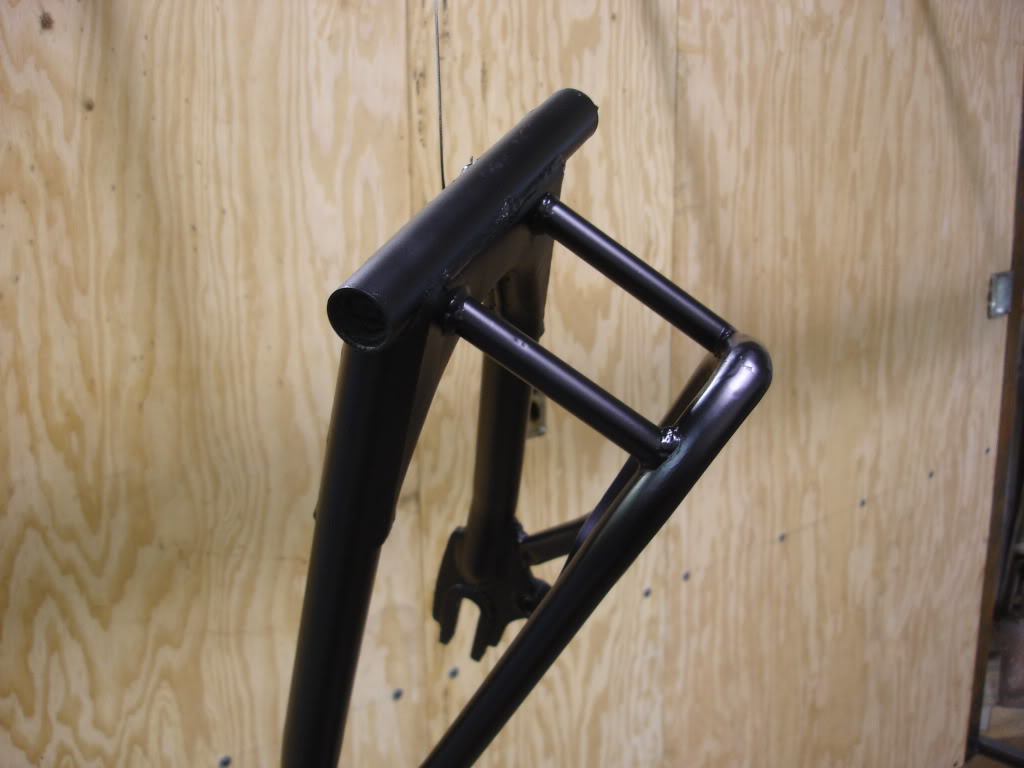

Took off the rear swing arm, the rear sets, a rear brake assembly
Then I welded the swing arm ground sandblasted and painted it.

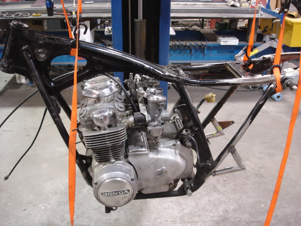

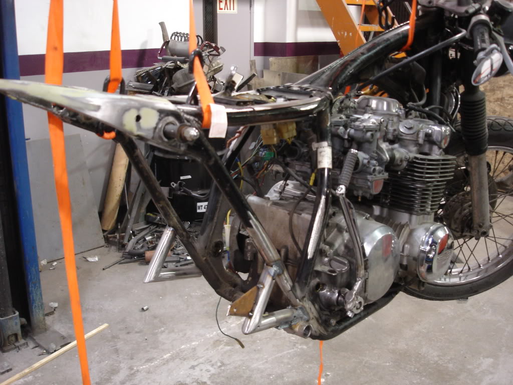

Front end is off, maybe later today the motor out.

So the motor is out, I am now working on cleaning the frame up, I need to finish the welding then sand and paint. I might be able to do all that tomorrow we will see.
Also I will take the motor to the main building so I can steam clean it, then I will remove parts to be polished and repair the leaking oil pan gasket.

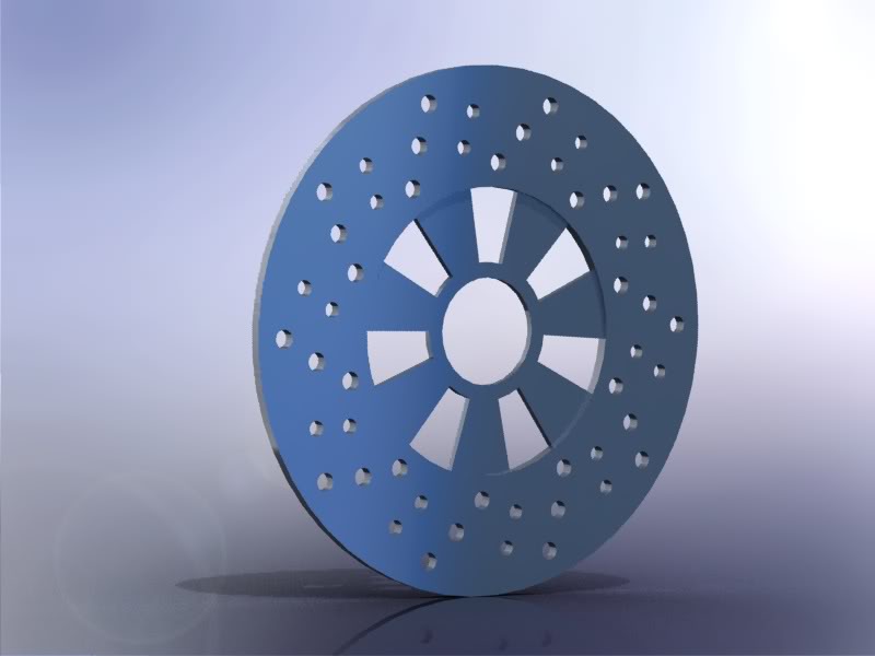

So here is the deal, I can drill the solid rotor and it reduces the weight from 5.6 pounds to about 4.9 pounds. Is the pound worth it?

Happy birthday! It would look good enough. What are the drawbacks?
Old Jan 13, 2010 | 02:03 PM
  #294
The drawbacks to drilled rotors are more wear on the pads... And more prone to warping if overheated... The positive (apart from weight) is better cooling... So I'd say it evens out, the only net gain being weight...

do you have a way to balance the rotor after being drilled ?
tim
happy birthday ...
Old Jan 13, 2010 | 03:49 PM
  #296
Little_Horse's Avatar
2nd mouse gets the cheese
Posts: 1,697
From: Beaverton, OR
tim
happy birthday ...
won't it all balance out as an entire entity once reconnected to the wheel?

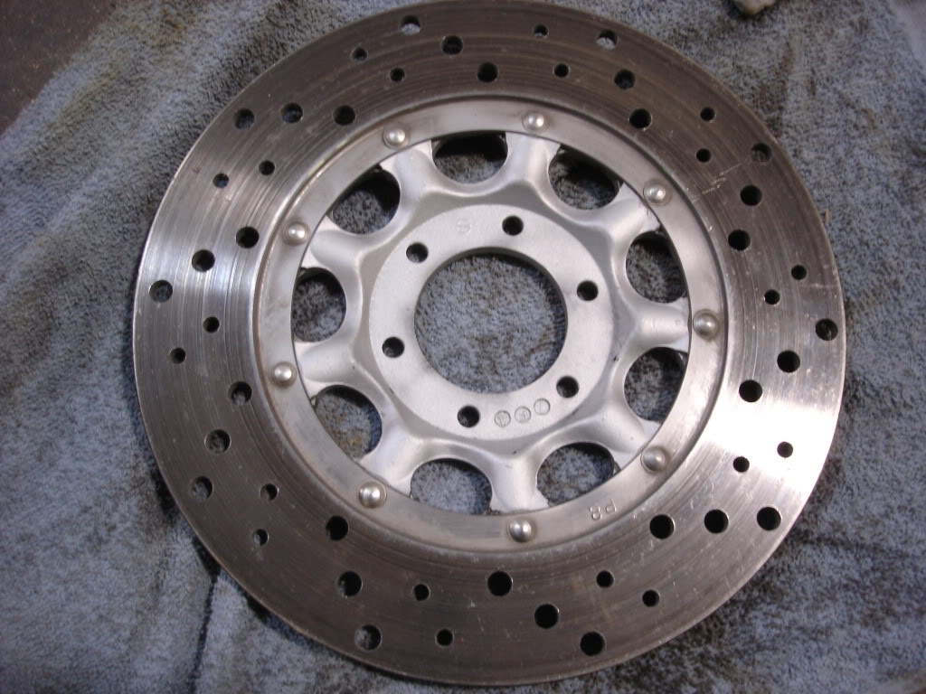

Hopefully my accuracy was good enough.

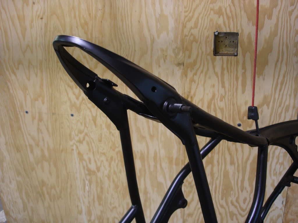

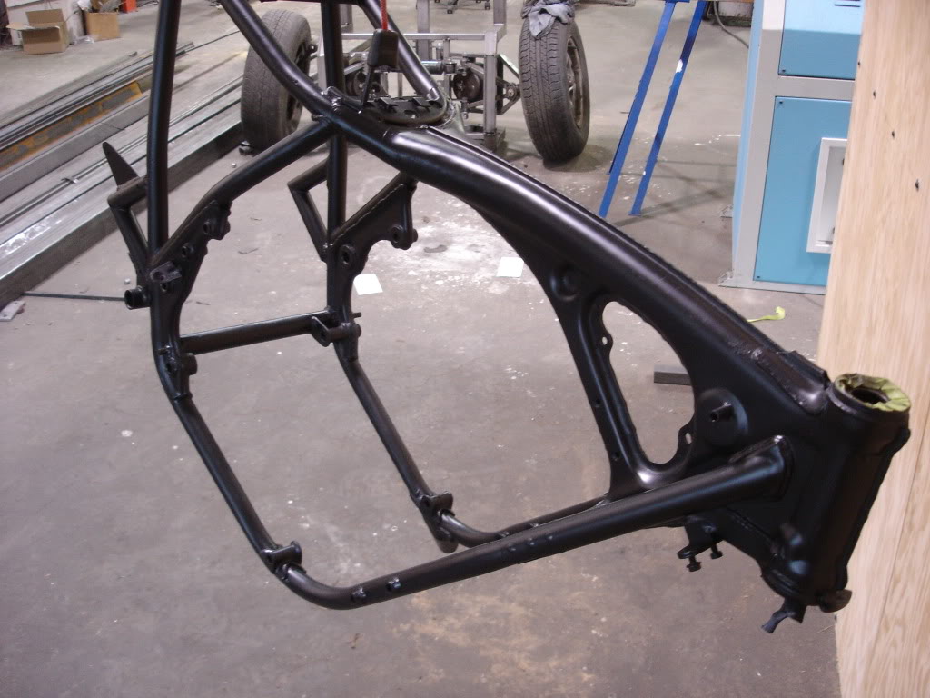

Frame is done

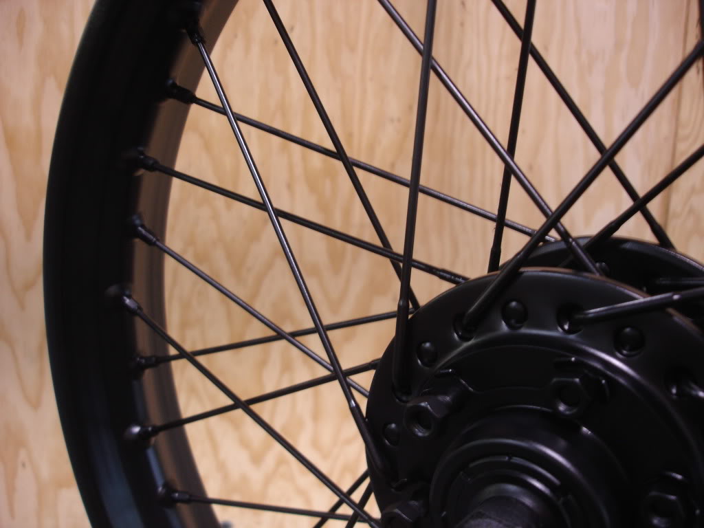

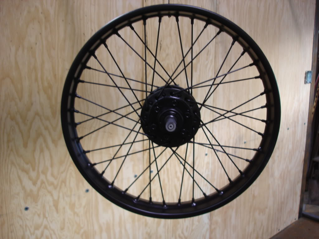

well I cut the bead off of the rim, (thanks Tim) and have now painted the rim black. Here are some shots.
