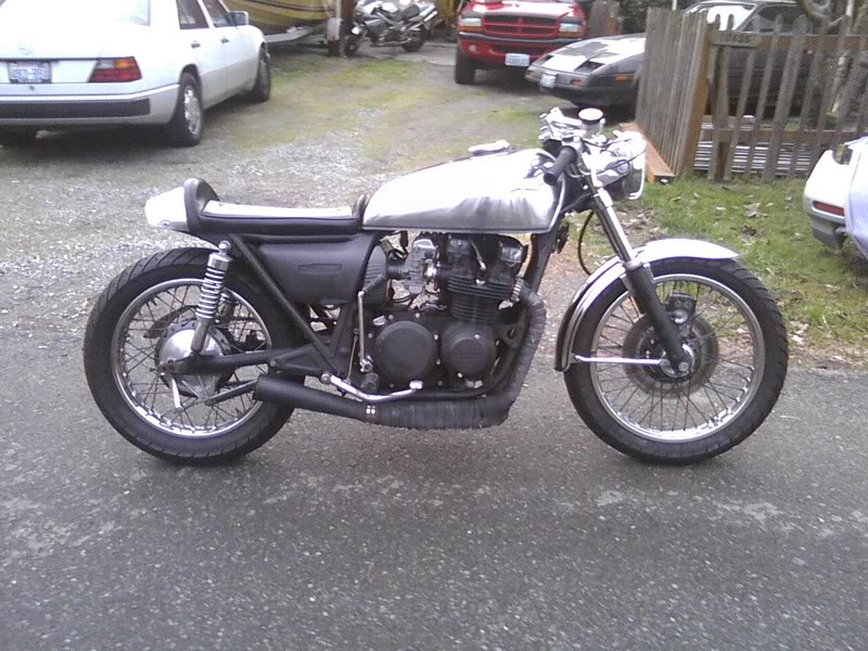

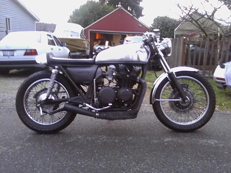

Here is a bike I built a few years ago that resides in seattle.
You can see the style of exhaust I like... Heh

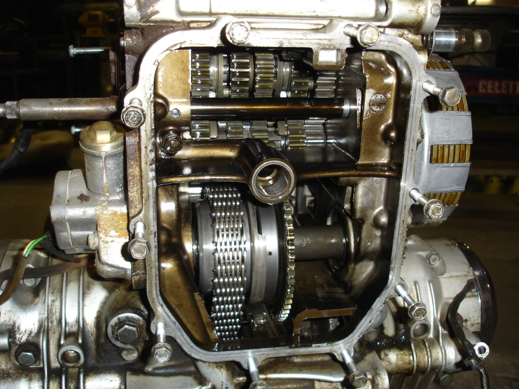

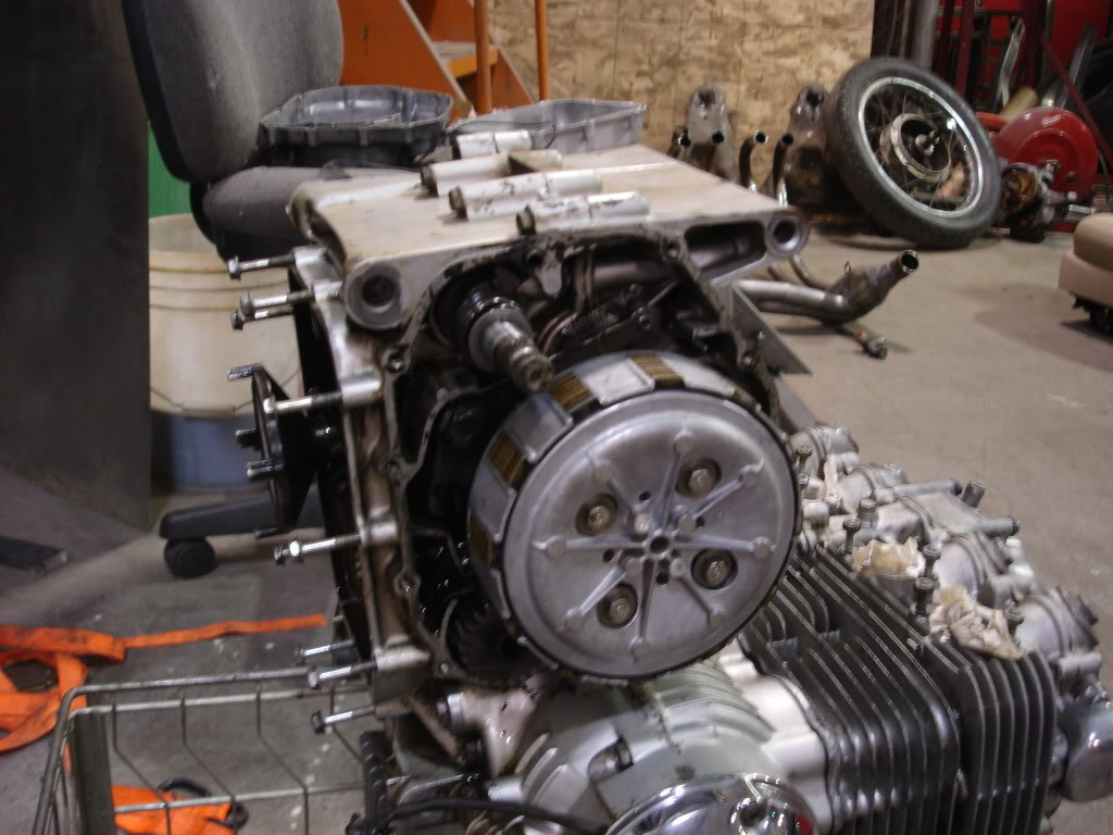

Engine work

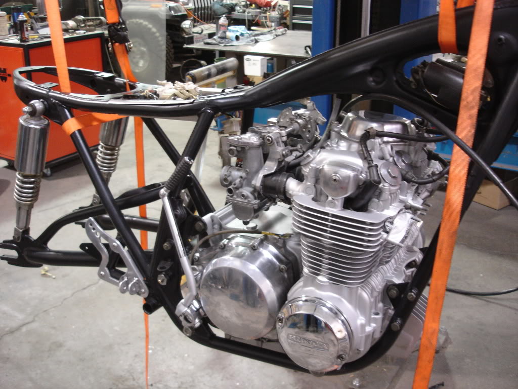

So I found the kick start seal is done so its back to the dealer. I have been taking off covers for cleaning and inspection. Here are some shots.

how did the bottom of the pan look ?
tim
tim
A thin layer of sludge, with some paper particles, like part of a paper gasket. Although truthfully the gasket for the clutch cover looked new and since the kick start seal was bad I have a feeling someone tried to replace the clutch cover gasket instead and was messy with getting the old one off. At any rate it looked like it had been sitting with the same oil in it for years.

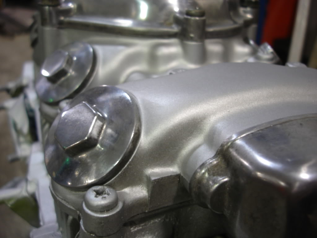

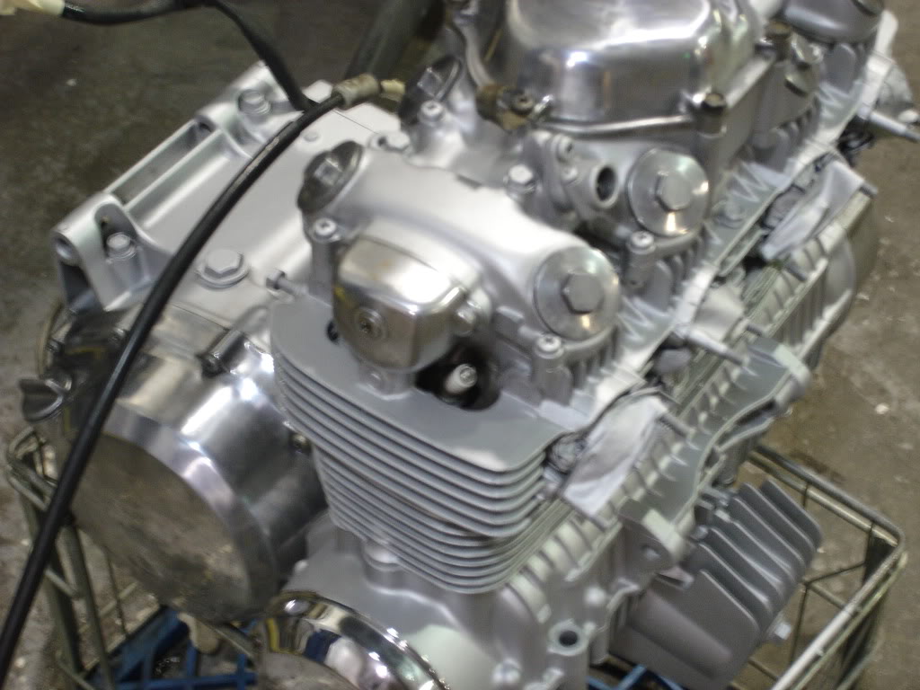

Engine painted!
Yep, its painted, and basically polished. I have the stator cover to polish then I need to hit all the shiny stuff with a good final metal polish and that is a wrap. The pictures say it all IMO.

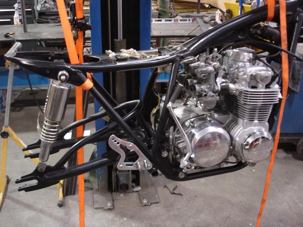

Here is the progress.

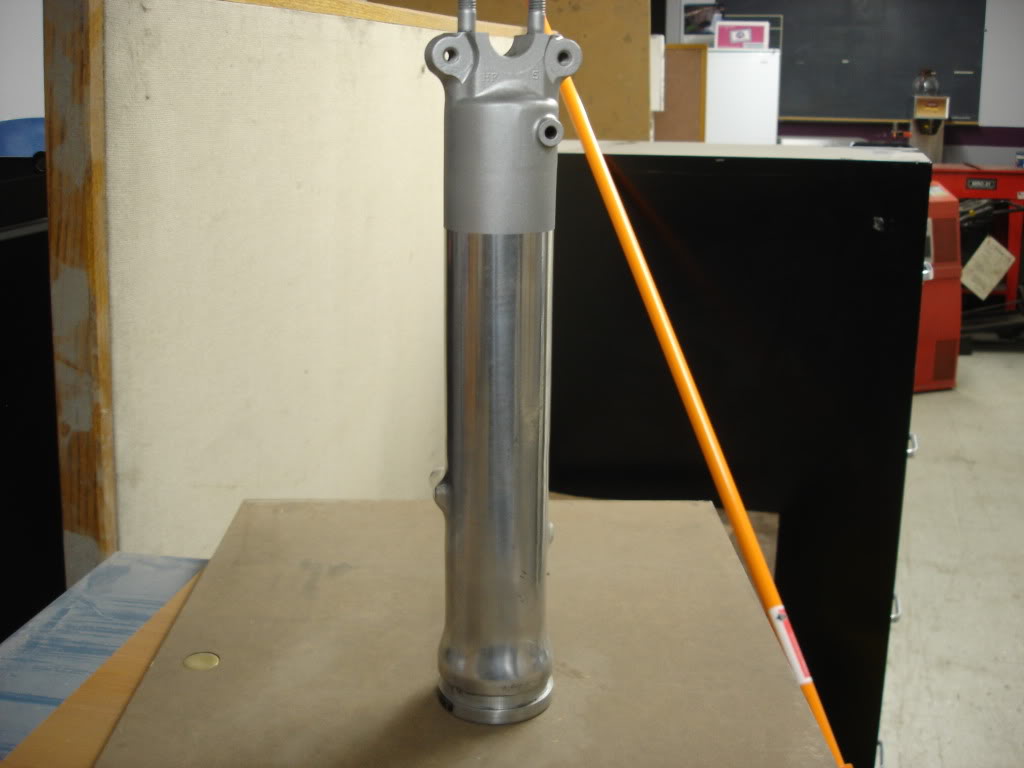

Started taking the forks apart, eyuck it was bad looking oil. Looked like it had separated. Anyways I polished the fork end and painted the tip. Heres what it looks like.

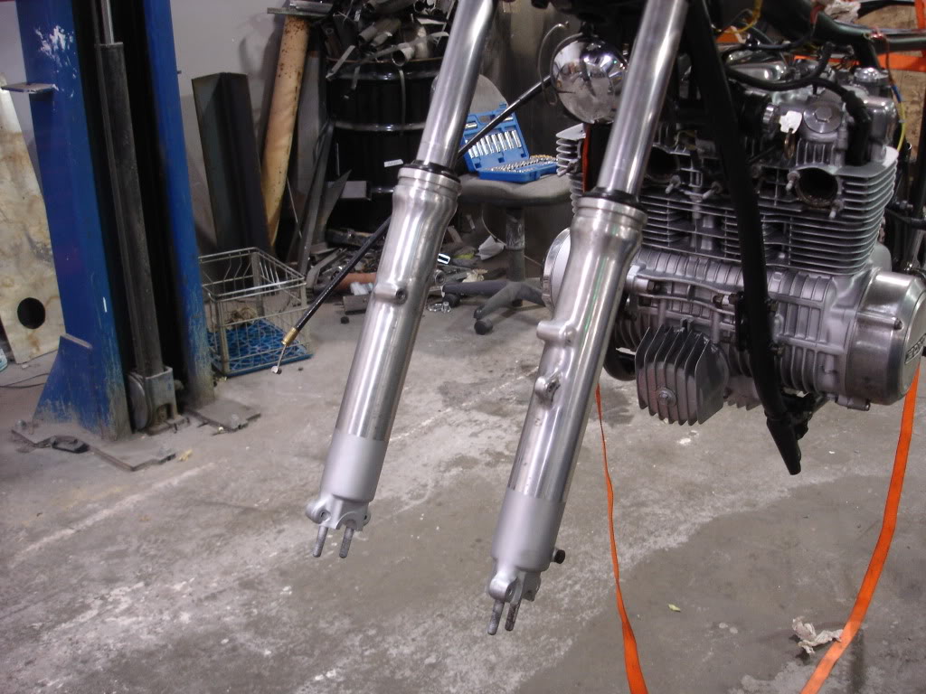

Well both forks have been serviced with new oil and seals. Later I will put the headlight brackets and clip on's on and its beginning to look like a motorcycle. Bring on the tires!

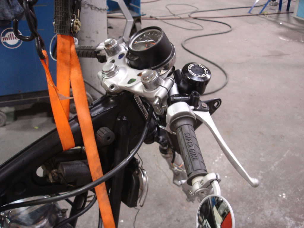

From: Beaverton, OR

Originally Posted by VTRumble
Where did you get the mirrors?
They where on ebay, pretty cheap like $20, the mirror assembly is great for the price, the mounting bits are cheap though. We shall see if they hold well. I have heard mixed reports. My work buddy has them on his hurricane and they seem to be fine were as hawkrider couldn't get them tight enough.

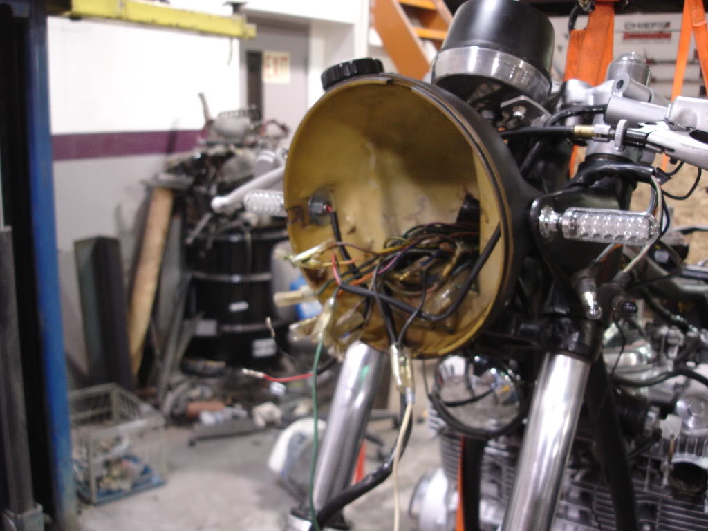

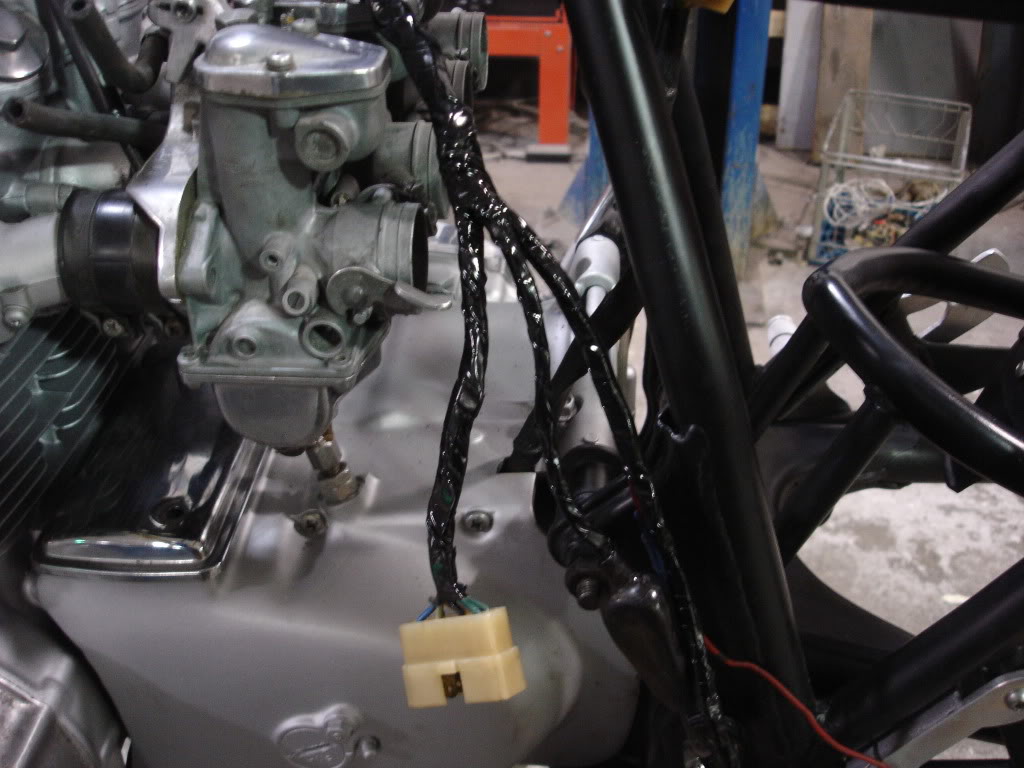

Electrical
Yep, gotta sort the electrical now. Its a little bit of a project considering I dropped a whole switch assembly that used to be the throttle assembly. See I shortened the throttle holder so it would fit on my bars, this got ride of the hi low headlight switch the kill switch and the starter button. So now I have to bypass all that stuff, so the headlight will skip the switch and the kill switch needs to be bypassed too.
I also am having to make battery hook ups since the battery is all the way in the cowl. So I made a new frame grounding point and new positive lead that will get hardwired into the original harness. The trick with everything is to not see it, still working on that but I don't think I should have trouble accomplishing that.
