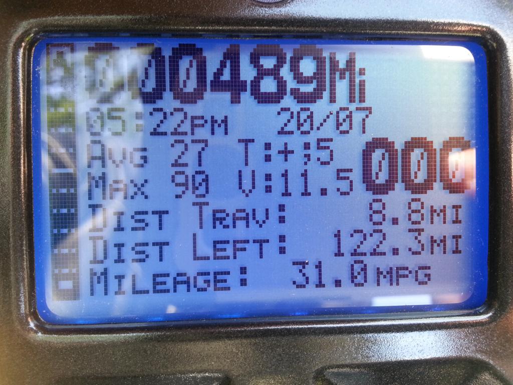

The other day I had a LOT of errands to do and luckily I could take the bike (was almost 3 tanks worth of fuel). I knew there was more power to be had with the Dr. Honda velocity stacks, but a recent post here made me think of what MPG you would get with these velocity stacks. You would think that with more power, your fuel consumption would go down. However with my carb setup, which is almost the 8541Hawk carb setup, I get ~27MPG with spirited driving. With the only change being the velocity stacks, I saw an increase of 4MPG. For an extra ~17 miles per tank (spritied driving remember) and extra power...I will spend the bucks on these aluminum velocity stacks anytime. And when I actually tune the dang carbs after the X-Wing thread, I want to see what MPG I get

Aw man...I'm currently getting 39 average MPG and it's running a tad lean. I'm about to do the Hawk carb setup...I'm hoping my fuel economy doesn't drop as low as you're getting.
Old Jul 22, 2014 | 02:11 AM
  #125
jerryh's Avatar
Posts: 972
Yeah Scott, Huge range here. If I completely whoop the bike its low 30's. Spirited low 40's and riding at speeds cars travel 48. This I get. I dont get the disparity from one bike to the next.
Old Jul 22, 2014 | 08:21 AM
  #126
ssscottyyy's Avatar
Joined: Apr 2014
Posts: 103
From: Williamsburg, Virginia
ssscottyyy is on a distinguished road
Oh nice, that is quite the range.
Old Jul 22, 2014 | 01:56 PM
  #127
SSSSSSSSScotty, I wouldn't worry about getting the same MPG's as me. I have a little different setup from the 'Hawk Tune'. It's based on it, but tweaked a bit.
Jerry, if you just putz along with your bike, you can get almost 200 miles to a tank? Wow, nice!
There are guys on here that have reported getting as low as 80 miles out of the tank before the RLOD (Red Light Of Death (a.k.a. Low Fuel Light) for you newbies reading this).
Speaking of which, FYI - I had to drain my tank not to long ago, so I took 'er for a good spirited ride to burn off some fuel to make the tank easier to drain, and the RLOD came on in my driveway just as I got back. When I drained the tank, there was .7 of a gallon left. So, that is the Superhawk's reserve.

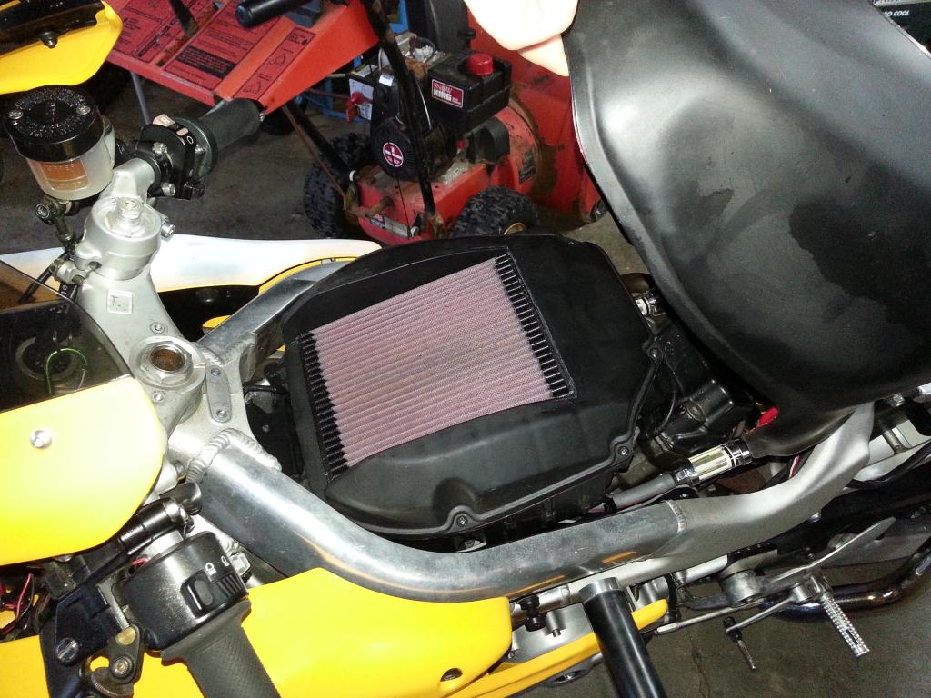

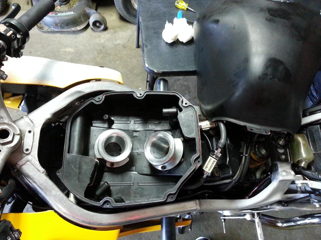

I haven't updated this in a while. Since the last post, I got an awesome exhaust from a local forum member. Thanks again man! High mount Jardine RT-1 in black. Very light compared to the stockers. I would say that this whole exhaust weighs the same or less than one stock muffler.
I also got the urge to try out my F.I.L. mod. It's just been sitting around, so why not? It's running very lean at the moment and I'm working on the carbs to get it sorted. I'm installing (DJ) 190F & 195R main jets and have ordered 52 pilots, since the 50's I'm using aren't enough.
I'll get better pictures at a later time.

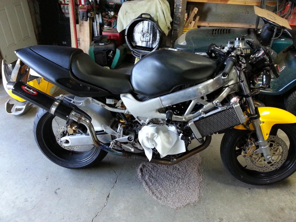

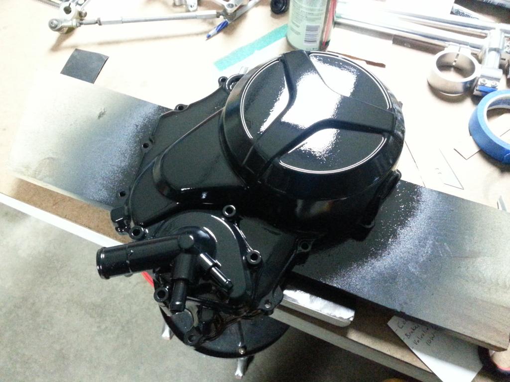

Bike has been making a metal on metal "ticking" noise that has been getting worse. Click that link and see what was making the noise!
I had to replace the clutch, since it has been on it's way out. I popped the engine cover off and found that the clutch kit that I purchased was the wrong clutch! So, while waiting for my new, correct clutch to arrive, my engine cover will be off for a little while longer. I figured I would remove the Sub Gear while inside the engine.
I have the fairing off and I can't ride my bike for at least another week, so I'm going to finally paint it! Perfect weather for it this coming week too. I'm just making a little spray booth inside my garage with plastic hanging from the cieling. This is how she looks right now. You can see the fairing laying off to the left.

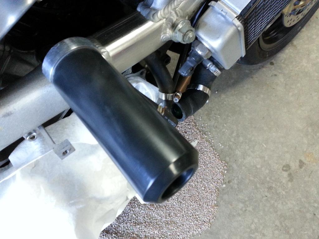

I got a set of used frame sliders that had some sun damage and were just a little used looking. I used a scotch brite pad and scuffed them up, then used a torch and melted the plastic slightly. Made them look almost brand new! The picture is out of focus, but it looks a lot better than it seems in the picture.
Also repainting my engine cover. Not sure which color(s) yet. Idea's?

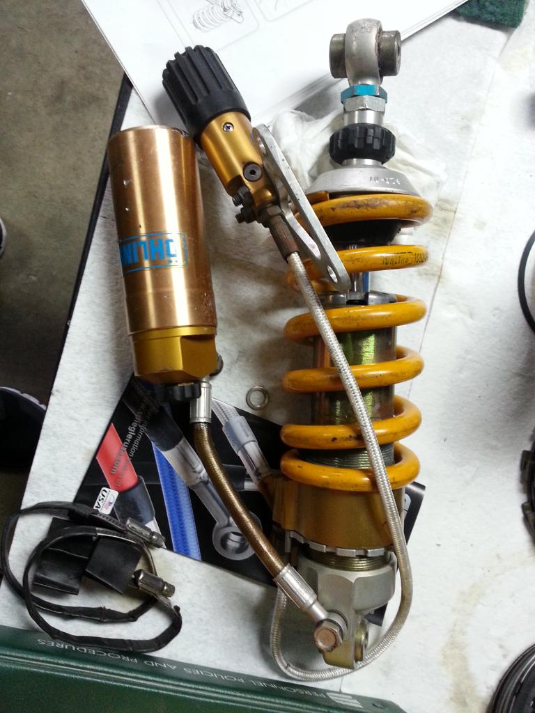

While the bike has been down, I decided to do some shopping. I got the parts to weld aluminum with my Lincoln Electric MIG welder. Why? Because I have always wanted to weld aluminum, but don't have the cash to drop on a nice TIG. Also, because last night I scored:
Superhawk swingarm $28
'95 CBR900RR swingarm $20
'96 (same part # as '95) CBR900RR rear brake bracket $16
Great prices, except for the bracket. Couldn't get the guy down on price.
So, I'm doing a braced swingarm. And since I can weld aluminum now, I'll be fabricating an aluminum sub frame and an aluminum fairing stay. That should get the weight down some.
Since I will have an extra swingarm, this will help me figure out what I need to make my custom wheels fit, without having to remove the rear wheel from the swingarm on the bike and having the bike down.
I have not installed the '07 CBR1000RR front end yet, so this seems like a great time to do so. Why? Because I just purchased an Ohlins rear shock (HO-701). This bike will be SO different with the better shock/forks and braced swingarm.
EDIT: Oh yeah, I took the engine cover off of my extra engine and found that it has a Factory Pro +4 Ignition Advancer. Score!
Kind of a bad picture of the Ohlins shock, but a picture none the less.

This shock rocks! Compression and rebound dampening, external oil reservoir, external spring preload adjuster. Really neat shock.
I bought it for a fantastic price. Was told the spring preload adjuster was broken. Turns out, the thing works on oil pressure and there was no oil inside the line. Filled it up and she works fantastic! Just needs a simple O-Ring. Before the shock is installed into my Superhawk, it's getting rebuilt and gone through.

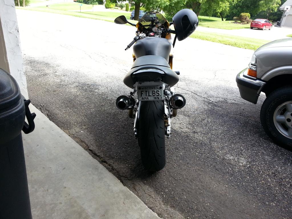

Old Oct 15, 2014 | 08:57 AM
  #143
Originally Posted by CruxGNZ
I figured out how to post pictures with my iPad! lets see if this works. This is how the bike looks as of two days ago.

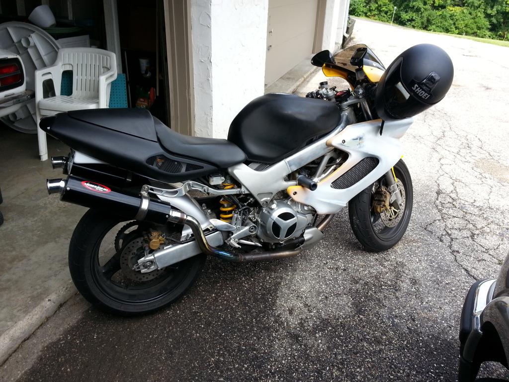

Finally, time for an update with pictures!
As you can see, I got some yellow fairings, because the red set I had were just to far gone. On these yellow ones, only the right side needed some plastic repair with my trusty plastic welder. As long as I was fixing the plastic, I filled in the turn signal holes, since the new mirrors had integrated LED turn signals.
I need to buy some Isopon to fill the small scratches, then prime and paint when it gets a little warmer here.
The exhaust from the TL1000 was scrapped when I found a set of almost unused stock Superhawk cans for $20 off Craigslist. I'm debating on painting the cans flat black or not and wrapping the pipes in black exhaust wrap.
I also did a full baflectomy. Sounds great! But I want it louder, but not as loud as it was when it had NO mufflers.
The silver hugger is from a Triumph Daytona. It was free, so after a couple mods, it fits great!
The undertail took some time to make it fit correctly. Several passes with a cutting tool on the Dremel, and using a heat gun made it fit rather well. I'll take a couple pictures of how it was mounted.

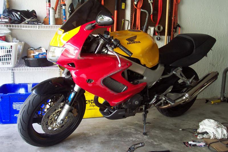

Been searching for his picture...this was a '99 project I built a little while back (obviously unfinished here). It's funny how they all look alike at this stage...
Haha, yeah they sure do. I rode it around like that for a little while too!

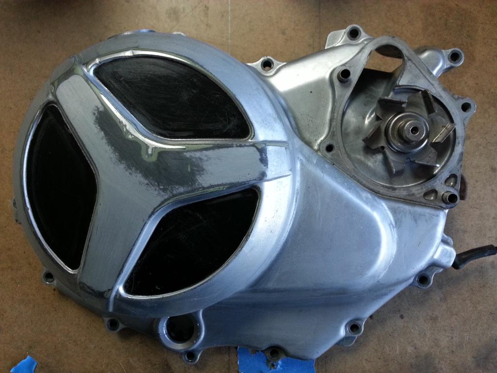

I was removing the HONDA from the engine cover on the Materium project, and I absolutey love the way it came out painted all black. So, it is now on my Superhawk. Here it is with the clear drying, which is Dupli-Color 500 degree ceramic spray bomb stuff.
