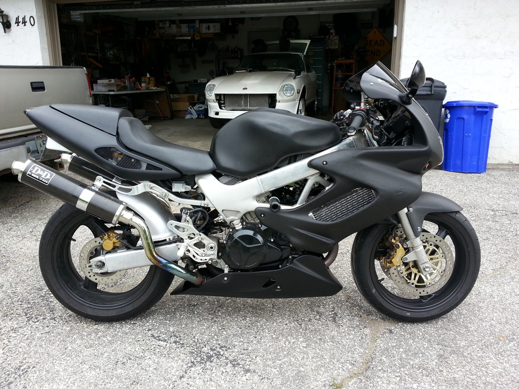

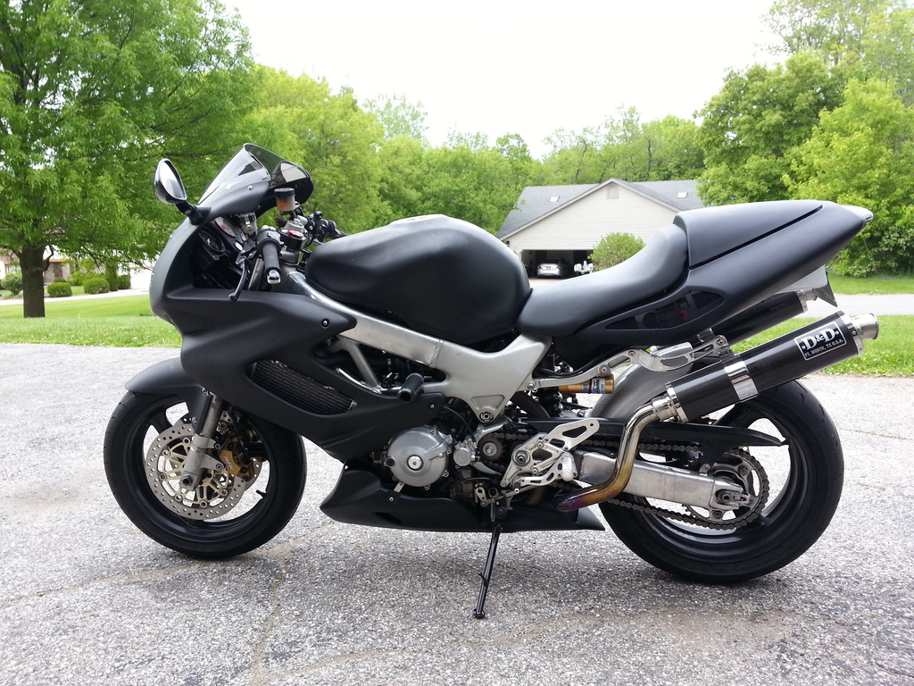

Thanks to our awesome forum member taskmasta, I now have a new belly pan! A little work and some new primer, and viola! A perfect belly pan. I have wanted one this style for a long time. I think the bike now looks fantastic. Now onto the front end swap.

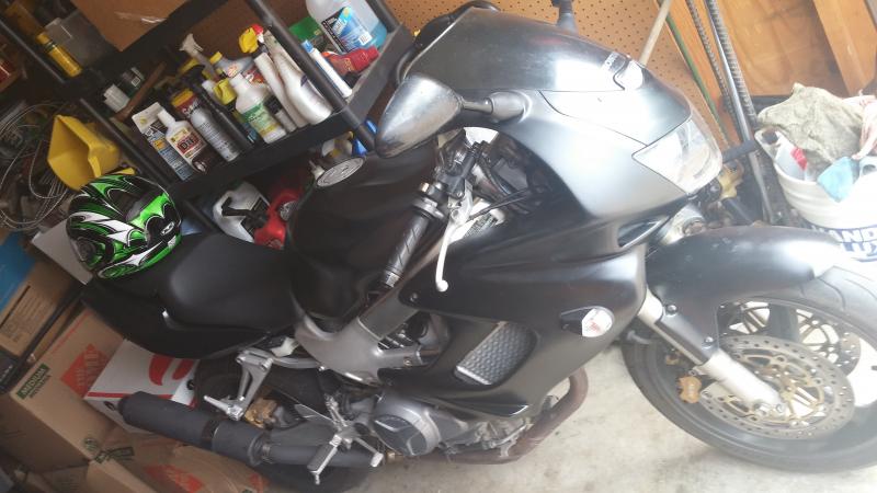

Looks like mine did before i took my fairings off. Same exhaust even....Till my xg1 shows up!
Your neighbors are gonna love you

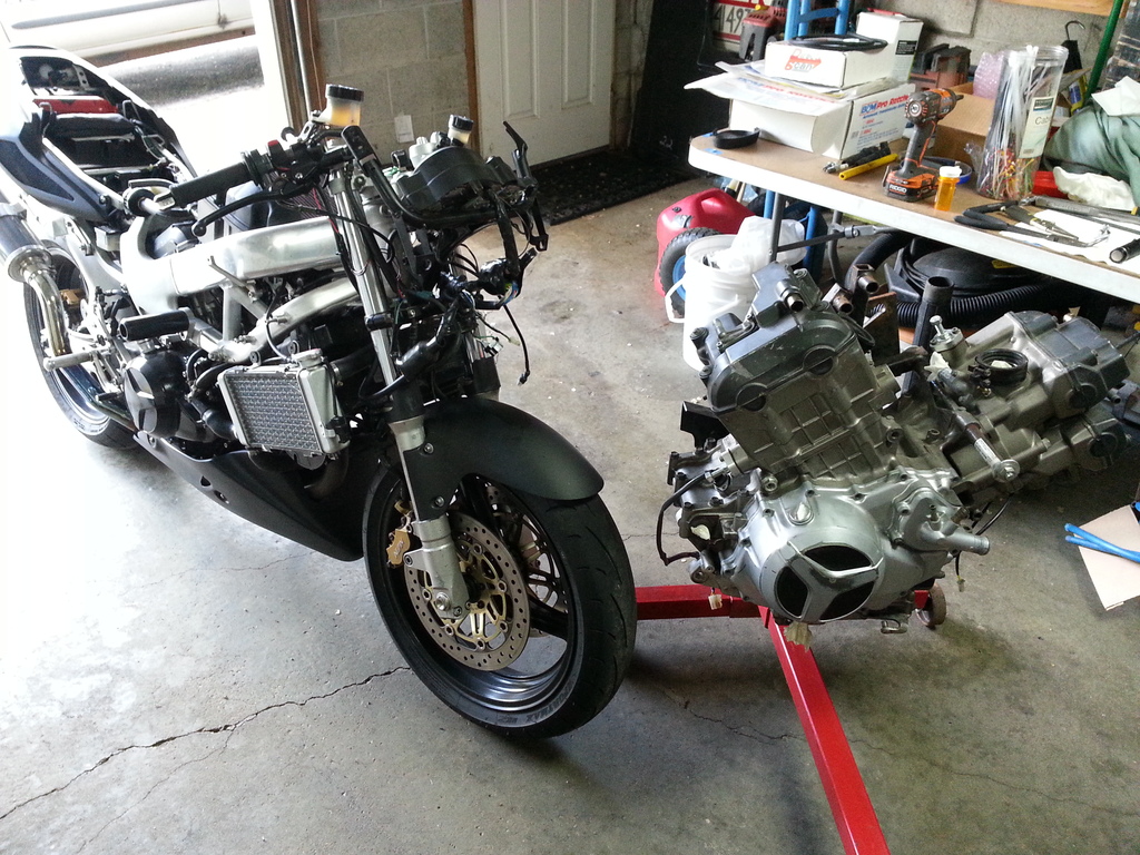

I'll try to make this short.
Took the bike apart. Fairings, gas tank, valve covers, all off. While I was setting the front cylinder at TDC, there is an audible "clunk", not only the front cylinder but the back as well. I can only surmise that it is the wrist pins. Yeah, plural. I can rotate the engine back and forth and it clunks from both cylinders near the head. This causes a ticking while running? Apparently.
I have done several MCCT installs on our fantastic SC36 and have NEVER heard this type of noise when turning the engine over by hand.
I am infuriated. This is the start of our short riding season. Now I have to do a M'r F'n engine swap. On the bright side, I already have the bike torn down.
This sucks. I'm done for the day.

I have a spare engine sitting on a stand ten feet from my bike
This engine was for my Materium project. But, if this engine gets me back on the road, so be it.
The original plan was to take the spare engine, split the cases, install the 11.5 pistons, Webcams, ported heads, and then swap engines into my bike and take the engine from my bike and put it into the Materium project. But that's not happening now. At least, not the way I planned it.

Plan is as follows.
The bike is going to stay down for the time being. My 240GNZ is down as well at the moment. I am working on it to hopefully make the Hot Rod Power Tour on the 6th of next month in Madison, WI. So, I'm going to finish the Z first.
Once the Power Tour is over, work on the bike begins. Since the second engine is out of the bike, it's a lot easier to work on it. I'll be installing the 11.5 JE pistons, Webcams, and ported heads. Then swapping in that engine. Kind of sucks not riding, but it will be worth the wait.
