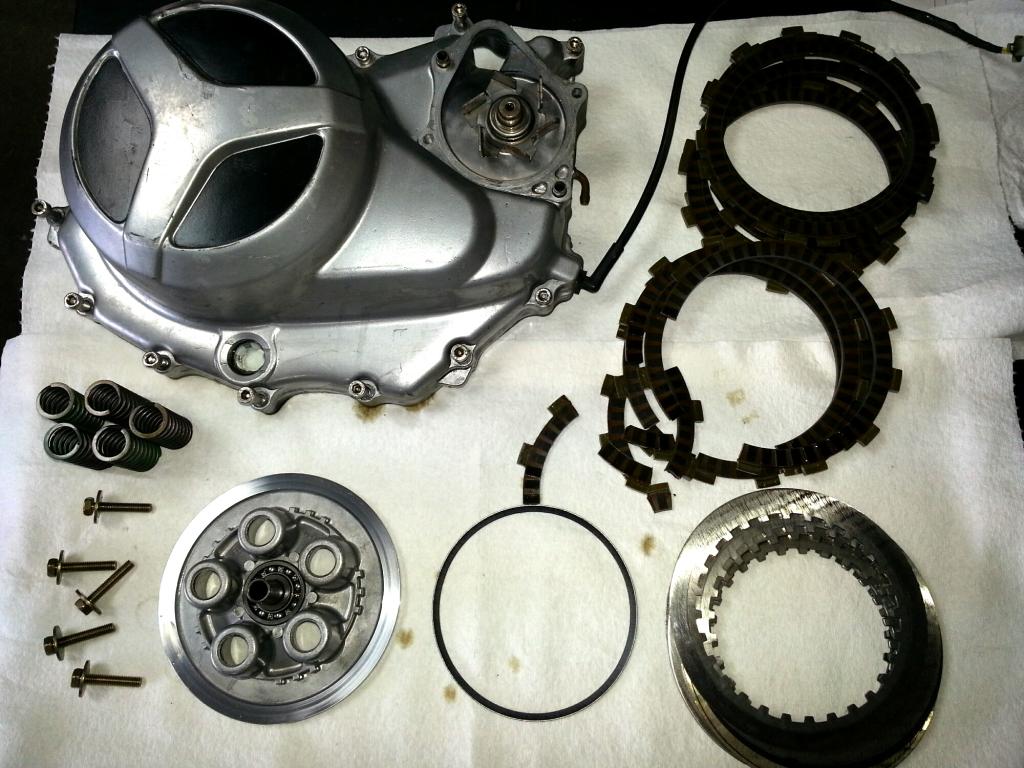

Okay, this is new to me. What the hell causes this in the picture below? Not only that, but could this be the cause of my noise? Five friction discs are broken in several pieces!
This is the clutch that came with the bike. From the melted rubber on the rear tire that came with the bike, I can only assume the P.O. didn't treat the bike like an adult. Did the P.O. do this and I have just been living with it? I sure hope so.

Old Sep 20, 2014 | 02:41 PM
thetophatflash's Avatar
Posts: 834
From: Nooksack WA
Yup! That'd make a noise. lol
Old Sep 20, 2014 | 03:06 PM
Seriously? The clutch discs destroying themselves would make a metal on metal "ticking" noise?
The clutch discs were at thier wear limit. The plates were all below thier wear limit.
One thing that is bothering me, when I pulled all the parts out, I do not have a spring seat. I have the judder spring, but no spring seat. Will this be a problem?

Old Sep 20, 2014 | 08:20 PM
NZSpokes's Avatar
Joined: Apr 2014
Posts: 932
From: Auckland, new Zealand
Yup, that will be your noise. Good time to order a slipper?

Old Sep 21, 2014 | 09:55 AM
Originally Posted by NZSpokes
Ive been told a CBR slipper will go in and a local Honda dealers head mechanic has a storm with one in. Not had a chance to get details yet.
I remember seeing Smokin' Joe post some information about a Honda CBR900 clutch (mentioned it might be cheaper as well) that also installs into the Superhawk/Firestorm. He didn't post the year though.
If a CBR900 clutch fits, perhaps the CBR900 slipper clutch would install as well?
Whenever you get details, make a new thread! I know several people that would love to have this information.

This "ticking" noise was there since day one when I assembled the bike. Having never owned a VTR before, I just thought it was one of those noises that this bike made. I felt that the clutch needed to be replaced from the first time I rode it. I had just put the thing together, so I waited on replacing the clutch. Man do I wish I didn't let that go. It made me cringe when I saw the mess on the bottom of my oil pan.
I had a good look at the edges of the pieces of clutch plates. You can clearly see the pieces were knocking, bumping, grinding into each other. This HAD to be the noise. Can't wait to fire it up and not hear that noise anymore.
