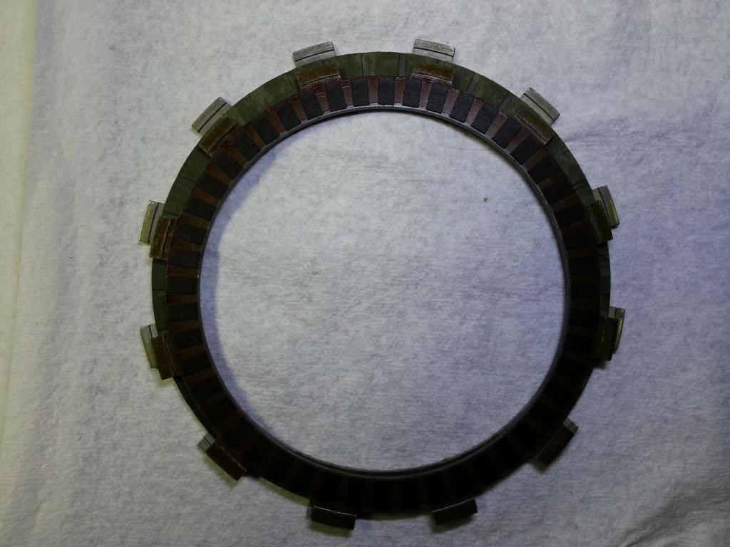

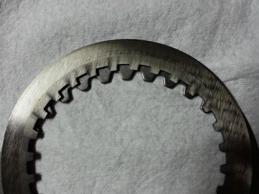

Here's the two clutch plates. Superhawk on top. Quite different, wouldn't you say?
Clutch discs.
These simply will not fit without serious modification. Or, am I missing something?

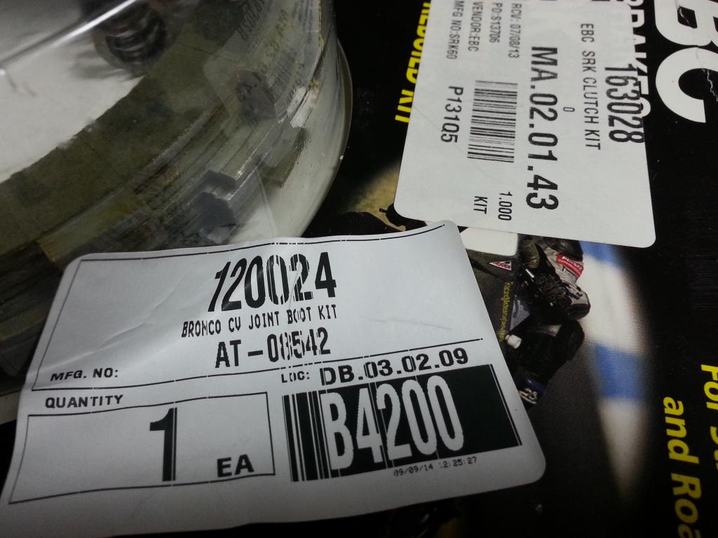

Here's the kit with part #. Now, searching the internet, the part number looks to be correct. However, some part numbers have an "-AD" after the part #.
And if you look closely, there is also a part number for a Bronco CV JOINT BOOT KIT. Yeah...

Odd, yes shows to me as being the correct part number.

EBC VTR1000F Superhawk Street Clutch Kit CK1290
2014-us-mc-catalog
Though does have SRK60 as an upgrade to it - which matches what you've been sent ?
Could it be a counterfit Chinese rip-off? Email EBC US with the codes on what you've got and see what they say.

The numbers on the package are correct to the vtr so I wouldn't blame the seller. I'd contact EBC like stated above.
