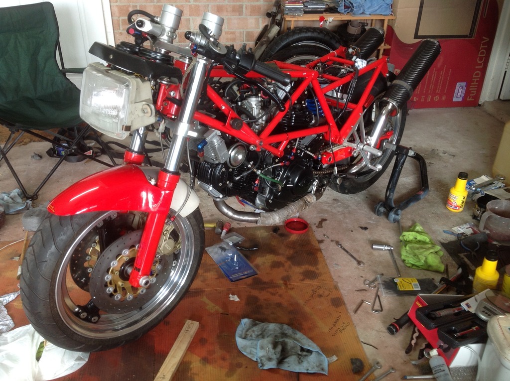

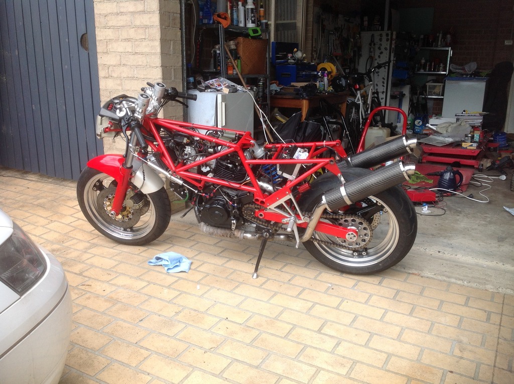

Old Nov 26, 2016 | 04:29 PM
  #425
Here ya go Crux,
Almost finished.
Just about finished, bit more wiring, oil and filter, carb sync, adjust all controls, and a recheck of all work done.
