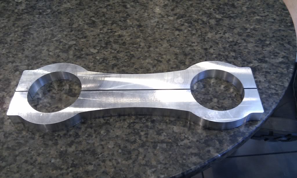

Alright guys, so there was some hitches along the line in terms of getting some more materials and we've had to fidget some stuff around in terms of various radius' and whatnot......
BUT.......
These are hot off the presses and everything is looking pretty good.
They are going to be going on tomorrow when I'm at the shop (provided I can find some fasteners =p) so hopefully I'll have some pictures to take.
I'm also going to have the screw holes counterbored a little bit deeper, it seems there was a slight communication... but nonetheless, the CAM software is completely programmed and ready for requests.
There are 2 or 3 people (I'll need to double check my PM's) who have already put their name on a trial piece (I'll go ahead and PM those who "raised their hand" to let you know when I'll have some to send out)
Now that there is actually something to look at, if the people who are truly interested in having one of these braces please alert me, the more aluminium I buy the cheaper it will be for everyone.
Once again, as an update on the rear-sets, I haven't been able to make much movement on them but I am working just as quickly as I can and putting all the time I can dedicate to it.
And if someone wants to take some measurements for any other front ends that people would like a brace on, email me and I can get you a sheet to fill out so that I can get some in the works (and there will be a 10% off incentive to do so for any design that I don't have).
Right now I've got designs for an 86' GSXR 750, '84 VF1000F and a '79 CBX. If someone wants to send info over on the larger fork set-ups for our Superhawk or any bikes that you've got in the garage that you want fork braces for, let me know.
Once again,
thank you for being patient guys,
-Jarrod

Okay guys, haven't gotten any responses but here are some pictures of it on the bike.
(sorry about the picture quality, it's my phone)
The only thing I can emphasize here is that when you install this, it is imperative that you re-align your brakes.
My bike was dropped by PO and the forks were tweaked a little bit and I adjusted the brakes accordingly, however, when I installed the brace, my left caliper was dragging a little bit. A little bit of fiddling (loosening caliper bolts and loosening axle pinch bolts, relieving pressure from the pads and rocking the bike back and forth while grabbing the brakes straightened it out) and now everything is straight and true.
First impressions were that steering was a hair heavier (almost unnoticeable- most likely was the brakes), but in line stability and high lean angle turns were monumentally improved. Where my front would usually walk out in turns, I now am glued to the road and the bike is solidly planted in the front. I'll note on tire wear later (I've got some pilot pures en route as we speak). I haven't had a chance to take it up in the twisties yet because the weather here is kinda dreary and as you can see from the gutter, there are leaves galore, which would only be compounded in the mountains.
My bike was dropped by PO and the forks were tweaked a little bit and I adjusted the brakes accordingly, however, when I installed the brace, my left caliper was dragging a little bit. A little bit of fiddling (loosening caliper bolts and loosening axle pinch bolts, relieving pressure from the pads and rocking the bike back and forth while grabbing the brakes straightened it out) and now everything is straight and true.......
Judging by your front fender I'd say you still have some other fork issues to sort out.
