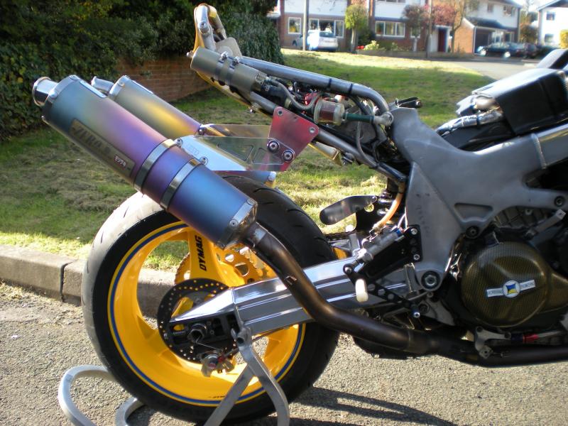

The part I've been dreaming about making is a weld on frame brace to connect to the swingarm pivot bolt, and incorporate the rearset bracket onto it also.
Maybe a little too involved for what your friend is doing...I can dream
I know someone with a mill, and another friend owns a business and has a CNC mill and lathe, maybe someday I can figure it out
that sounds like it would get very complicated very quickly. your dealing with geometry at that point. would be awesome though
I think this would be a little advanced for the class he's taking because it would require quite a bit of geometry work to make it fit. Now I'm not adverse to it because I would love to have everything on the SH a little more reinforced.

Well, I think the idea is from the MORIWAKI race bike...
The piece doesn't look too bad to design, and would be much easier to cast than CNC.
My concern would be how thick to make the plate in order to accommodate the strength necessary to gain any benefits of having such a rigid rear end.
Another concern would be how many people would want such an aggressive riding position for say street riding.
I think it would be pretty easy to make one with a wing on it that you could drill into yourself, it would allow you to even branch out into other manufacturers rearsets..........Another concern would be how many people would want such an aggressive riding position for say street riding.
It wouldn't need quite that aggressive of a riding position, maybe leave it up to the end user to place/fab the footpeg bracket where they like it best.

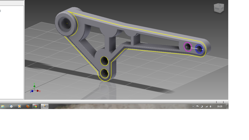

As of right now, I've got a really rough down and dirty AUTOCAD of an adjustable shift lever that could be incorporated into the design, it is essentially something similar to Jamies CNC but skeleton, and it will match the rearsets.
Right now I'm designing this to be a solid mount peg set up, so I hope if anyone cares they chime in.... now.
Because I've got 90% of the measurements (Thanks Mike!!!) and I'm gonna start making the design for the rearsets.

The main benefits of the flip up is being able to save parts in case of a crash and to prevent the bike from hopping when catching on various road surfaces when on it's side.
As well if you do scrape the pegs mid turn, it will give a little and not upset you.
Benefits of a rigid peg is less slop in actuating movement of both levers. Not all that much, but noticeable. Either way they're going to have sealed bearings on all moving parts so it's going to be smooth and precise
And just as a teaser.... and this is by ALL means NOT a finished product. Just an idea. Name:  Shifter.png
I'm reworking the "skeleton" aspect of it because I don't like how it looks.
Structural integrity is being tested tomorrow on a faster computer
