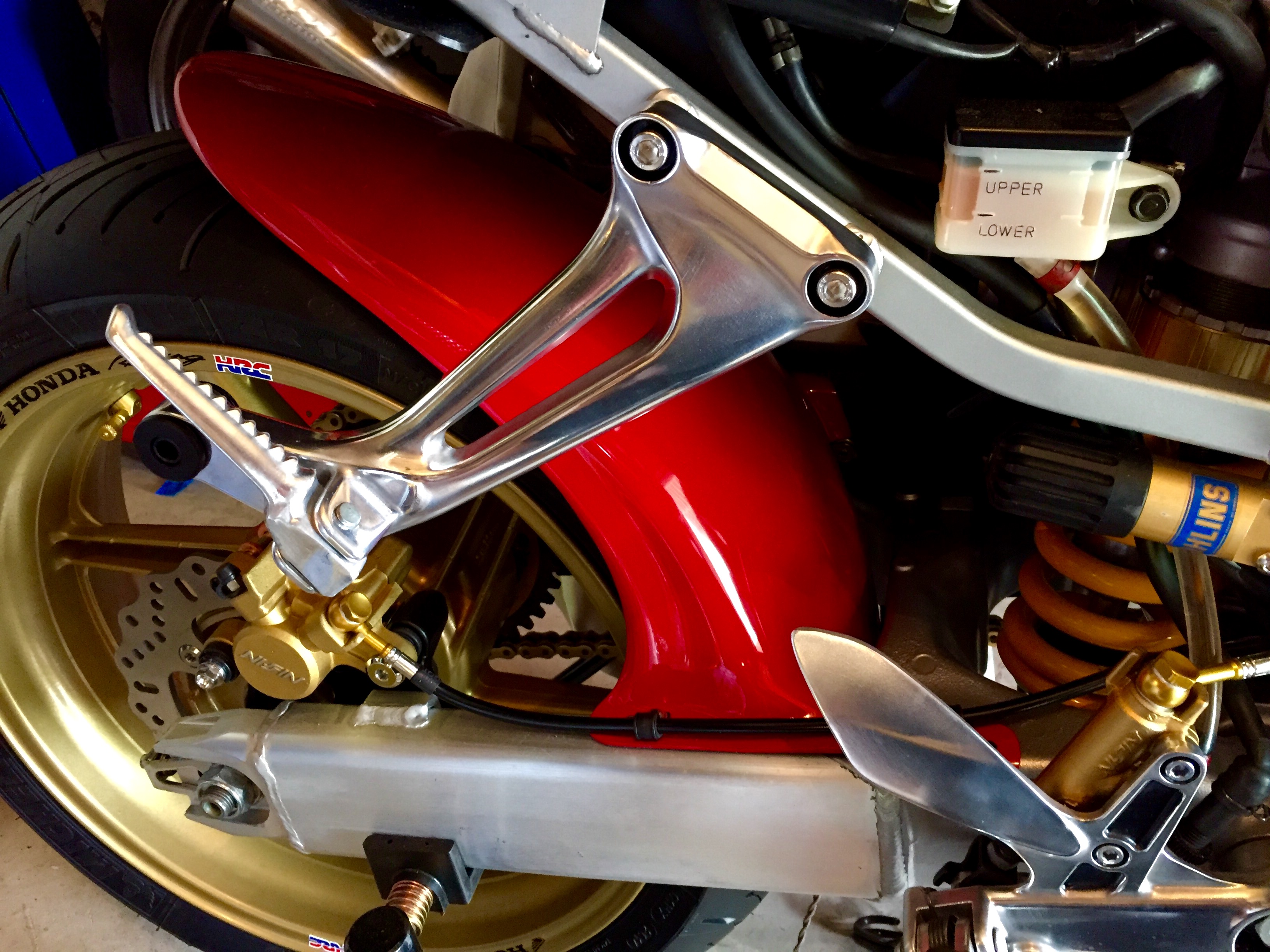

Got around to refurbishing my passenger peg assemblies I bought from Crux! Both done now and mounted! Happy, happy, joy, joy!

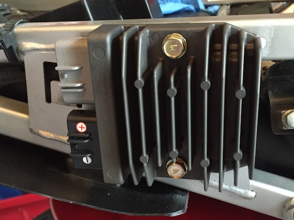

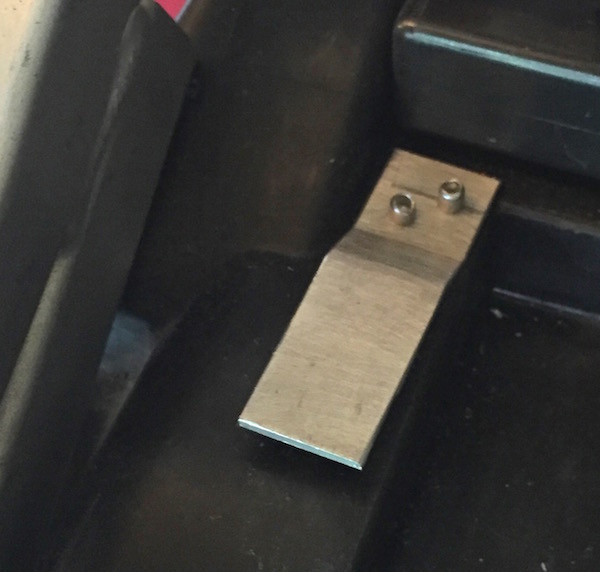

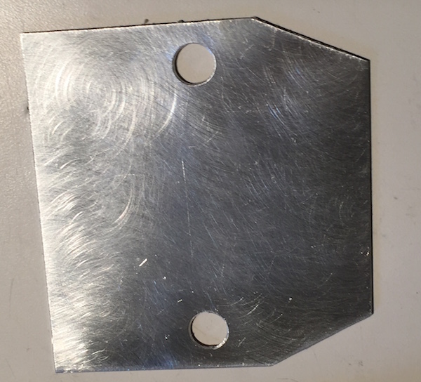

Started working on my R/R mod, I'm relocating the turn signal flasher, in the process. Nutserts have been placed, the bulbous weld ground down so the new R/R sits flat, and made a flat aluminum plate to keep the torsional stress off the R/R when being fastened down, plus help further with the heat sink capability ... Now on to the wiring!

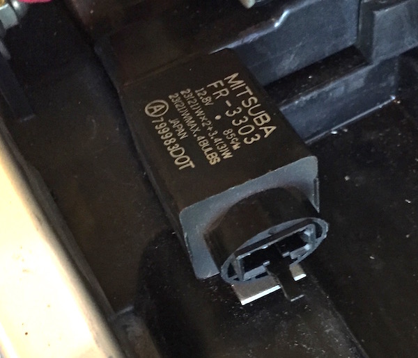

Turn Signal relocation complete!

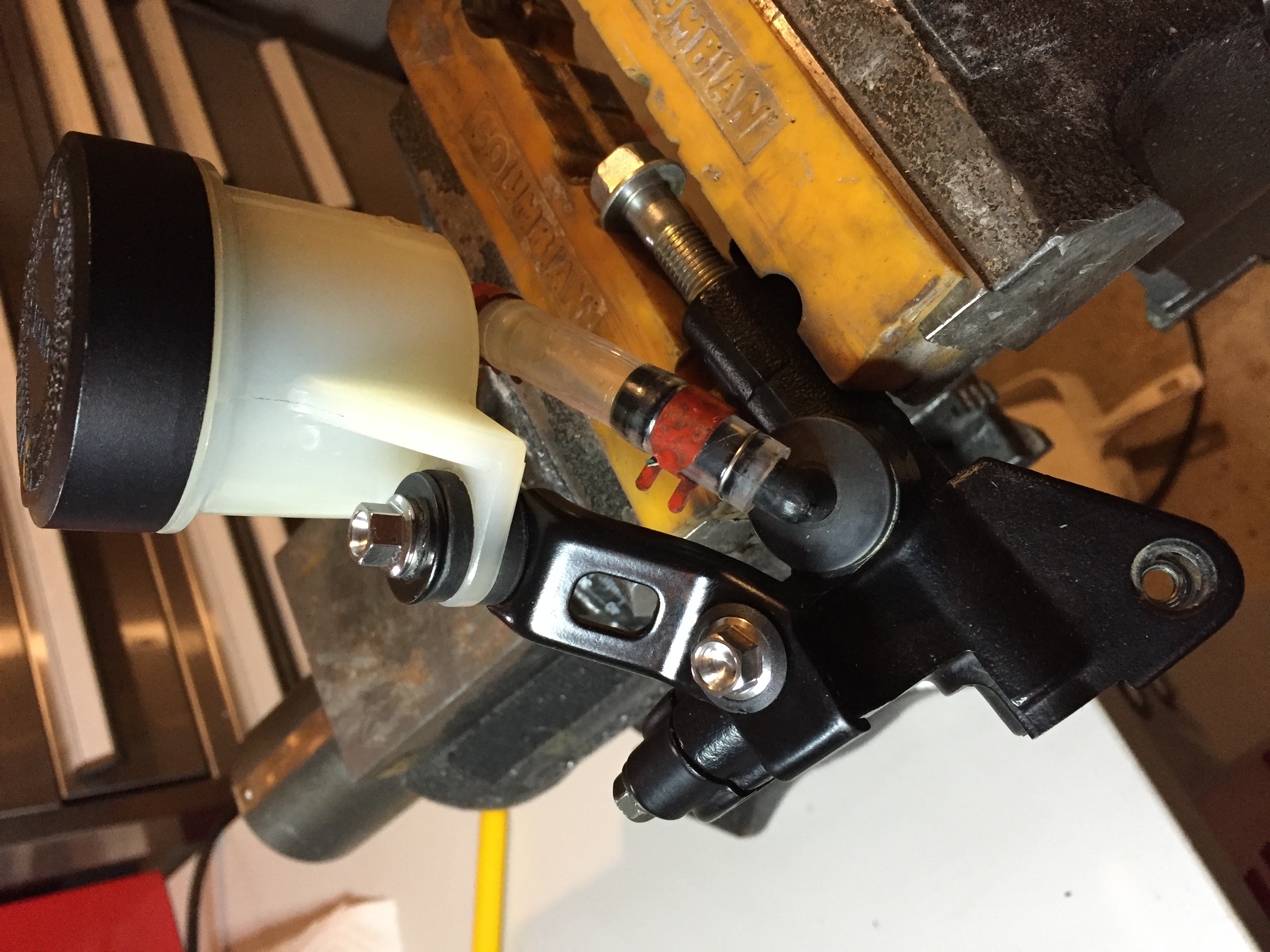

Finished wiring up the new MOSFET R/R and the flasher! Also went through the front master cylinder all set to reinstall when the front end is completed!

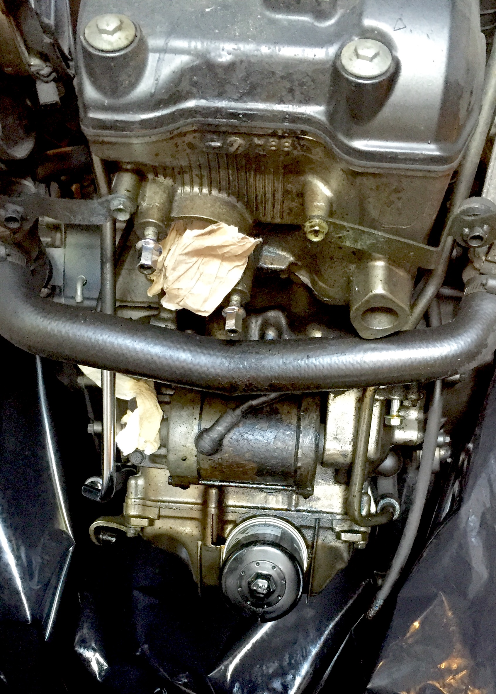

Spent two hours cleaning road sealer off the front on the engine, reckon there is another 4-6 hours before its done! Ugh... Got sick of spraying an scraping and started on the carbs since they were off...

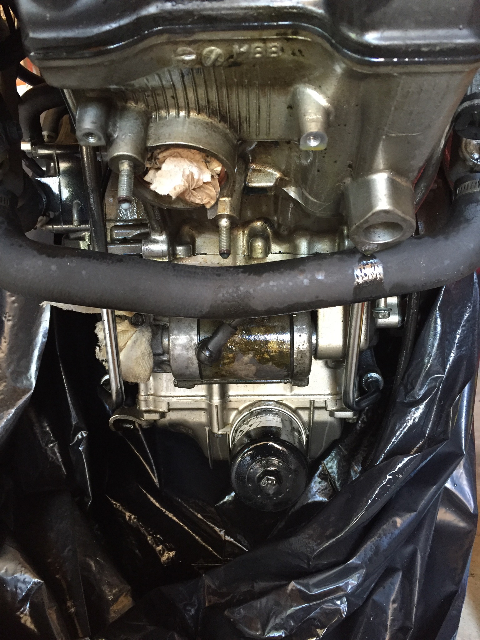

Again I got sick of steaming off the road sealer so I took a break and rebuilt my clutch slave and mounted the cover and the slave...

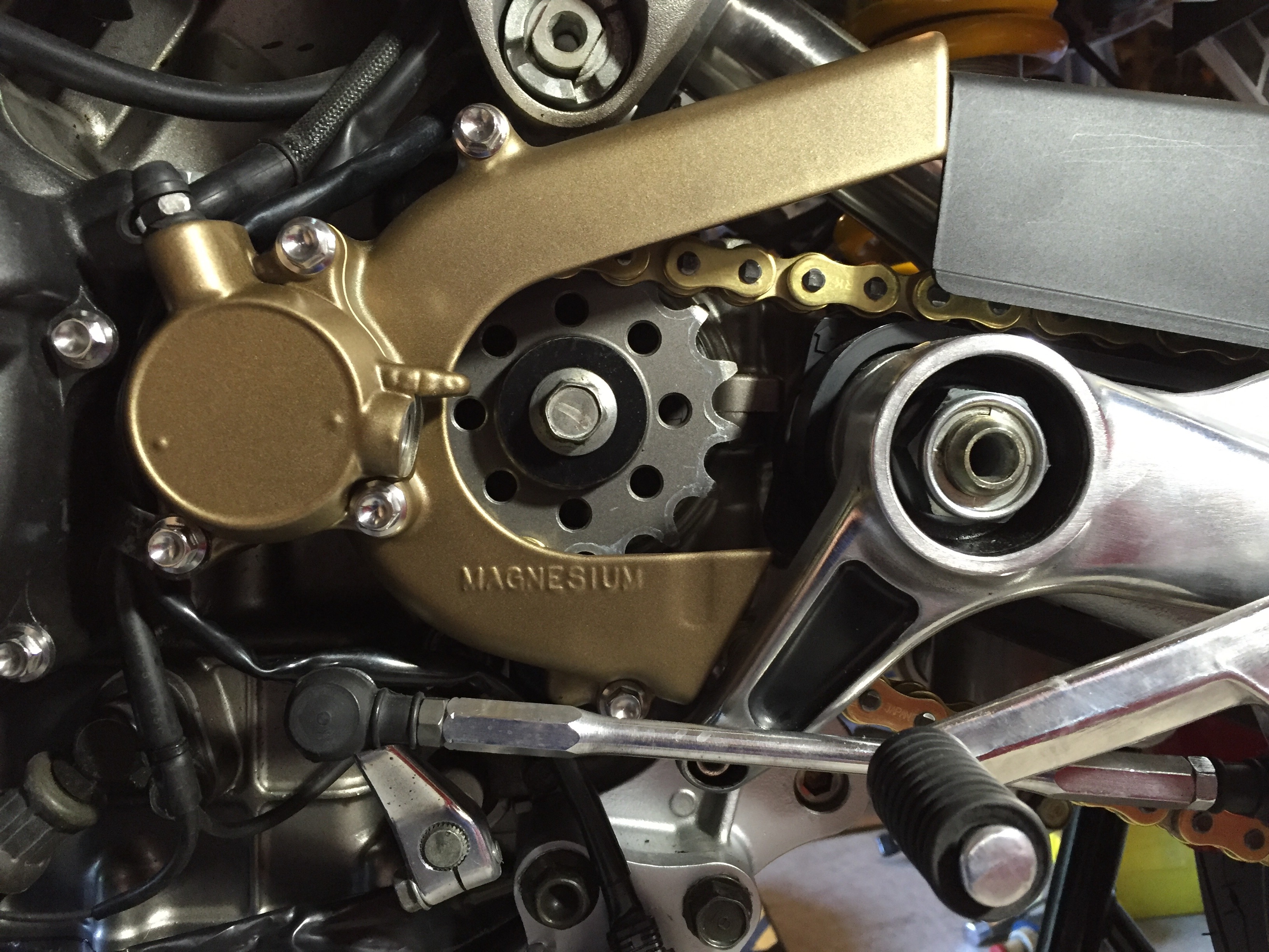

OK, so it was yesterday. Figured I was never going spend the money to get the parts to rebuild the set of 954 calipers I've had sitting, waiting for a really long time, I installed them.
A little time with a Dremel and sanding drum they were on. Will install the 954 M/C (have had this part for a while also) rebuild kit that is now on order. In the interim I will be enjoying the much improved braking power.
Lever travel is not near as much as I expected, really not that different from stock. Effort is a little more, and is also better than expected.

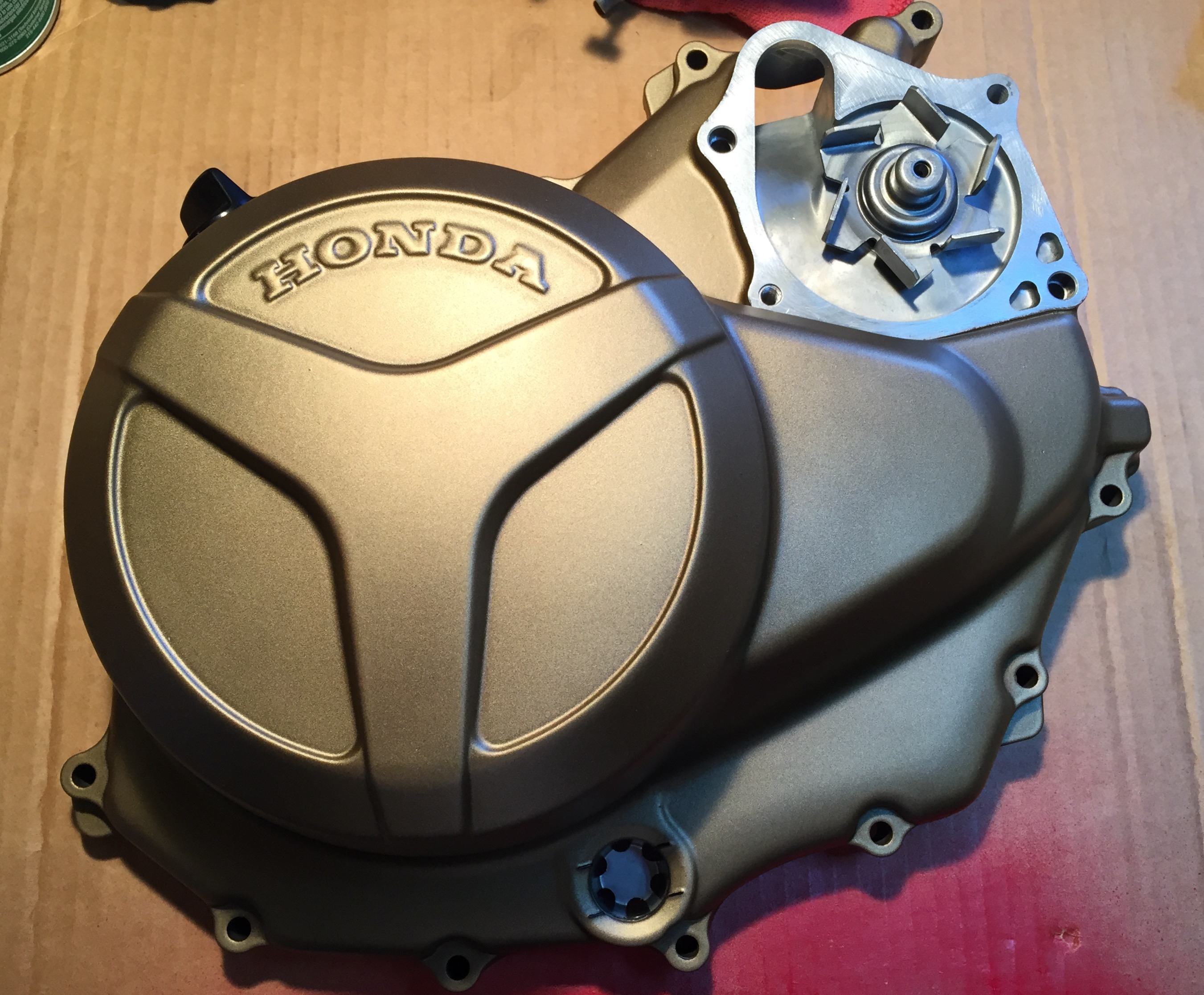

Wednesday night Ducati Tuner/Builder/Restorer extrodinaire Mike Weber took time out of his mega busy schedule to press fit the water pump impeller back into my VTR1000F engine case. At the end I thanked him for his help and tried to take a celebratory selfie of us while holding up the Honda manual! Mike was having none of that and so, dropped the clutch, pulled a u-ey and started to exit the frame! Too slow Duc man, too slow! Hahahahahahaha!

Ready to install!
