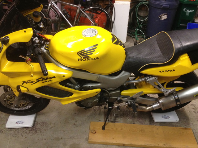

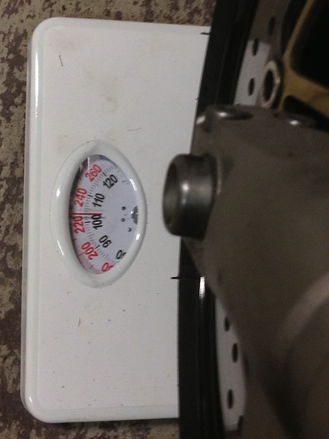

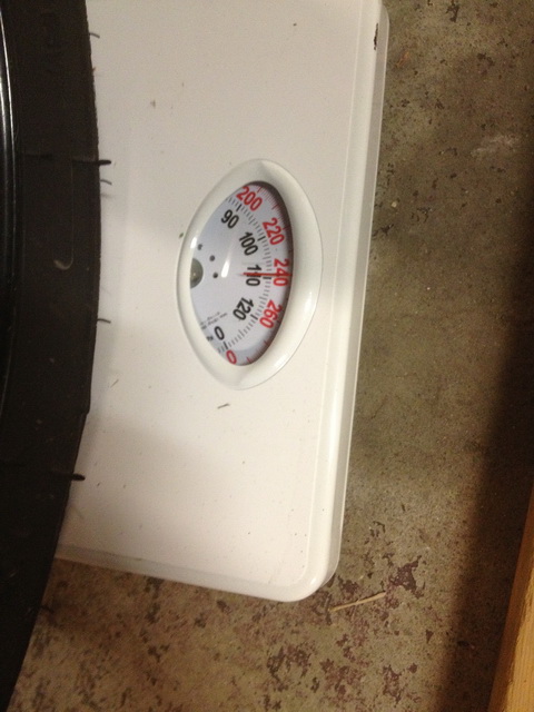

I had to see for my self! yep!
Full tank of gas, brimmed! Two brother pipes.. Michelin Power 3's (new)
226 Front
239 Rear
465!!
See for you self!
Front

Rear
Old May 27, 2013 | 07:27 PM
VtrInMtl's Avatar
Joined: Jul 2012
Posts: 103
VtrInMtl is on a distinguished road
Is that a Corbin seat, mine weighs 3 times as much as my stock one....
Old May 27, 2013 | 08:09 PM
Caffeine's Avatar
Joined: Oct 2012
Posts: 142
From: Ottawa Ontario
Caffeine is on a distinguished road
It's a Sargent. Didn't get the original seat so not sure if t weights more or less. Comfy though.
