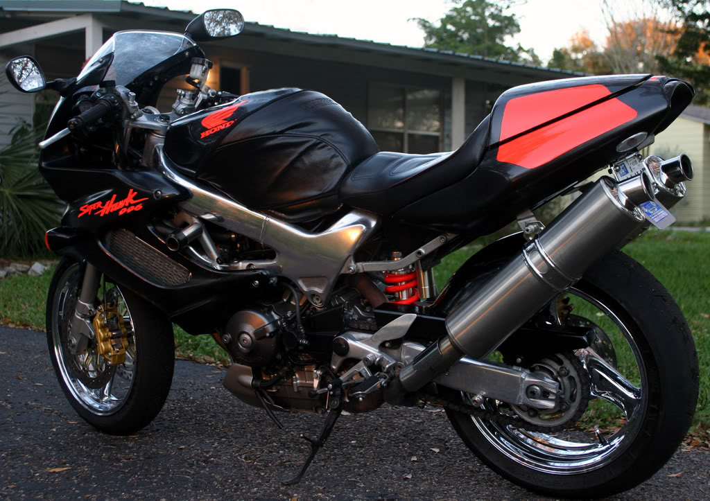

I recently posted this pic in another thread.
It shows an R1 shock I tried. The spring is from a Fox unit that I removed and painted to match. For those two shocks, I just had to run the pre-load the the absolute minimum which relieved enough tension on the spring that I could pry the bottom mount loose and slip the spring off. You can't do this with the stocker.
