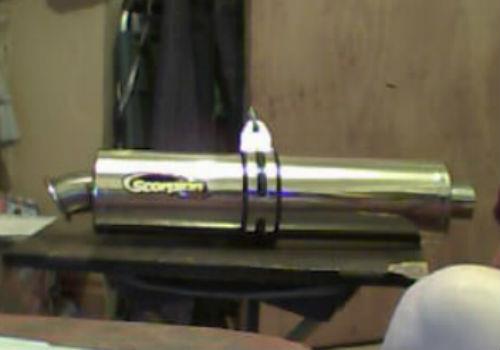

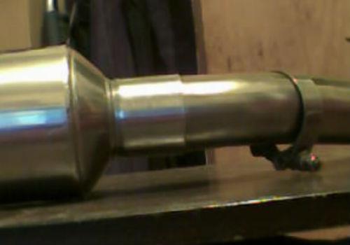

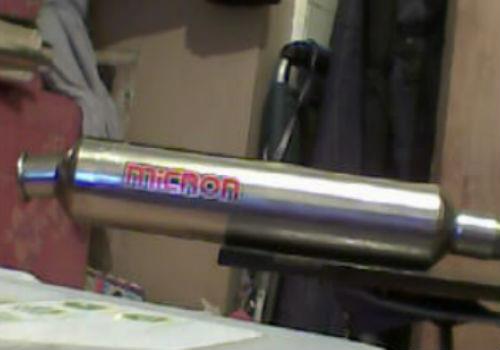

hi all,i have a question regarding this rr from my 1987 cbr 600f ,well a few questions . 1 is this the right one for my bike .2 i see it has the sh prefix,shunt type is there a mosfet fh type from another make/model of bike that will work.this one has a power drain of 6 v with the bike off and has fried two cdi units and cooked 2 batterys.thanks for any help.more questions will i have any problems using the r1 rr as its from a 1000cc bike and i have a cbr 600f such as the amps needed,my bike has an 8 amp/hour battery. also i picked up a scorpion race can and was wanting to know if i can use it without changing jets or air filter . also anyone suggrst how i can remove the micron can as im unable to split the joint in pic . thanks again to saige and wolverine for the replys

the can should just come off the pipe,it may be stuck,but just maybe it was made as a one piece.
someone they may or had one of those may be to answer your question better.
you can put those pipes on without doing a complete rejet,but should/do need to mod the carbs a bit.some light work and patience will get you right.here is a link for the carb setup that should get you in the area you need to be in with these cans.

thanks saige do have a manual also the can is not a 1 piece just stuck fast an thanks for the carb setup info nice one

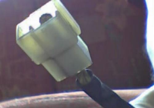

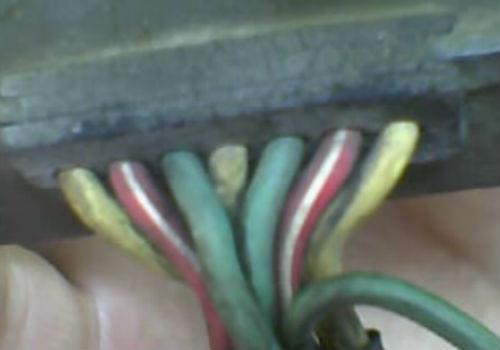

pics for saige
pics for saige

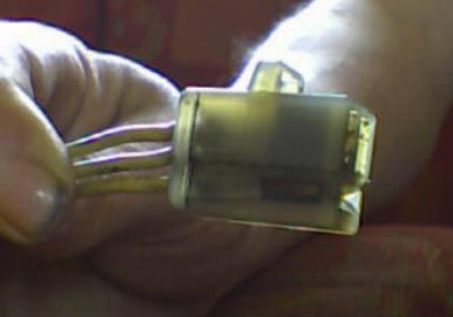

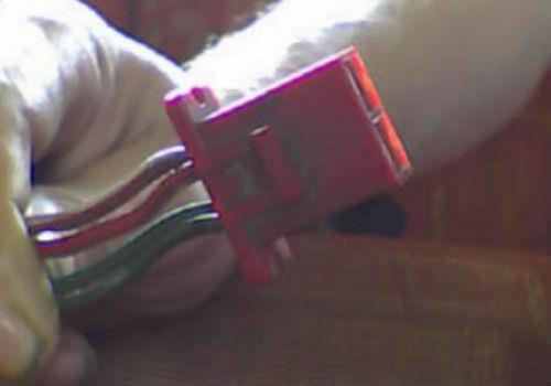

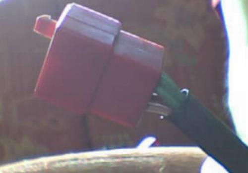

pic 1 wires from the rr
pic 2 white rr plug 3 yellow wires
pic 3 red rr plug 2 wires with red/white stripe 3 green ones with earth ring
pic 4 harness plug ,2 red/white wires 2 green
pic 5 white stator plug ,3 yellow wires
Attached Thumbnails new member-549108_4322306100983_1608453507_n.jpg   new member-205237_4322328341539_878004779_n.jpg   new member-255338_4322330941604_485264890_n.jpg   new member-382414_4322291740624_415342283_n.jpg   new member-547751_4322270980105_1491731350_n.jpg
