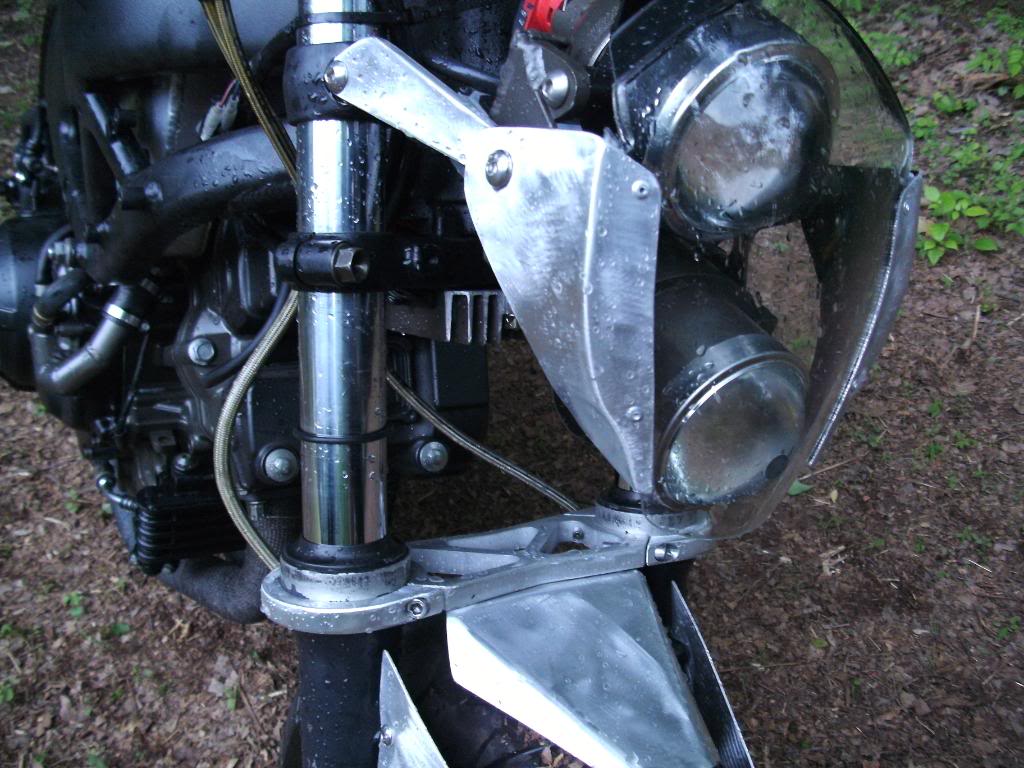

Truckinduc's Avatar
Posts: 1,033
here is the prototype on my bike. Production ones will be very similar, just powdercoated. Still trying to get my friends milling machine set up, Ive got to re make a jig.
