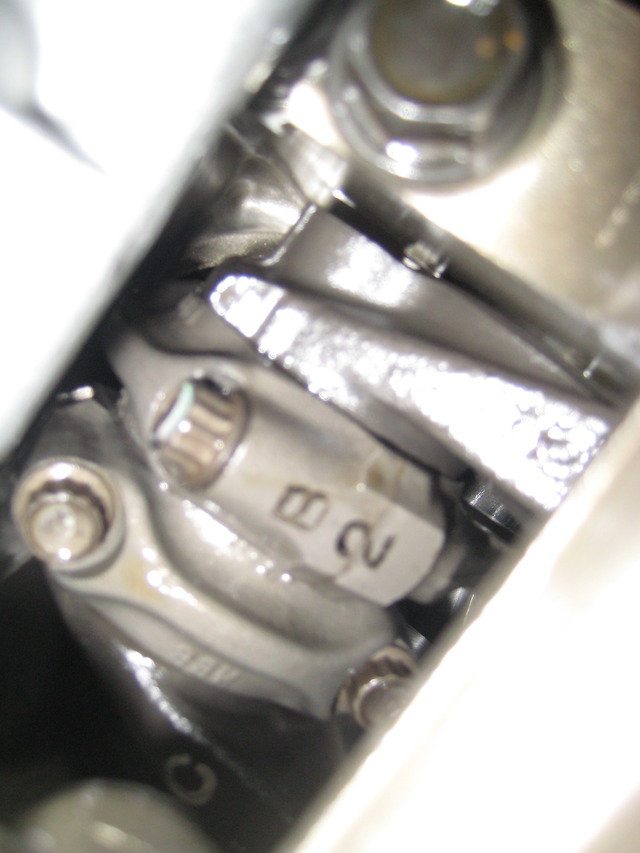

VTR knocking noise
First, Thanks Big Jim, your thread has been very useful. I have been chasing a noise in my newly purchased VTR. Removing the rod caps and using plastigauge has indicated that both are within limits. The book calls for 15 ft lbs +120 degrees. This did not seem very tight? So, maybe I have been being nervous about my new Shawk. I recently sold a Ducati (1990 750 Sport) and remember it being pretty noisy, but I expected a watercooled vtwin to be quieter. I will put up a video when it is running and see what you think.

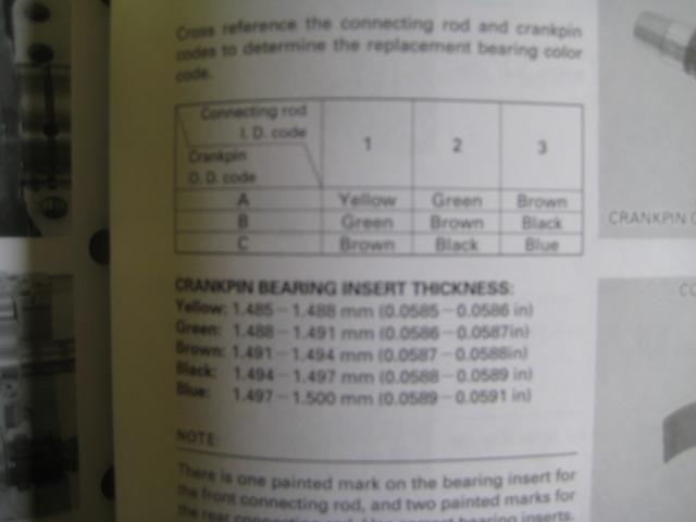

I thought that this pic might be of use.

If you had the rod caps off you need to install new bolts. Honda stresses this and it is best practice. They are not expensive.
What did the oil pan look like? You will have more indication of bearing failure if you see gold flakes in the pan.

I have ordered new rod cap bolts. Used the old ones to do the plastigauge. Oil pan was clean. No flakes of any kind. I modified the factory cct's so that they are now manual. After listening to your hawk in the vids, mine sounds a lot like it. Guess that I have just been being an old woman. I did learn that taking off the rod caps is a real pain. Thanks for the replies.

You could have also sent out an oil sample for analysis for metals suspended in the oil.
You and me both. I worry like an old woman about my bikes and any noise. Honda says that you can torque new bolts to 15 foot pounds to check with plasitgauge. I think it calls for 21 foot pounds at full torque and then the bolts have stretched.
And that is a big YES! It is a huge Pain in the butt to do the rod caps that way. It is actually good that you checked. I just got through with a rebuild and i have a ticking sound I can't locate. I am going to ride it and try to ignore it.

New rod bolts came in today. The book calls for 15 ft lbs + 120 degrees. I do not have a special tool to indicate degrees so I have put paint marks on the bolts 120 degrees apart to aid in the torquing process. Any suggestions?

Connecting rod bolt 29 N·m (3.0 kgf.m , 22 Ibf·ft) + 120
Connecting rod bolt (standard) 20 N·m (2.D kgf·m, 14Ibf·ft) + 120 (this is for checking the oil clearance)
You are right. Apparently I need to read more carefully. THANKS
