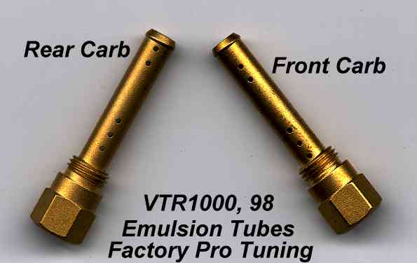

The other bit to check would be the emulsion tubes. This is the part that the main jet screws into. They also have some very small holes in them. Just be careful as they are different from front to rear.
stumped & frustrated, carb/engine issues...??-vtr_emulsion-tubes.jpg
