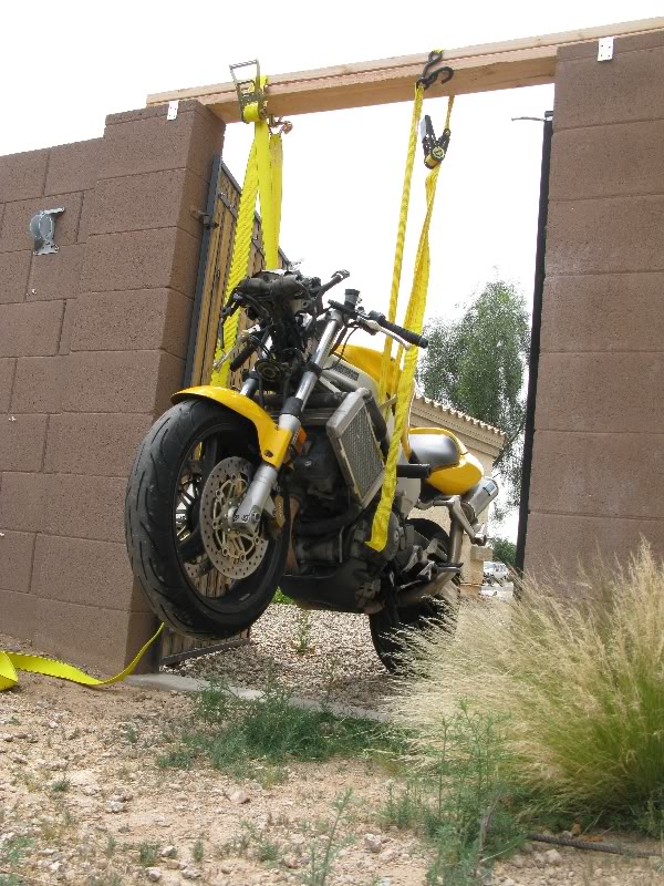

installling new steering bearings isn't hard I did it (with all-*****) as part of my fork swap.
This is how I suspended it:

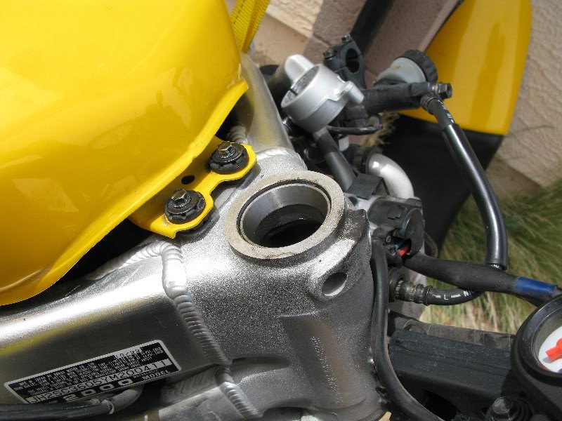

Then I used a 2 foot length of 1x1 and a hammer to remove the old bearings, tapped the new ones in with the old bearings used to press on the outer rim of the new ones. No pics of the process, but easy enough.
After it looked like this:
nice. the all purpose doorway.

Haha lazn, that was one of the first threads I looked at when I found this site... I remember thinking,
a) Holy smokes, I'm allowed to do stuff like that? I'm pretty sure that method is not in the service manual...
b) Gotta love that Arizona cinder block wall and dirt yard!

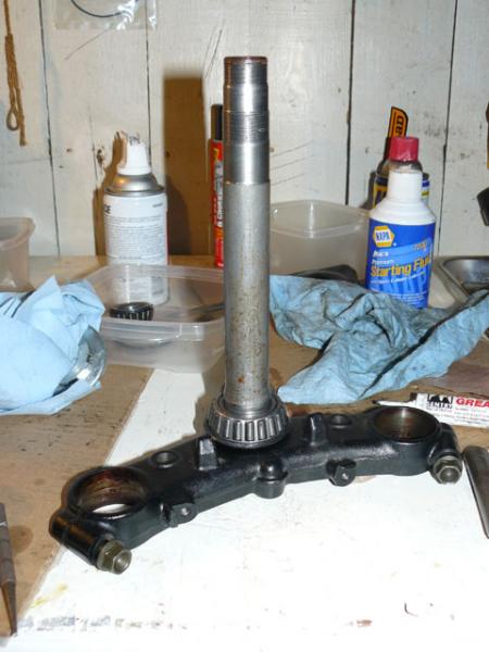

sweet lucky me. i bet its a pita to replace too isnt it. the best part is i jsut put the front end back together and was feeling good about not having to pull it apart again, lol
i had put tapered bearings on my original steering stem and only realized after the fact that the lower brace was ever-so-slightly bent. so i also got to pull everything apart again.
use your old bearing race on top of the new bearings to batter them into place. that way you can use your pounding tools of choice without damaging the new bearings and race.
getting the lower bearings completely seated on the steering stem was more difficult than i'd expected. i had to wail on that one much longer and more forcefully than i'd expected. you wanna make sure that it is actually seated all the way down at the bottom of the stem. it was such a project getting it fully seated that i took a picture of it when i finished.
finding moly-disulfide grease is about as easy as it is to say "molybdenum" really fast twice. here's a link to the stuff i use. it's high quality and easy to handle:
