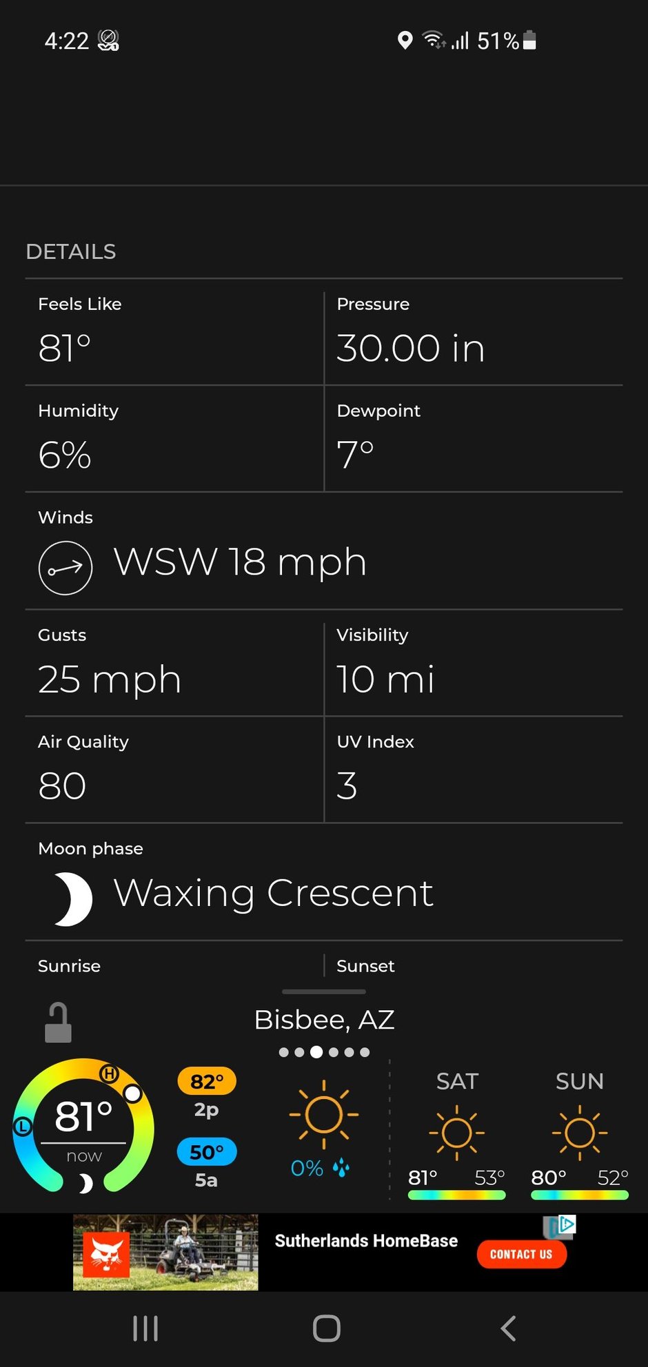

The open barrel terminals were crimped on to the wire, but not installed in the connector. From memory it looked to be expertly done. The wires to the RR were scorched and the terminals were oxidized pretty badly. Wires from the stator weren't scorched, but the terminals were.
Originally Posted by VTR1000F
Might be due to corrosion, either on the connections pin-to-pin, at the pin crimp to the wire(s), or both. I feel this is a common occurrence on bikes. Of course, your heated accessories were a contributor if not the root cause.
Corrosion usually isn't much of an issue here.
