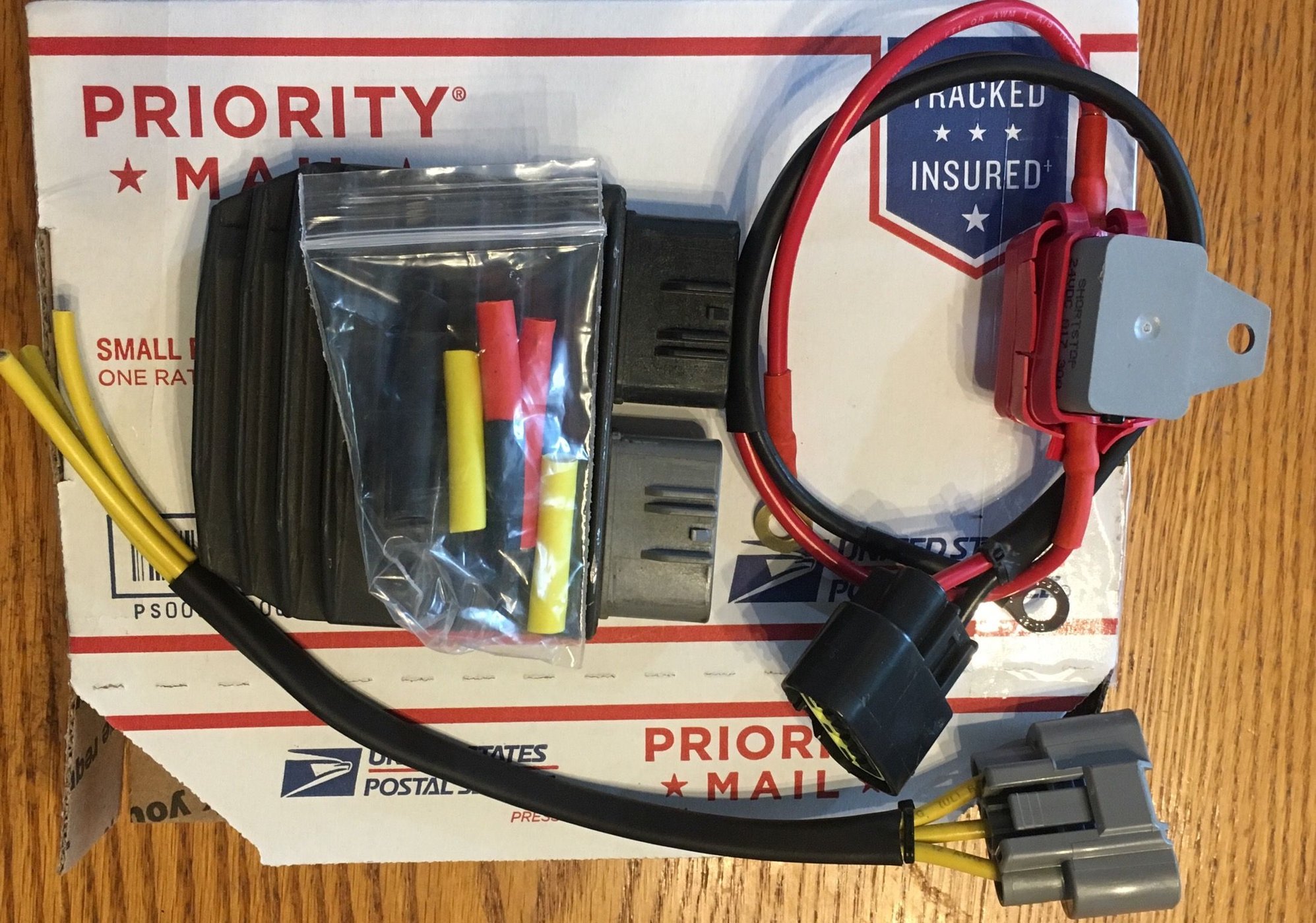

Gen III Plug and play ready to install Superhawk MOSFET RR Kit FH020 (50 amp rated, and the VTR Alt output is MAX of 23.3amps @12VDC)
$153.00 shipped Priority mail in the US.
Easy, fast and complete, not a general fit kit that will have excess wiring you have to pile up someplace, but a kit that is designed to fit the Honda Superhawk perfectly.
Entire kit is pre-assembled. The installer only need remove old RR, bolt in place the new MOSFET RR, unplug the stator from the old wiring harness and plug in the new RR cabling provided. Add the charge cable ring terminals to your battery, zip tie cabling in place, replace tail cowl and go ride. This kit will come with 6mm battery terminals found commonly on lead acid type batteries. If you want the smaller 5mm terminals used with some Li Ion batteries just ask at the time you order.
This kit replaces all of the known problems with the VTR charging system. Melted plugs, burnt wires, Diode RR in the process gaining increased charge voltage to the battery. All protected in black PET wire sheathing or black heat shrink tube, marine rated circuit breaker. Ring terminals sealed with adhesive lined heat shrink tube which also provides a stress relief. No weak soldered joints all terminals are professionally crimped with the correct F and O crimps on wire / insulator with heat shrink tube stress relief on terminals where needed.
The kit comes standard with a genuine Shindengen FH020 MOSFET regulator / rectifier. The RR is a used unit from a late model bike, fully tested on both the bench and a running motorcycle. Short of physical damage from a crash, mishandling or fire there is an almost zero failure rate of this model RR when installed properly. Making used RR’s an excellent value. I can also provide new Shindengen FH020 MOSFET, RR’ or the newest design Shindengen switching style SH847 RR at decent price. If you want the latest and greatest Shindengen RR, a switching design that is believed to be easier on the VTR stator and has proven cure significant stator overheating on other model bikes with a known issue for burning up stators, I can offer an upgrade to the kit to a brand new Shindengen SH847 RR for $280.00 shipped
The only way to get more plug and play is if I put myself in the box and do the job for you.
Other kits requires soldering tools, experience to get a proper soldered joint, and they reuse the ancient OEM wiring harness components, undersized or just plain cheap wire with pore quality insulation. Other kits use cheap Chinese pattern part plastic connectors that are commonly seen broken in short time.
Some kits or installers use cheap butt connectors, unsealed plugs and even crimp on spade terminals for the RR connection instead of the correct sealed style Furukawa 250 QLW Series R&R Connectors. Or almost as bad, the right connectors, improper crimped.
All of these things lead to early RR failure, damaged batteries, melted wiring ect….. the MMS MOSFET RR kit avoids all of those pitfalls.

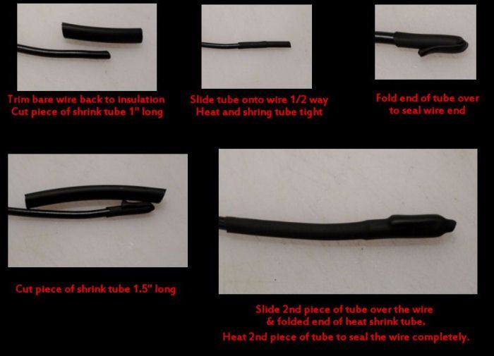

After installing the kit, you will have need to seal off (or use for an accessory) the old charge wires coming from the harness.
Here is a good way to do that.
Unused OEM charge wire sealing

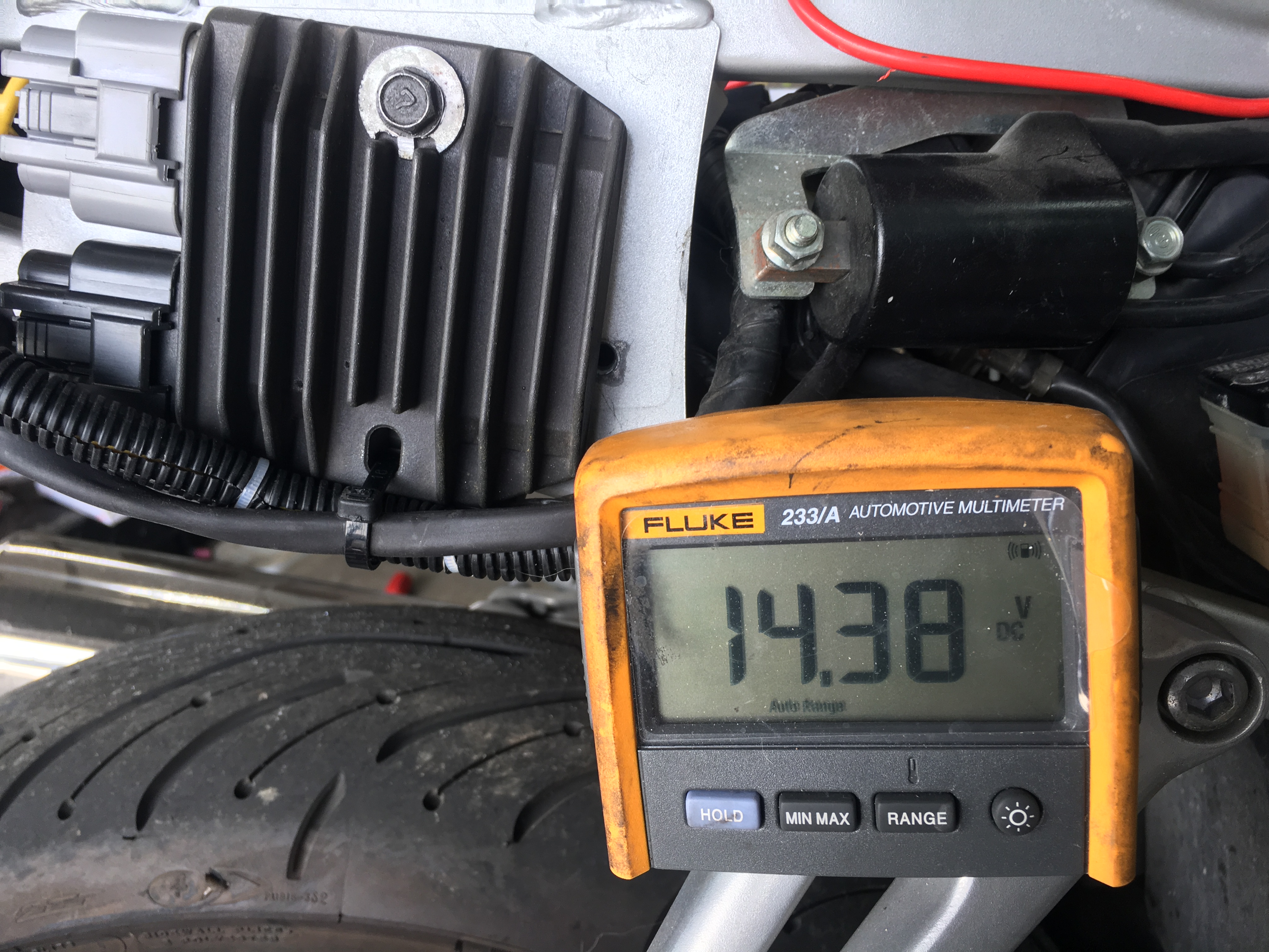

Another install
42 min roll In to start
Rock solid 14.38 charge volts at idle
Attached Thumbnails GEN III UPDATE  13 MAY 19 Superhawk MOSFET  RR Kit  153.00-707d6dee-f56c-4941-8771-eeb3acfbf61c.jpeg
