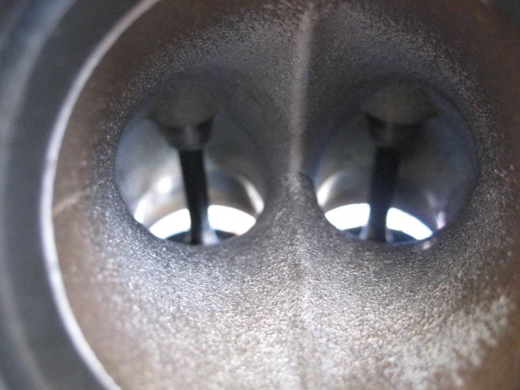

Got the rear head off today and took some pics. Both intake valves are bent. Exhaust appears to be fine. The piston shows marks in the carbon where there was probably contact but doesn't appear to have any damage.

Old Jun 26, 2009 | 11:25 AM
HRCA#1's Avatar
Joined: Oct 2007
Posts: 1,082
From: Menifee, CA
Pardon me if I'm wrong but the buildup on the pistons doesn't look right to me. It looks like your burning oil, was the bike smoking at all or is it wet and ugly from the bent valves leaking fuel into the cylinder. It looks more like stem seals or worn rings to me. Ther are some sharp tech guys on the Forum that might like to chime in.
Old Jun 26, 2009 | 11:43 AM
Circuit_Burner's Avatar
guru of things sparky
Posts: 599
From: Grand Prairie , Texas
Pistons look good at the impact points.
Cheap gas and other BS additives like octane boosters does that, thats not oil.
Oil leaves a sheen you can see.
If it was burning oil, it would extend to the edges of the piston crown.
Get 2 new valves (or all 4 if youre smart)
Decarbonize the piston crown, and have the valves seated by a good shop.
(or yourself if you do that)
You be back in buisness pretty fast.

I assume the ultimate test would be getting it back on and doing a compression test.
Yes, new valves will need to be reseated. They don't need a lot of lapping, just enough to get an unbroken gray ring around the valve.
You can visually inspect to see if any valves are bent, but the best test is to check the valve clearance before you remove the cams, if they are way out of spec, they are likely to be bent. You can do leak tests using alcohol or somesuch around the rim of the valve, or remove them an roll them around a flat plate, or spin them in a lathe, anything out of true will show up.
Cheers,
Paul.
