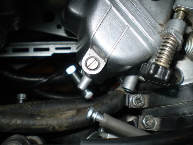

Old May 9, 2011 | 08:54 PM
Float bowl drain screw:
It's on the bottom of each carb, can be reached through the frame, unscrew and gas pours out the little nub on the bottom... smoking is not recommended

ah ha, i see. Thank you. I'm worried of cleaning the carbs b/c i have never done this before and have also been told that if i touch a certain piece i might as well get a new carb.

It's a good idea to slip a long hose over the drain nipple on the bottom of the bowls before opening the screw. Then direct the other end of the hose into a suitable container. Even a small amount of gas can be nasty.
