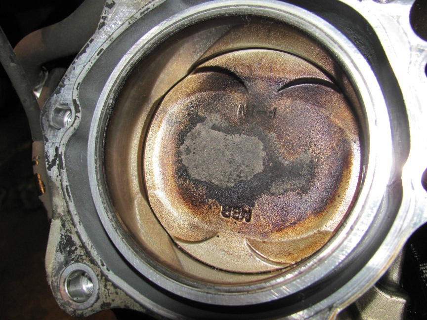

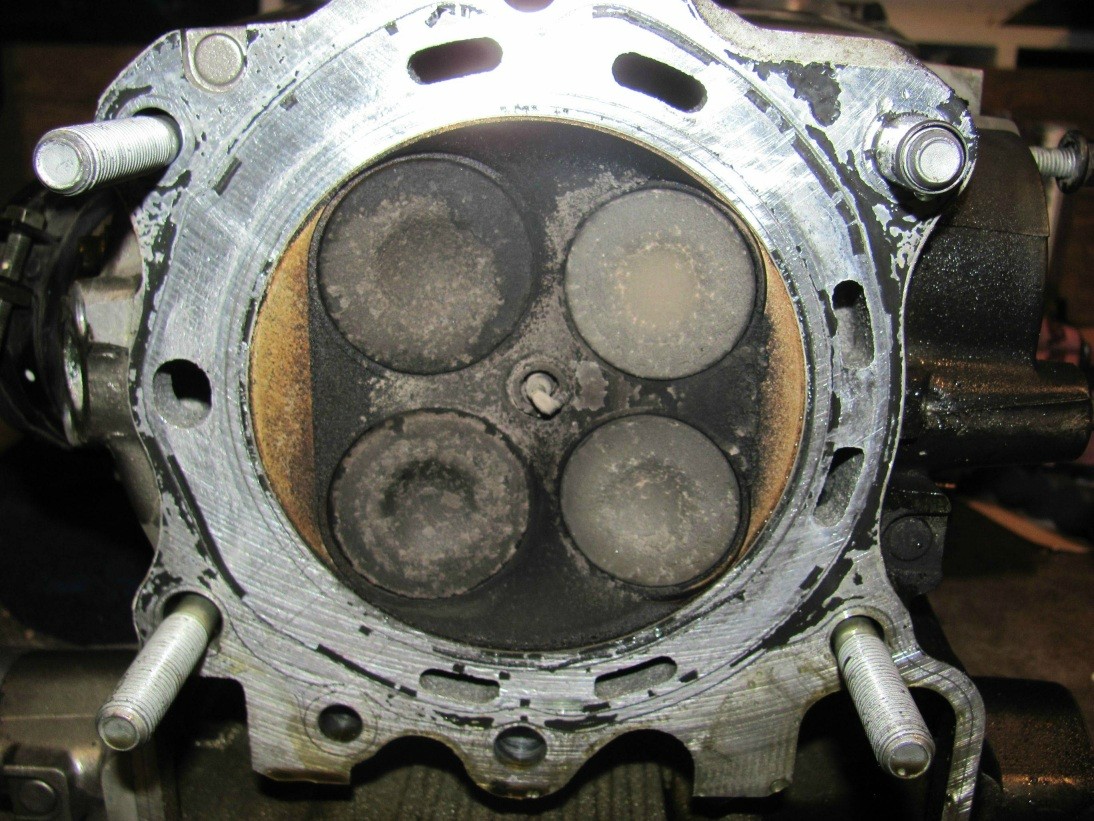

After looking at most of my internal components for the source of my noise, I happened to look down the intake on my front cylinder. I saw what looked like some serious carbon buildup. So I popped the head off today and look what I found. The patch on the piston is large and raised off the surface. What is the best way to go about cleaning this off without removing the piston?

Try just wiping it off with a cotton rag first, and a little oil if necessary. I was surprised at how much I could get off of mine just doing that.

use a wire wheel that hooks onto your drill.... that is what i did and it came off really easy. just put the piston a TDC and zip it right off.

Did you clean the ports for the EVAP system? That are in the corners of the Factory air box.. Which I don't think would make that noise.. IMO it is still a "Spark Knock"...

Silly as it seems, I am waiting for a member to suggest that your CCTs are failing( which is causing the timing to fluctuate) and causing the "Spark Knock"
Now being that your bike is a 1998, Please tell me that you have consider changing the CCT(with factory/or manuals)
The cylinder head looks fine, (some carbon/ I have seen worse) Top of piston looks fine- you can tell from the burn pattern of the 93 octane use..
How do you feel about -Putting it back together/and attempting the cheap fix procedure??

I have had manual CCTs for the past 7500 miles. The piston actually has a significant amount of carbon where that burn pattern is, it is probably 1-1.5mm tall. I'll knock that off before I put it back together.
You're suggesting running a few tanks of 87 through, with a carb cleaner mixed in?
