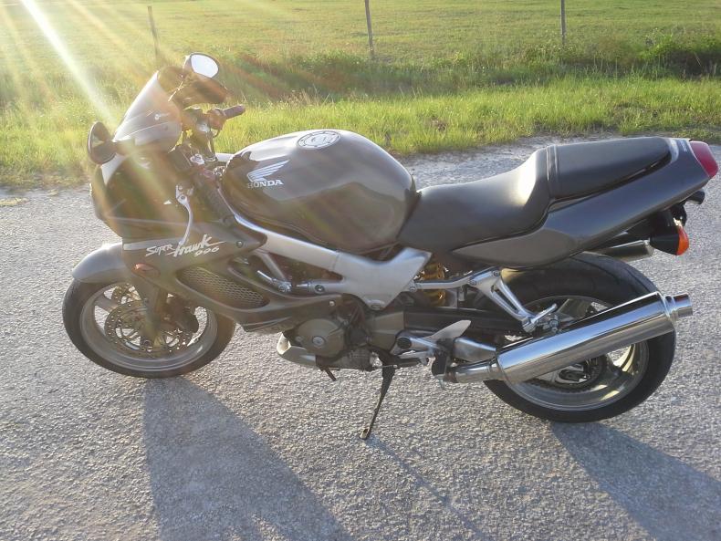

Congratulations Big_Jim59 on the completion of your Hawk! Don't change the color or anything else, and enjoy the ride...
'Hey! I like that. If you look close at mine it shows signs of wear. There are scratches on the fairing where it has fallen over (on both sides) and a few nicks in the tank but I just love the understated color.

I rode it up the road, about 5 miles to get my state inspection so I can get my tags. I threw an old tag on it just to keep from being stopped.
First Impressions of the 2005 VTR1000 Honda Superhawk
• Fast!
• Handles like it is on rails
• Pulls HARD!
• Engine still sounds tappy
• Idle increased about 500rpm after ride
• It gets all the gears
• Engine sounds like a sewing machine (not what I expected.)
• Fast!
• I saw and indicated 90mph and wasn’t pushing it.
• Lots of torque right off idle
• It likes my dirt road better than my VFR
• The riding position kind of hurts my neck but I think I am not used to it.
