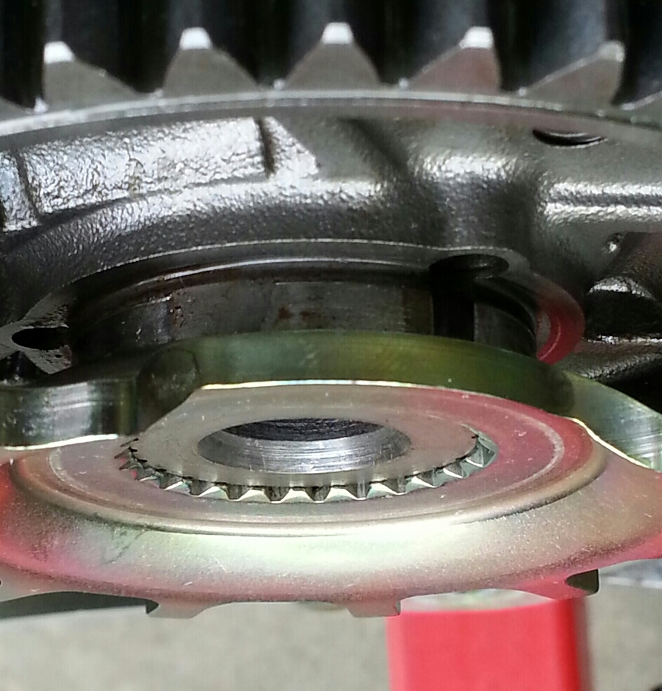

Old Sep 21, 2015 | 04:04 AM
  #189
Big Jim,
Do you have an ignition advancer fitted?
I don't run a water pump gear or chain as I have an electric water pump fitted and still my bike makes some noise in the water pump area.
I am used to it now. Maybe it is because I have no anti rattle gear either.
I am used to the sound now but wish it wasn't there as it wasn't there before I did a heap of engine mods.

Originally Posted by kenmoore
Big Jim,
No advancer.
It's really good to know that yours make this sound too.
I removed the anti-rattle gear on mine too. But I have to admit that I did so because I couldn't figure out the proper way to fit it. As best I could figure the anti-rattle gear put pressure on the clutch basket gear to always maintain contact. The first position I tried had no effect and produced no pressure. It seemed that it would just add noise. The second position, moving the gear one full tooth, compressed the springs a great deal more than seemed correct. I could be wrong but I removed it not wanting to fish broken springs out of my motor all for something with limited effectiveness.
I'll just live with the racket. I can't hear it at road speeds, with my ear protection in and the Two Brothers cans blasting away. I just hear at idle.

Old Sep 23, 2015 | 02:57 AM
  #191
Maybe it's the removal of the anti rattle gear that causes the noise.
If I ever go back in there which I hope I don't I am going to fit a washer the same thickness of the anti rattle gear and see if that takes care of the noise.
Problem is that if I do that then it may sound different again and my paranoia will start all over again , Ha Ha bloody Ha!

Old Sep 23, 2015 | 07:08 PM
  #196
Kenmoore, as you can see in the picture below, the ignition rotor only goes on the shaft so far before it hits a ledge and stops. It stops at the same point with or without the sub gear. If you were to put a washer in there, it would push the ignition rotor out and passed the stock position. It then might not be picked up by the sensor.

Old Sep 24, 2015 | 02:51 AM
  #197
Thanks Crux,
Shoot there goes that idea!
That's what I enjoy about this forum, the fact that like minded people can be bothered to help their fellow brethren out.
I appreciate the information and pics.
I have had a hankering to do a clear clutch cover lately and will definitely check it out when I go in there anyway.
Don't hold your breath as I have other things to do before that happens.
