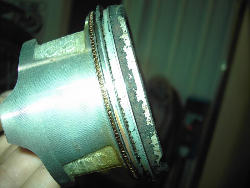

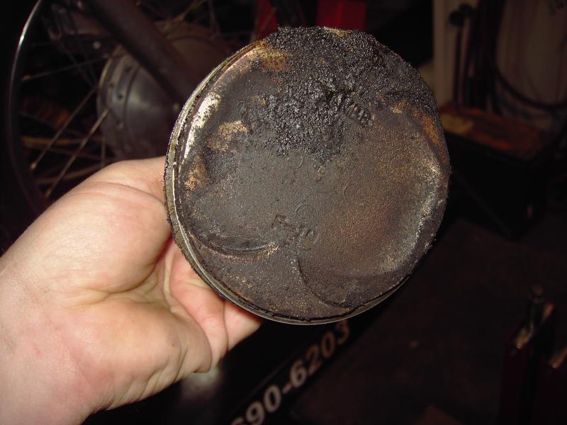

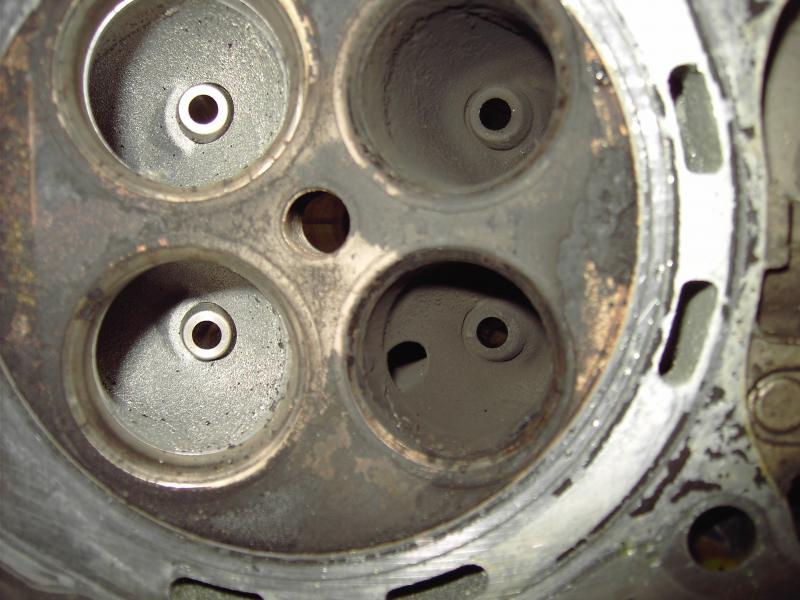

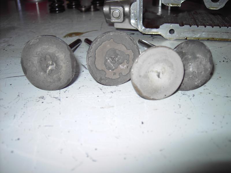

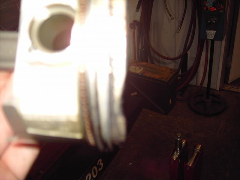

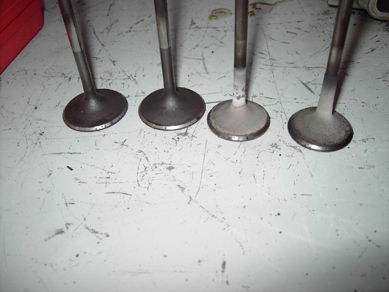

Here are some more pics. The pistons cleaned up really easy. Usually parts cleaner won't touch a carbon build up, but it melted with through (supporting the soft carbon theory). The head looked slightly cleaner than the rear, but the valves were much dirtier. One of the exhaust valves looked like hell, and I am imagining this had to do with 1:leaking valve for 900 miles or 2air system for the first part of its life. You can clearly see the buildup on this valve in the pics. They all received a fairly aggressive treatment to remove all carbon, and will be reassembled when I clean the head.

previous piston pic:

That is a lot of carbon above the top compression ring, not normal.
