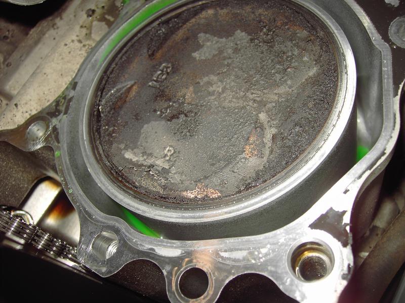

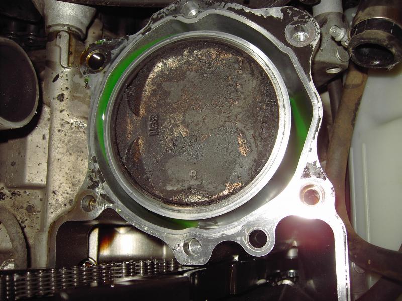

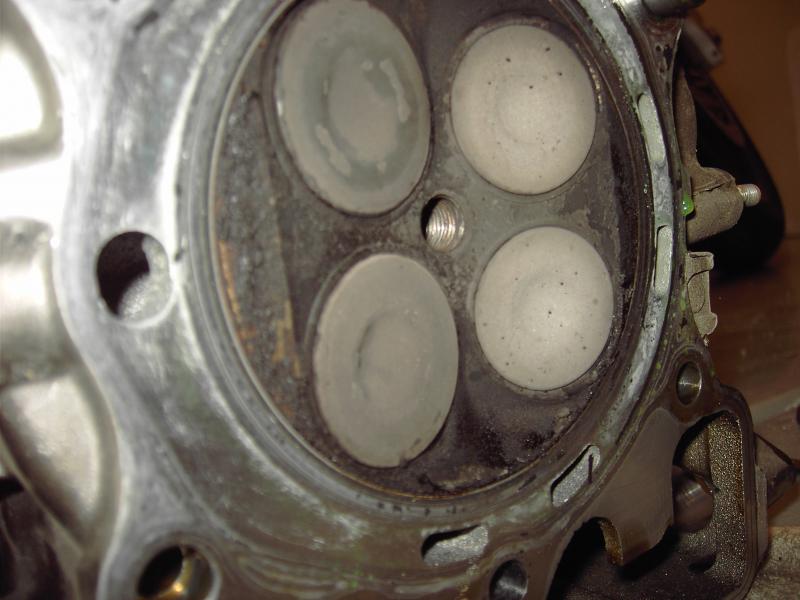

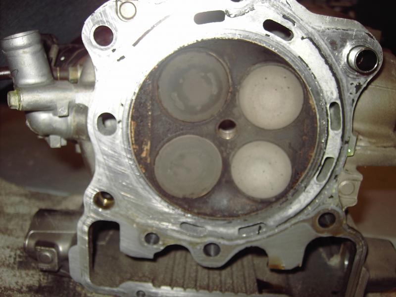

Well, I have to pull the oil pan to sneak the rods and pistons out, but here is the preliminary results:
Something, besides the enormous amounts of carbon that is covering the piston and the little bit of exposed cylinder, is that the valve seats are not trimmed flush with the combustion chamber. Did anyone else have that on there head when they took it off? I am condemning the rings, as the VALVES ARE NOT SMASHED. I am not saying that they are sealing 100%, but I am going to clean that up prior to reassembly.
Update:valves also have carbon deposits on them. Its like cancer, it flaked off cylinder, head, and piston and made it onto the faces and seats of the ex. I am sure the rings have seen similar "damage". I will be able to clean the valves and bring them back to life.
Attached Thumbnails Lucky to be here-pict6230.jpg   Lucky to be here-pict6231.jpg   Lucky to be here-pict6232.jpg   Lucky to be here-pict6233.jpg

Ex valves had a easily removed "flake" carbon. The compression numbers and the amount of carbon in the cylinder has me wanting to pull the slugs and clean the cylinders.
Is there a chance, for those who have tore down their engines, that the piston and con rod can be removed just be pulling the oil pan?? I just dont feel comfortable with going through the motions of cleaning the valves, and ignoring the bottom end, spending the money to put it back together, to end up with marginal compression and more time invested.
Old Sep 29, 2009 | 05:44 PM
shayne's Avatar
Joined: Dec 2005
Posts: 963
Pretty sure you can Bill. Some people have put in high comp pistons without a full disassembly.
Bit of a weird problem. I would have thought with compression that low the bike would have performed terribly on your last ride. That much carbon build up needs smore thought given to it, as you need to find out why it has happened.
Old Sep 29, 2009 | 05:57 PM
autoteach's Avatar
Posts: 1,611
From: Belgium, WI
12000 feet extended ride, followed with 6-7000 feet for two days on a bike that was jetted on the rich side at 500. That is my guess.
