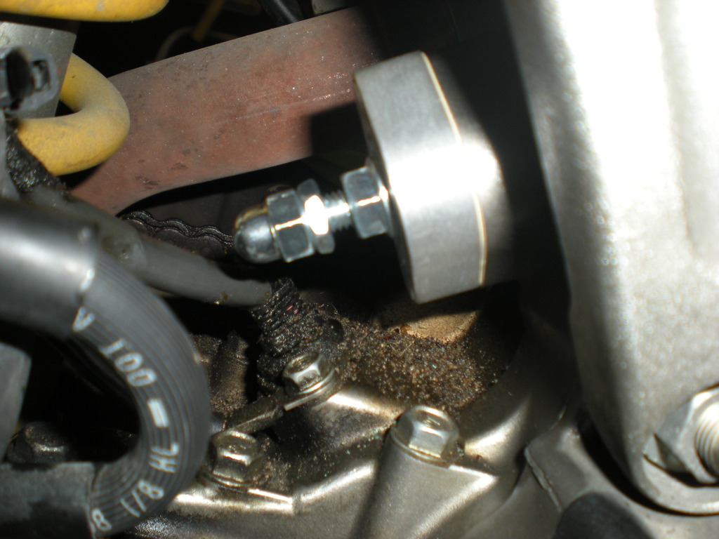

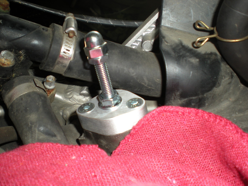

Alright, so all I am waiting for are my vacuum pistons which should be in today. Since it has been posted here already I figured I would continue.
I installed my Krieger CCT's and they look like this. I think the back looks about right from what yall have said but is there too much thread showing on my front? Name:  DSCN0358.jpg

I will be adding some loc-tite when I know they're good.

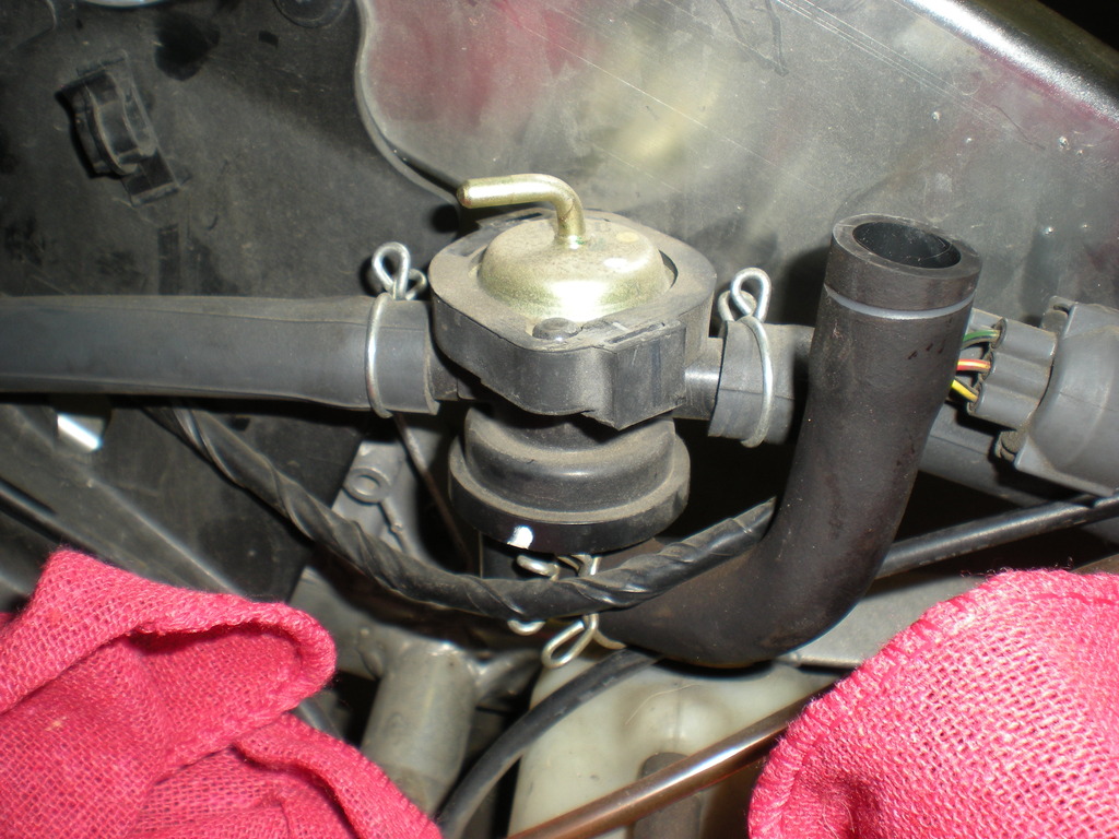

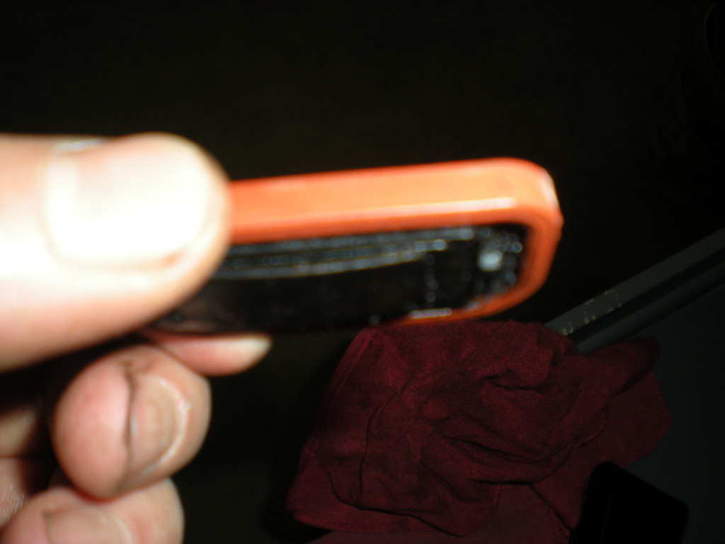

My other question is about the PAIR system. It seems like this is a pretty standard removal? Meaning it won't hurt anything? This is what they look like now so what I'm seeing is a blocked off PAIR system correct?

And then I can take this out? Or if I don't have a cap for the airbox where this connects should I just leave it? Name:  DSCN0354.jpg

Then I read to just re-route the hoses, can I just remove them and cap the little inlet on the cam cover or should I just leave those hoses 'dangling'.
About the PAIR system, you can remove everything. Just plug the holes on the valve cover or buy the block off plates that members here sell (eBay as well). Also plug the hole that goes to the airbox.
You will want to leave that piece with the orange part inside the valve cover, since the orange part is the gasket.

CruxGNZ: Got it, it just seemed like(call 'em an acorn nut, nut, and fluted nut) the nut was really tightened against the acorn so I assumed it should stay there to hold that on, I'm def going to take off the acorn when I get the others tightened down so I don't lose that. I'm sure it's generic but I don't need that bouncing around at 70.
So I got that, but do my lengths look good on the bolts?

NO! The jam nut or locknut must be tightened against the nut on the body of the CCT (towards the engine)
Yup I understand that now but do my lengths look ok? When you were explaining to the other guy you said about a half inch on the rear and double that on the front. My front seems like it's going to be out more than that.

You can not use the external bolt as an accurate tension measurment. You should really pull the covers and check the chain "up and down" free play. (5-7mm I believe?) Other members were commenting that when the tension is checked, on a typical VTR, there will be about a 1/2" of threads showing on the rear Krieger bolt. Mine has less for some reason.
But eyeballing the threads is not a reliable chain tension adjustment method.
Hangfly and Hondahawk, since I never installed Krieger CCT's before, I stupidly assumed something. I assumed the nut against the CCT body was actually part of the CCT body. Please disregard my above statements about the jam nut.
If the body of the CCT is threaded, then the nut against the CCT would be the jam nut. Looking on another monitor (I was on my phone the last few times and couldn't see very well), I can see that the acorn nut is not staked, so the thinner nut is the jam nut for the acorn nut. You in fact had it right and I am a real putz! Now I know what you meant about removing the acorn nut so it didn't fall off at 70.
I appologize and I'm going to delete what I wrote in my above post.
I understand Krieger CCT's come with really good instructions. Just follow those.
Yea, I really don't wanna take that front CAM cover off...

Then the best bet is to thread them in finger tight and then back off a bit. The amount (fraction of turn) to back off depends on who you ask.
