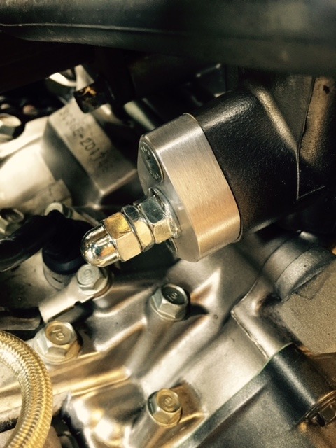

PS. This is the correct site for krieger CCT's right? I guess its linking the header. Krieger Cam Chain Tensioners
Old Mar 23, 2015 | 06:43 AM
Hangfly's Avatar
Joined: Mar 2015
Posts: 409
From: Central CA
"Yea, it seemed to be solving more of the low-end problem rather than my mid/high end, plus I hope to keep adding aftermarket parts on the bike so the Dyno kit seemed like the best long-term solution."
You may want to read it again.
Old Mar 23, 2015 | 06:46 AM
Hangfly's Avatar
Joined: Mar 2015
Posts: 409
From: Central CA
"PS. This is the correct site for krieger CCT's right? I guess its linking the header"
Yes, just email him (bottom of page) and he will send you a quote.
I just installed mine last night as a matter of fact. I give Krieger excellent reviews based on my experience with him.
The '98 originals held up for nearly 40k miles.

Old Mar 23, 2015 | 07:12 AM
Posts: 1,994
Hangfly. Based on the photo of the installed Keiger CCTs you posted, I'm thinking that unless they come with a shorter adjusting bolt now, yours is way too tight. Mine doesn't look anywhere close to your. I could be way off on this, but it's something that gave me cause for concern.
Old Mar 23, 2015 | 07:18 AM
Hangfly's Avatar
Joined: Mar 2015
Posts: 409
From: Central CA
Thanks for the "heads up" fellow HG pilot. Krieger's instructions say to install the short one on the rear chain, but I may be wrong. The adjuster is not too tight since I pulled the cover and looked down at my work. The adjustment is "finger tight" . But I may have to swap them. I need to add lock tight any way.
Dan
Old Mar 23, 2015 | 07:38 AM
Posts: 1,994
Dan
The rear does get the short one, but I have about a half inch of thread showing. The front is about twice that. If you had the covers off and the slack in the chain was OK, then.....
Don't want you to launch not clipped in.
Old Mar 23, 2015 | 07:50 AM
Hangfly's Avatar
Joined: Mar 2015
Posts: 409
From: Central CA
Maybe my chains are loosey goosey.
Unhooked, Oh boy. Only did that once. Luckily is was during a tow and I avoided disaster.

Old Mar 23, 2015 | 08:55 AM
Dan
Since you have to pull them off again anyways, follow this tutorial here and make sure you have the correct tension on the cam chains. It really helps seeing pictures of everything.

Old Mar 23, 2015 | 01:08 PM
AndyMX47's Avatar
Joined: Oct 2014
Posts: 189
There definitely is something weird with that CCT - I have the Kreigers, and my rear CCT has about 1/2" of thread showing like Xeris does.
Old Mar 23, 2015 | 03:34 PM
Hangfly's Avatar
Joined: Mar 2015
Posts: 409
From: Central CA
I did run the threads to the very top of the acorn nut. This way I have a triple locknut. Could that be the odd part?
Do you guys run the locknut against the acorn?
