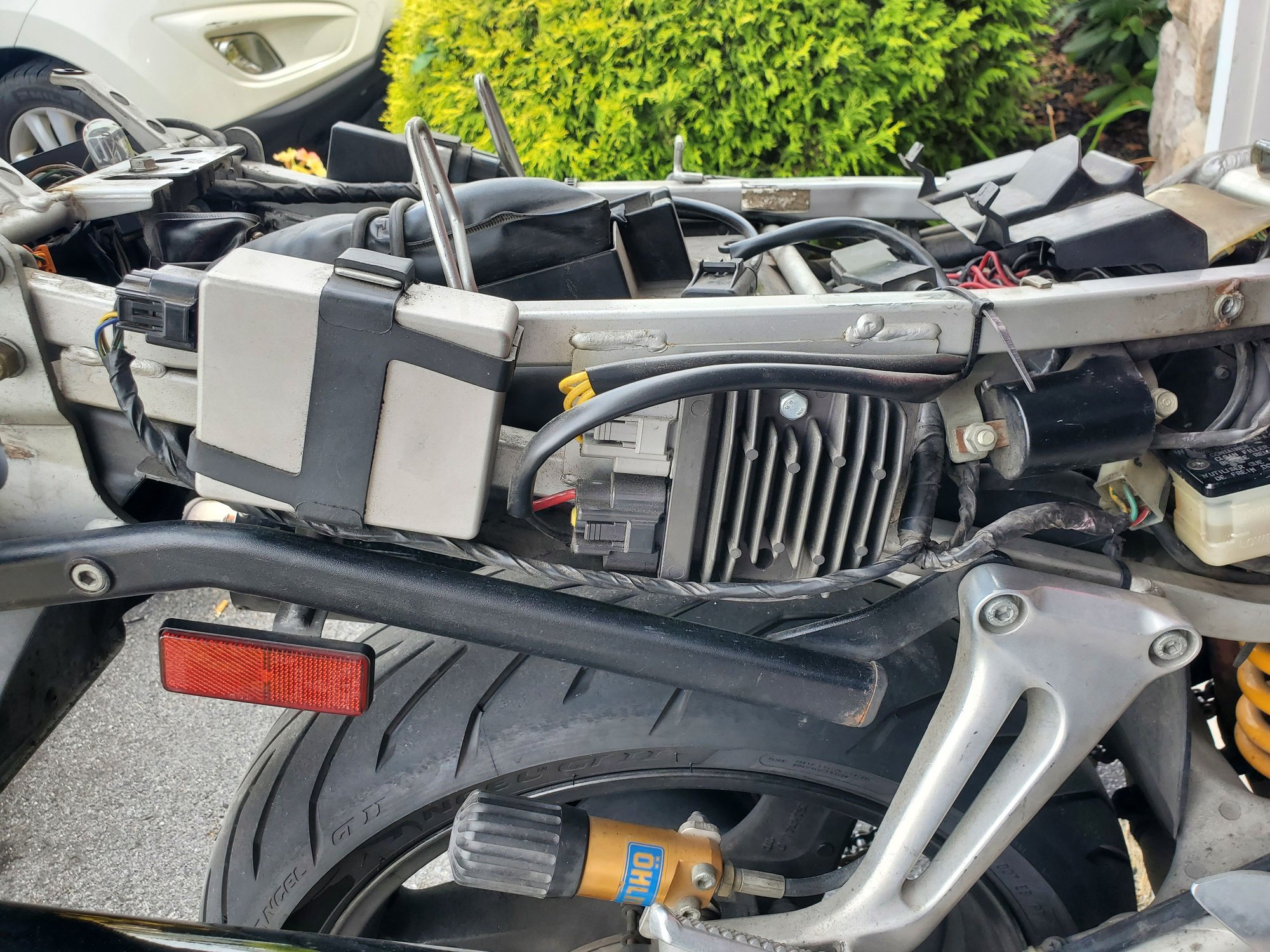

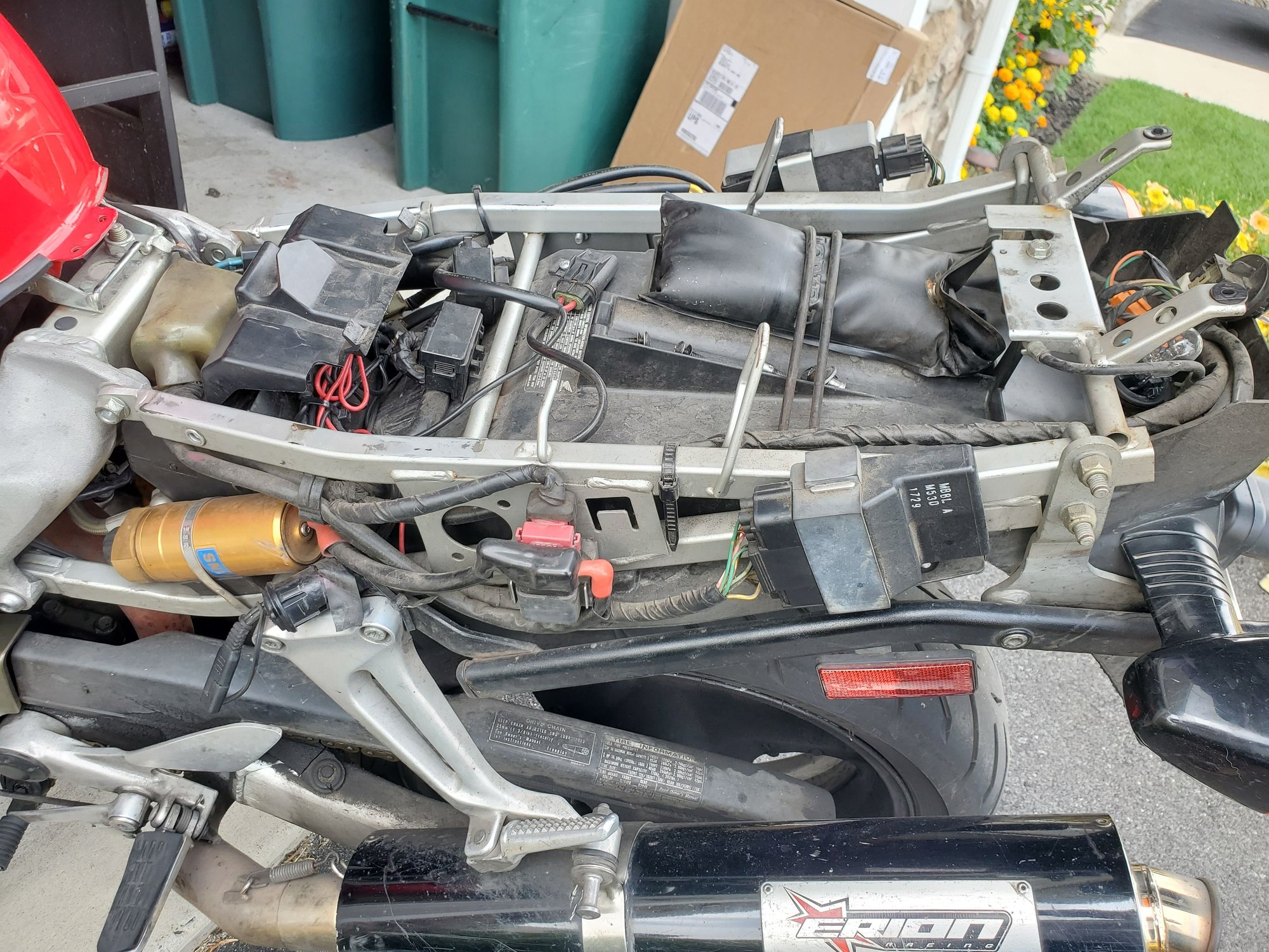

This is what she looks like....
How do I know if the Regular / Rectifier went bad?
I've checked all fuses - everything looks OK in terms of connectors to various items
