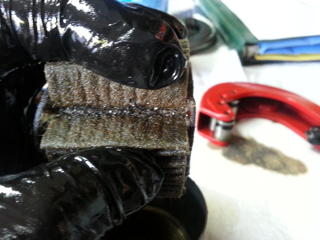

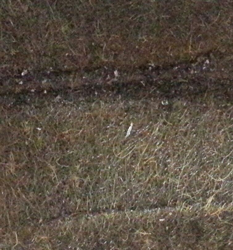

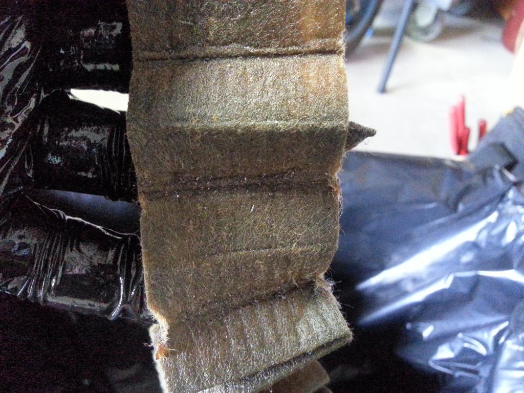

Got a chance to crack open the oil filter. All I can say is OUCH!

Couple of quick oil and filter changes in order me thinks!!

Does that look like clutch particles? Seems kinda shiney

The metal "shiney" stuff is not from the actual clutch friction material, but from the metal plates that the clutch friction material is adhered too. Those metal plates are what broke apart and those metal pieces knocking into each other is what caused the "ticking" noise I was hearing.
I took a close look at the broken edges of the friction plates and you can clearly see they were being smacked together. This is what caused the metal debris you see in my filter.
Really sucks knowing this came from my engine.
I have taken steps to prevent any further damage from this clutch fiasco. I just hope the engine lasts. If not, then the up side to this would be that a rebuild would give me the chance to install the high compression (11.5) pistons.
