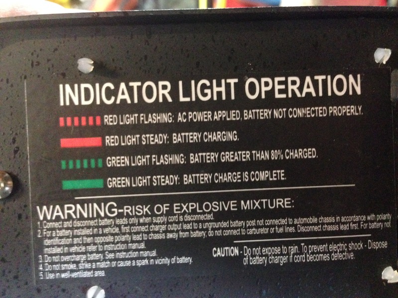

Plugged it in to the Battery Tender tonight and the tender flashes red, indicating it's not charging. Normal process is solid red for charging, flash green for 80% charged, solid green for fully charged. Not sure what's going on there. Fuse is fine. I'll check the battery out more thoroughly tomorrow when I get the DMM.
Old Jul 9, 2015 | 07:48 AM
VTRDarren's Avatar
Posts: 347
From: Western NY
VTRDarren
Double Check your connections.
