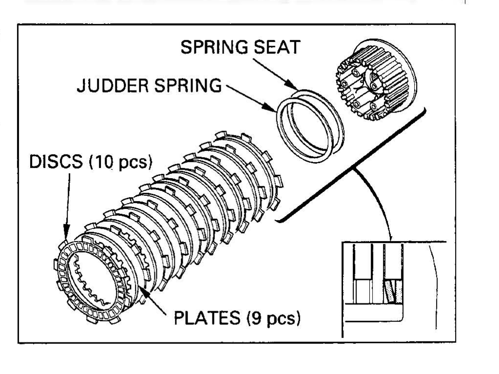

I agree with thetophatflash. You have done everything you can without pulling the engine cover off.
Look at chapter 9-12 in the manual. Make sure your clutch assembly looks like the picture below.

The only thing it didn't include was a new clutch plate spring and spring seat. Those are the two very thin metal rings that sit behind the clutch plates.
That is the probleem Put them back like Picture shows-judder spring and spring seat.

It appears that I messed up and had the last two friction plates lined up in the shallow notch at the end of the clutch center instead of just one plate. After re-assembling the clutch discs and plates it appears things are working properly. I will post a final resolution tomorrow after I have a chance to give it a more extended test ride.

I installed mine according to the picture and have had zero problems.
