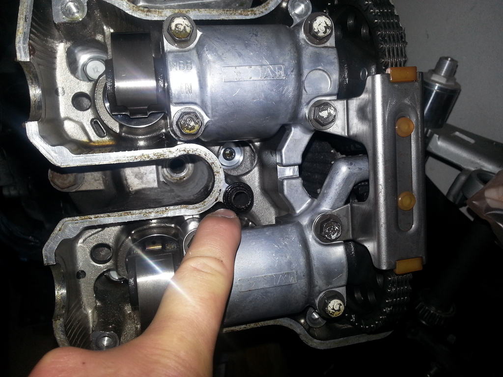

I think it is possibly this o-ring.

Yup the one in pic not metal one thank god
But i didnt mess with this bolt so im not 100% sure.
It also may be the rubber part of cover bolt.
Wow,
Crux, I was just inside my heads and never noticed that oring, I did notice the hollow locating dowel. Does that just sit around the dowel on the surface or or does it sit in a recess ???
Old Sep 14, 2016 | 07:35 PM
Just sits around the dowel. The dowel could be inside your valve cover with the o-ring around it as well.
Make sure you have that o-ring. The oil comes from the engine, up into the valve cover and onto the cams.
