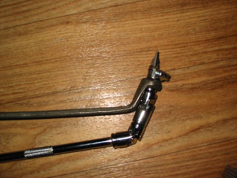

Yeah I went to the trouble of slotting mine as I replaced the plastic choke collars with the brass polaris models. Figure I can use 1/4" socket extensions/ universal joint and a slotted bit to turn it
Old Sep 28, 2011 | 04:52 PM
Ok so forget that, even slotted I cant get at them to turn them while the bike is running. Can I use this tool or do I need the right angle motion pro that is gear driven?
NEW!! LISLE CARBURETOR CARB ADJUSTING TOOL #55250 | eBay
It really depends on how flexable that line is.
The pilot settings should be smooth and easy enough to do with little finger effort so you wouldn't have to worry about having the line snake and twist under torque, but the radius on the bend might be a little much with the head coolant lines right there.
And since our pilot needles have no shoulder covering the screw, I have a sneaking suspicion that if you put that on there, the bit would just pop off of the head and you'd be S.O.L.
You could J.B weld a small finger adjuster, like an 1/8" extension, but I don't know how small your hands are to fit on there.

Ok so its hugely poping on decel & even steady throttle at lower rpm. I am going to lean it tomorrow with the needles and maybe turn the fuel screws. I cobbled some tools together since I really want to turn them when its running.
I ordered this tool since its a right angle and looks like the tool for the job
BIKEMASTER EXTRA REACH ADJUSTMENT SCREWDRIVER | MotoSport
