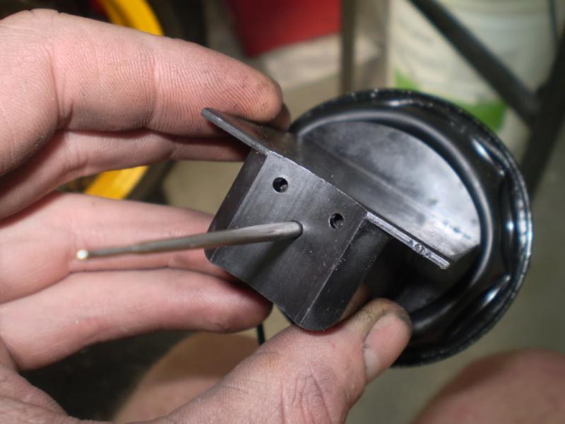

ok one more problem to the puzzle after further inspection between the new jets and the old jets they have been drilled i dont know to what so i dont know were to go from here for a new size
Old Feb 17, 2011 | 06:23 PM
  #34
So there is one more hole than this pic?
Also the spring I was asking about is the long one that comes out when you remove the cap to pull the slide out.

yep one more hole lower left corner the other spring is 5.5 inches long

The third hole in the slide is a DynoJet kit mod. They do it to get the slide to open faster. This works on many bikes but on this bike I don't believe it is the way to get it to run its best.
They are no problem though because if you go with a different set up you can just epoxy them closed and not have to replace the slides.

ok sounds great so i will start getting stock parts but my concern is still the extra hole in my slide whats your thought
