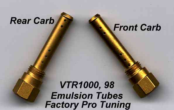

Also one more thing to check while you are in there. On this bike the emulsion tubes are different on each carb. These are the parts that the main jets screw into.
So to make sure someone didn't mix them up (and to make sure they are clean) pull them out and check them.
Here is how they should go:
notice the small holes on the body are in different locations.
