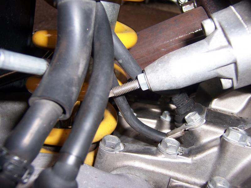

These are the MCCTs that came on my bike. So Im correct in thinking to check they are adjusted right I undo the locking nut and wind the inner screw in untill its tight then back out 1/4 turn?
Cheers
Old Apr 29, 2014 | 10:53 PM
jscobey's Avatar
Posts: 834
From: Thousand Oaks, CA
open the rear cam cover, and check the slack on the cam chain. it should be 5-7mm. the whole "finger tight and then 1/4 turn back" and all that is very random. best to just check the slack on the chain and make sure.
how many miles are on the bike? id leave them alone because they are probably fine
26,000miles. Nothing makes me think there is a problem just I dont want to be the guy that says "I should have checked my MCCTs"
I had been hearing a rattle when riding today which brought it to mind but found my chain dragging on the LH pipe. Its due a new chain and sprockets as it has a big tight spot. Seems the previous owner was not big on chain lube. Bike now has a Scott Oiler.

Your MCCT's will not fail or cause problems unless anything loosens up or you meddle with them. That's their advantage. Once they're set, they need little if any attention for thousands of miles. When you take the valve covers off, say for a valve check (I think it's recommended at 28,000 miles) then you can check slack. Otherwise, like jscobey said, leave them alone!

Recently change mine but I have to agree with others here, If your suspicious of noise, check the CCT tension as suggested above. If all is fine........LEAVE EM ALONE!
I feel NO MORE comfortable with my new CCT's than I did my old ones. No one here seems to be able to settle on how much tension is enough or not. The hole FINGER tight thing then 1/4 more (less?) doesn't FEEL right at all.
But I have to admit, I have no issues so far with the new ones I installed.

Oh geeze guys. If your bike has mccts in it and is running, just make sure all the bolts are tight and then forget about them. It is not going to cause problems if it is a little off.
To feel comfortable, take valve covers off and check play in the chain between cam sprockets at tdc. 1/4" or so and you're good. No finger tight, no adjusting when it's running. If they're too tight your bike will run slow. If they're too loose you'll hear slapping. They have to be very loose to skip teeth.

I've done that too, BUT, for those who are tentative about adjustments this is hardly a confidence inspiring procedure. Too many options also makes things seem confusing too. Also, we have had less experienced members back theirs out too much and cause failure, so I wouldn't feel comfortable telling others to follow this procedure.
So, if your bike is running with MCCT's but you don't feel confident they're adjusted right (they likely are if they're in there and there isn't excessive rattling or squealing): Take valve covers off, set 1/4" of play between sprockets at TDC. Locktite and tighten all bolts. Then you can be completely sure that you don't have to worry about anything CCT related again. End. Anything beyond that is fine tuning, nit picking, and general oil thread stuff.

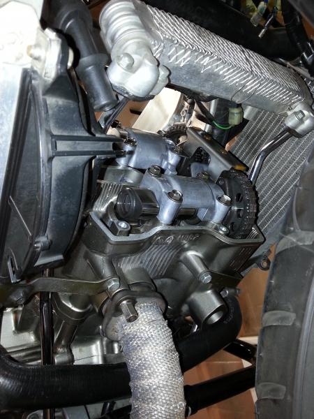

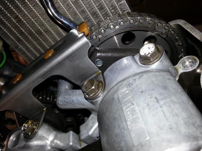

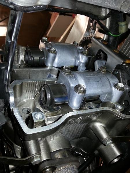

Each to their own but I hate the work required to get to the front valves. Also, in order to check cam chain deflection (I've read less than 5 mm) one must remove the 1 side bolt (of 3) that secure the "chain guard bridge" with the nylon slider. Even with rags stuffed in cam chain tunnel, it is very easy to drop that lil' bolt down to the basement, which IMO is much more scary...
When changing front valve lash shims, I zip-tie the sprockets to the chain and leave the sprockets on the cam positioned with rags in zip-lock bags (with air squeezed out). Removing the 2 left radiator mounting bolts and lowering the oil cooler (4 bolts) makes it easier to slide the valve cover out the front (it won't come out rearward, dam). Use a piece of cardboard to protect the cover from being scratched on the frame.
