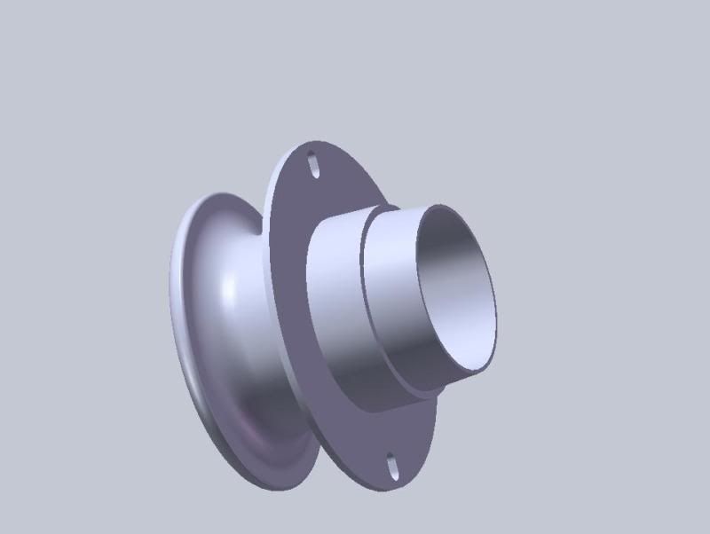

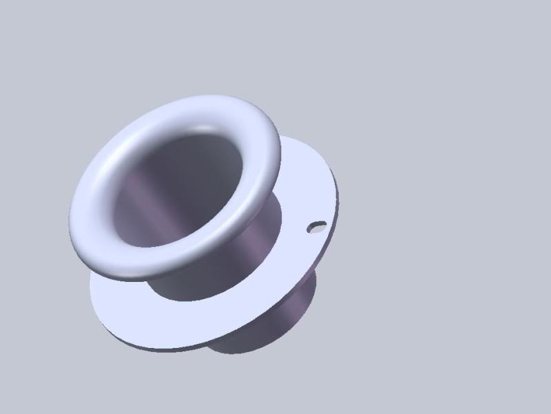

Thanks for the guys who supplied the drawings/info/models.
Here is my version of the solid model.

Just some info...
The part will start as a 4" round 3.25" long hunk of 6061 alloy. It should weigh around 4 Lbs. The finished part should weigh around 0.37 Lbs. 91% of the starting material will go to the scrap bin.

Hi Guys,
Yes, you can get tube... but it would be very hard with the wall thickness that would be needed... and, like Jamie... it's going to cost more than the solid bar. Right now... I can buy aluminum at very competitive prices since I buy a few hundred pounds at a time... and I take full 12' bars.
As far as a deep draw... you actually want the airfoil shape at the outer edge. If you do a draw... it's going to have a flat cross section, and yes... the die is going to be expensive.
Jamie...
I've been going back and forth with the mount. I can shave a little time off the lathe if I make it a separate part... but then I add time on the mill making the mount. With my equipment, I think it's going to be a wash. How were you going to attach the mount? slip it on, and use a big split ring, or have a split mount that went into the groove?
