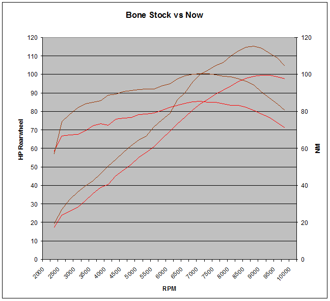

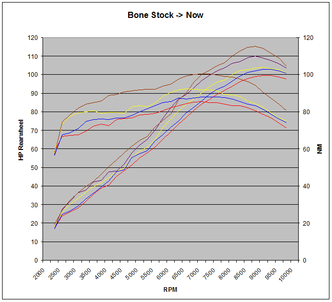

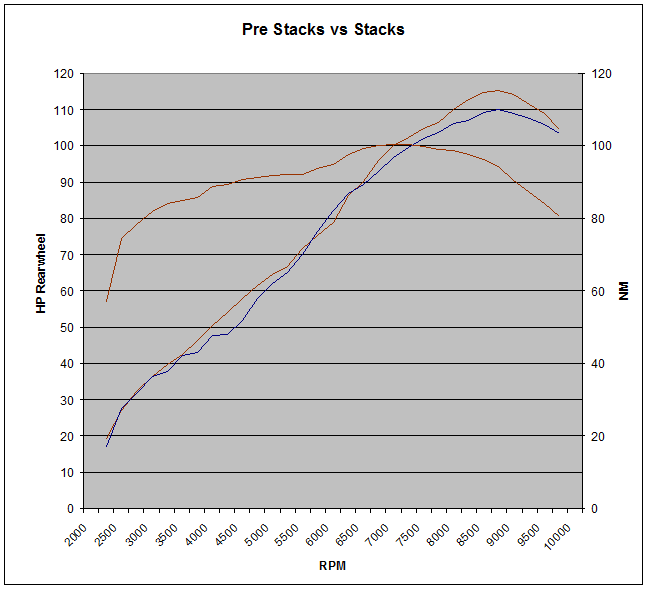

Old Feb 4, 2010 | 09:39 AM
  #254
Sorry to disturb the planning guys... I just though I'd put the issue on dyno results to bed once and for all...
Now... Before you start commenting and going all hog wild... READ THE TEXT!!!
If you fail to do this you will most likely make a fool of yourselfes... And you will kill of any and all interest from me to discuss this...
1. These numbers are from my personal dyno... I own it and I have also built it... It's not an "official" dyno in any way...
2. The numbers are rearwheel and the torque is in Nm ie it reads about 1,35 * the Lb/Ft you guys usually see...
3. No it's not calibrated... The only calibration I have done is to compare the "official" sheets two mates have gotten at the local shop after they used my dyno to tune their bikes... (3 sheets at different modifications compared to the final setup run + 1 vs 1)
4. I believe I'm reading ~1 hp high up top and about ~0.5 hp high down low...
5. My sensorspeed isn't quite as good as a pro dyno (but accuracy is as good as), so my lines will be a bit smoother as the lines are longer between datapoints...
6. These are used for me personally to compare and tune... Nothing else...
Red: Bone Stock... Before I touched anything... Basicly new bike, just broken in...
Blue: Removed restrictions in carb boots, Bafflectomy and Re-jetted to my best effort...
Yellow: Jardine Slipons and a modified stock airfilter (no lip)
Purple: Cams, Heads and Flywheel (Sorry, I seem to be missing the torque numbers... I'll go digging...)
Brown: Current... Billet stacks, FloCommander and a BMC street filter...
Comparing stock vs Now and before and after the stacks...
Oh... I forgot... The figures stock was 99,4@9100 and 85,4@7000 and now 115,3@8750 / 100,3@7250...

Old Feb 4, 2010 | 11:24 AM
  #258
Originally Posted by mikstr
You da man Markus
The improvement from the stacks BMC and F-C are nice
BTW, I wasn`t aware you had cams and headwork......
Well... Like all the rest of my strange mods I did it myself when I got boored out of my skull this winter... So it's probably far from optimal... Cams are made by a local shop that used to race a really nasty VTR in BOTT... I have a couple lying around as spares (And no I won't sell them... There won't ever be more done, as they where a one off...)
Edit: The results are incremental, but they are actually "out of order" as the cams and heads are the newest addition... It was just that like I said a while ago I had messed up my files, so I ran the dyno with the stock stacks once I had the internal work in order... Then re-did it with the stacks... So you actually haven't missed anything...
I haven't had a chance to ride it with the latest incarnation as the effin snow is still falling outside...
The stacks together with the BMC did just what I wanted... The BMC alone had the same tendancies as the K&N... It improved the top end, made a big hole in the middle and improved the low end but with uneven results...
With the stacks and BMC the bottom end got fatter/smoother and the top end didn't run out of breath as fast... In the middle at around 6000-6500 I could have gotten it even better, but then I'd have to sacrifice the top or bottom or both...
Considering the gobsmacks of torque available all over the place I choose to keep it like this... The bike is still a wheelie machine...

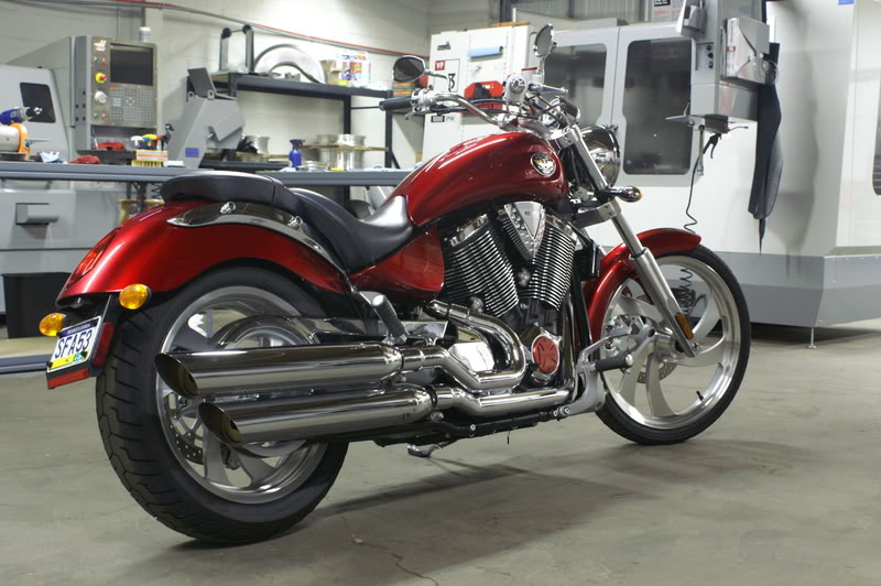

Dr Honda's Avatar
Joined: Nov 2009
Posts: 92
Dr Honda is on a distinguished road
Originally Posted by scatterbrained
Still waiting on you DocHonda. BTW, if you don't mind me asking, which part are you focusing on first, the stacks or the brace. I'm trying to plan out my upgrade budget and plan on making other changes in conjunction with these.
Materials are ordered, and will be here Monday. (should be) I need to order a cutter for my lathe to cut the backside of the stack. (should take a few days) So... the Velocity stacks should have a prototype by the end of the week. (if I don't get hit with other work)
I'm going to play with the model a little more on the brace... but I will start it next week also.
So... I'm going to be working on both projects at the same time. Right now, I don't have any major orders for production for next week, so it's a safe bet that they will both get worked on. (Monday morning always changes that though)
Lastly... don't worry if you don't have cash for both parts, or just aren't ready to buy. (I think I've said this) but I own the shop, so I will make them on demand. Also... I'll always make a few extras when I run them, so I will probably keep one or 2 of each part on the shelf.
