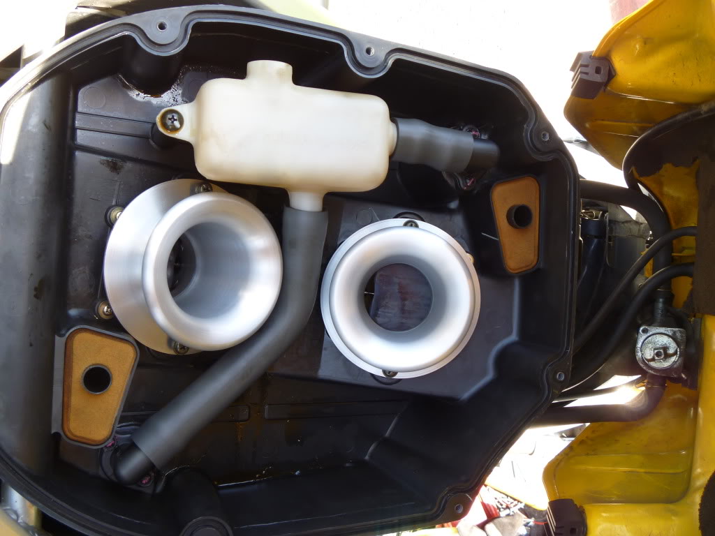

I finally got up the urge to put mine in today, it took all of about 30 minutes to complete the install.
There is quite a bit more top end speed and also more butt dyno bottom end torque
Old Apr 10, 2010 | 05:19 PM
  #294
Glad to see you're riding, Manny! I rejetted, added the stacks, and did the Ignition Advancer all at the same time. The mechanic says "crazy fast" - the kid (40 yrs my junior) just shakes his head when I bitch about fuel economy and walks away smiling.
Like I said in another thread - when they told me about the brakes and the suspension it would be like a whole new bike. They were right.
This is equally huge and the stacks are the biggest part of the punch. No jest - from 40mph to over a 100mph with a gradual roll-on in 3rd. In about 150 yards at most.
