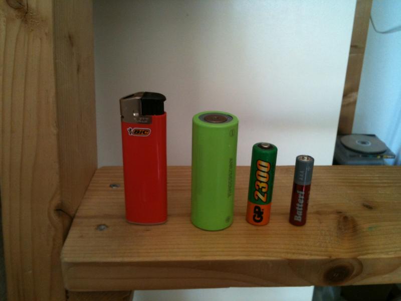

Originally Posted by uchi
im very impressed that these little double a looking batteries are that powerful. if i didnt have a brand new battery id have one of these. infact when mine dies im gonna end up with something like this, maybe see if tweety has the resources to make one when im ready
maybe its been discussed and i missed it. how do these batteries react to the rr when it goes bad? will it kill them? and what do you think the life is like before the battery stops charging properly or holding a charge? i know the with lithium cell phone batteries theyre great for a while but slowly hold the charge less and less. is it the same with these things? and you had mentioned unplugging the battery for the winter and not worrying about using a battery tender. how long is too long to leave these connected to a bike without using them? if the bike sits for a month or a few weeks with this thing in it should it be un hooked?
im sure some of this has been answered but my brain has slowly melted from trying to wrap it around all the numbers and specs and things i dont understand being thrown around by you guys, lol
Actually uchi, they are a bit larger than AA cells... Closer to C cells in width but longer... Actually if you are a smoker, a good reference is a standard BIC lighter... It's about that long and roughly the same width as the widest part, but round...

uchi... Size reference... One AAA, one AA, a LiFePo4 cell and one BIC...

thanks for the clear write up and pics tweety. had i known about this before my last battery died i would have gone this route. being that its a yuasa its bound to explode mid season again so ill get a hold of you for one of those im sure, lol
