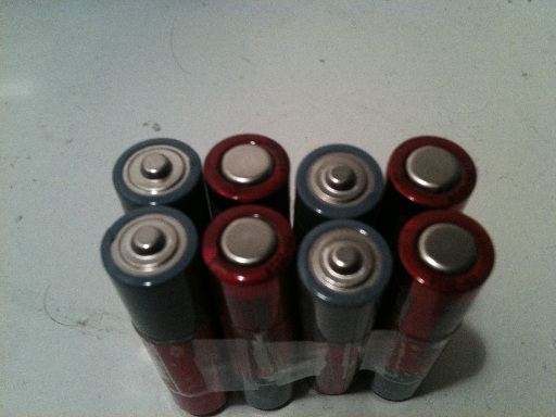

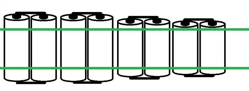

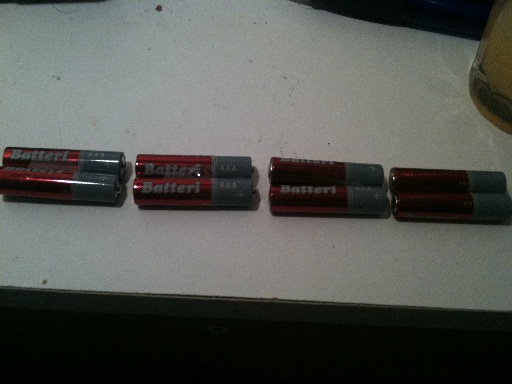

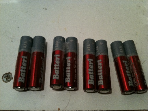

Even so, great idea... Lets do this with images... I'm using AAA cells for two simple reasons, one I have them lying around... Nad two it's easy to see wich way I turn them since they are not uniformly green... (BTW, yes I know AAA's are just 1.5V...)
These two cells are in series, making 3.3 + 3.3 = 6.6 V...
Here each two are in paralell, still making it 3.3V per pair, but with double the amount of energy...
These 4 cells are if you imagine buss-bars across + to -, a 4 cell string in series making 13.2V...
And this is the final pack configuration, the same as before but pairs connnected across both poles first, then the 4 packs in series like the image before...
Her you would have one wire coming out of each of the outer pairs, making the positive and negative pole sit on the top, each end...

So on the last two images, with the packs in series, you're only connecting one side of each battery (pack) to the next in series, correct? So the end result would be that it would essentially be the same as your first picture, just lined up in a more convenient way for our use (and four instead of two)...
Or are you connecting both sides of both (packs of) batteries... seems to me like this wouldn't work because everything is connected to everything and there would be no positive or negative pole anymore...
Old Dec 15, 2010 | 06:03 PM
  #123

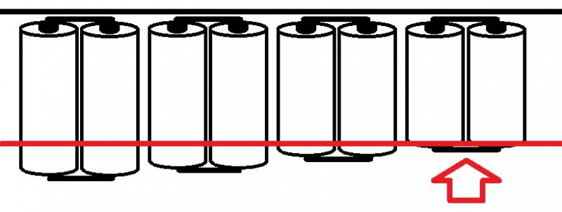

Half right... Picture three is a longer string of picture one, folded, just like you say...
Picture four is doing the same thing, using the pairs in picture two instead of individual cells... An each pair is connected at both ends...
Ie, you take this...
And "fold it" into this...
When you make pairs like this, and connecting both ends (+ to + and - to -) you are just making two small 3.3V cells into one larger cell, still the same 3.3V... Think about it in terms of water again... Two pipes along each other holds the same amount of potential, ie the same height, but double the volume... Put the two pipes together into one long pipe and you are making the potential higher, ie greater height, but here the anology isn't working 100% since you still double the volume with the water... Electrically you don't... Voltage increases but not the "volume" as in Ah...

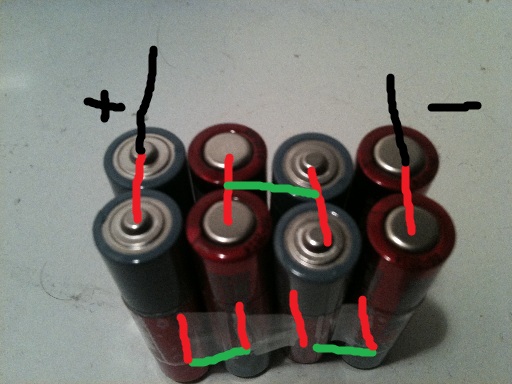

Attachment 10668
Attachment 10670
This might help
Red is hooking the battery cells up in parallel increasing the capacity or amps the cell pack can put out. there would be a red connection at the bottom of the cells also.
Green is hooking the new cells up in series increasing the voltage of the cell pack has also with connections at the bottom.

Originally Posted by Stumpy
This might help
I also have a question. can you just modify a dewalt charger to balance out the cell pack. sounds like that would be easy to do cut and extend the wires add clamps and should be a done deal. or maybe take the top of an old battery that you could just put in the charger with the extended wires with clamps on the end.
No, actually not helping... Sorry, but that's not right as in that picture... If you hook the same + end as the cable to the - cell beside it, the result will not be 13.2V... And is you connect all 4 across both top and bottom, you just shortcircuit them...
This is a correct image... The lines at the bottom are kind of "see through"...
Yeah, you can probably modify the DeWalt charger, but that is making things more compliated than it needs too be since you don't know how it works...
But if you do the configuration like we have talked about, you have essentially turned 8 cells in 4 by pairing them in paralell... Then just about any charger&balancer unit for RC products can actively balance it, as long as you pull out the wires for that... It will take a lot longer than the quick charge, and doing it that slow more than very periodically will damage the cells in other ways, but certainly doable...

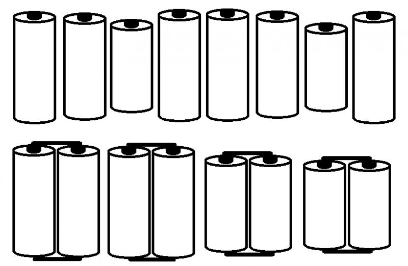

Well... Since we are discussing balancers and chargers... Let me make it more clear what I'm talking about when I say you don't need a balancer when using it on a bike...
This is where we start, with 8 cells... They all have different capacity... Ie they aren't completely identical... Now as I'm making a visual representation, I'm obviously exagarating the difference so it can be seen... Real life % is smaller...
What we do then, is to match them up in 4 pairs that are as equal as possible (or for the quick and dirty, just pair them)... The two cells paired together will balance each other... When one becomes more charged than the other, that transfers over until they are both equal... The transfer is small and completely harmless... It also means that they run out at the same time since they will be in balance at all times... But these pairs all have different capacity between them... One pair will be the weaker pair, running out before the others...
Regardless of that, we string them together to make a 12V equivalent pack...

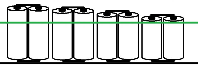

Now that we have these 4 pairs, we string them together and charge them up...
If we charge them on the bike, they remain in the same balance as when they started...
If we put them on a balancer & charger or use a BMS system, they get balanced... There are two ways of balancing the cells...
Top Balancing - meaning they are even at the top end, all of them reach full at the same time... This is the easy way of balancing stuff... You just bring out a wire from each cell and charge them indiviually until all of them are completely full...
This is the way DeWalt balance them... This is the way a lot of people balance them...
And this is in my mind about as intelligent as setting them on fire with a blowtorch... You WILL end up with damaged cells sooner or later...
There is a reason why people do it though... This is the only way you can balance cells while charging them...
The reason you will damage the cells asre pretty obvious when you look at a visual image of it... Topbalancing means the top end is level... And that means the bottom end is jagged...
The cell with the least capacity runs out first, but there is still energy in the pack, so it keeps pumping out power... That means the now empty cell is destroyed...It is used as a conduit for the energy, not delivering energy... That means you reverse the polarity of it and it becomes useless... In a 4S2P soldered pack that means 2 of the 8 cells are now just along for the ride as dead weight...
If you keep it inside the green lines, no cell ever runs out... No cell is ever charged to 100%... And no cell will become a conduit for the other cells, making it reverse poles...
So how do you do this? It's easier than you might think... Charge all cells almost full, and cycle this with discharge two or three times to make the chemistry active and all cells be "awake"... Discharge them until they are all completely the same, ie at the bottom knee... 2.8-2,9V is safe... Pick a number and make them all the same... Then charge them all to the upper knee, ie at 3.4-3.5V...
Now solder them together, stick them in a bike and go riding...
As long as you ride the bike, ie not torture it on a dyno, let it sit an idle on the sidestand with the highbeam on or whatever dumbass move you can think up, it will never run flat and never charge 100%... It will stay in the safe zone, and the cells will never be damaged...
If you accidentally run it flat, charge it a little, to about the middle of the charge curve, start the bike and go riding... The cells are now bottom balanced... Whohoo! good for us... But they will slowly drift towards middle balance on their own... Ie small differences...
If you however put the pack on a charger and fill it up... Well, we did figure out that top balancing was a bad idea, right?! So don't... OK?
Old Dec 21, 2010 | 08:32 AM
  #140
End result... You don't need a balancer... You don't need a fancy charger...
You do however need a "dumb" 14.4V 0.5-5A powersupply for emergency charging... A basic cheap as dirt SLA charger with no buttons what-so-ever that provides above 0.5A qualifies...
And if you want to be extra safe... You need balancing taps on the cells so you can do that same balancing act as I described above for assembly once each season or soo... For that you need a top-balancing charger with individual voltage control and an adjustable cut-off... Ie run the pack down to below 50%, charge it until each cell individually hits the knee, not 100% like all chargers comes pre-set for... Such a charger cost enough to buy you three packs...
I can however build that balancing circuit as a passive, manual one... And you can use it manually with that "dumb" charger... Like I said <$20 for it... But do you really need it? Nope...
My own personal pack has the balancing taps, for testing... It has kept to middle balance pretty stubbornly throughout it's lifetime... And the only time it need a little help was when I deliberately tried to kill it... Running it flat by mistake from the PITA killswitch only meant it needed 4-5 riding cycles to get back to it's own internal balance...

so tweety when you construct the packs yourself you match the cells right? what if the cells were not matched well? does your safe margin , the "middle zone" become a smaller range that you can stay within?
Old Dec 21, 2010 | 11:18 AM
  #144
Yep, I match them as best as possible... The thing is, when I do this, I order 50 or 100 cells so I got a few to choose from and I'm working with cells of good quality... Plus I match the pairs as good as possible, the result is that some packs have a slightly smaller capacity and others have a slightly larger, but the difference is almost unmeasurable... The reason is that I value the balance over the actual capacity since the difference there is small enough that it's not making any difference in usage, it probably equivalent to 2-3 seconds of running your headlight...
The effective safe range for a cell is roughly 90% of the capacity... Ie the top and bottom 5% is "unusable"... If you want to increase battery life, you make that 80%, making it 10% each end... With a charging system in good working order, you will stay above the bottom 10% without any problems unless you mistreat the pack... The top is the same, as long as your charging system isn't overcharging (Bad R/R) or you manage to do long hauls at contant throttle, maximum efficient RPM for the R/R... Which would mean one stupendeous coincidence...
The actual variance on the cells I have measured are less than 2%, mostly around 1%... So with good quality cells the range is basically the same... With DeWalt cells, I'd say it's possible it's going to be a bit more, say <5%... Still within the margins...
What does become a problem is that with a DeWalt pack you have less cells to work with... So yeah, the band is a bit more narrow... Also, your methodology and tools for measuring... Like I have said before... I'm an EE, and I have a bit more accurate tools than the average multimeter to use...
But if you do charge them cell by cell, like described, at constant current and voltage and measure the time to charge knee-to-knee, you get a good enough number for matching them up... That makes the pack hard to kill, but might not give you the last Ampere minute or so of capacity...
BTW, the short answer... Yes, but the difference is very, very small if you do it right, and resonably small even if you just slap them together... The effective safe zone is the middle 80% of the smallest capacity pair...
