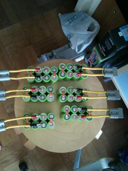

Well, I made a pack for each of my three bikes... And stuck a few in my RC helicopter... And the rest is in the process of becoming packs for a couple of the members of the Swedish VTR forum... Buying less than 10 of them at the time is stupidly expensive... And the more you get at the time, the better...
Old Apr 2, 2010 | 12:28 PM
BTW... Instructable... Why? Solder them up 4 in a string to get a 12V equivalent and then double up for a bigger bike like the VTR... Only tidbit you need to know is use a big cable (#9 or #8) or it gets hot when starting and don't short stuff... Wrap in big shrinktube and it's done...

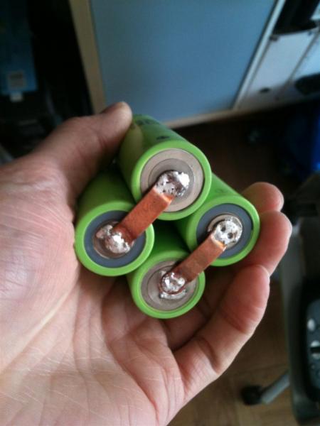

2300mAh cells... This is the one in there now... One of it's bigger brothers are now just riding along as backup...
Basicly the 8 cell packs are 2 of the 4 cubes tied together... I wanted the positive and negative wires together and not at each end as two flat packs would give me... Makes it easier to seal them in shrink tube... And while I was sitting there making 4 cell blocks I kind of got curious how long that would last... I kind of didn't believe it to be enough as Turntech only recommends them for smaller dirtbikes... But it not only starts a big twin once... It does it over and over and over again...
The thing I'm trying to figure out now though is how it likes being charged for long periods in the bike... Like me going for a lil cruise down the freeway... Full tank of gas, full battery... Start the bike once and then it gets charged while running... Empty tank of gas, and how is the battery feeling? So far it has handled that fine... Along with several trips in more squiggly areas...

You got me curious... (Yeah, like that's hard to do...) So I tried 4 1100mAh cells... And to my own surprise not only did they start the bike... They managed to do so 3 times in succesion and could probably have done it a few more, but where starting to feel a bit more than "warm" so I quit torturing them... 8 of them had no problem going for several more times...
Damn these things keep surprising me on a regular basis... It's like trying to start a bike from 4 penlight cells (or that's how it feels!) And the damndest thing is it works... No real problem, just push the button and wroom... The weight of these things is really ridiculous compared to the behemoth lead weight in there before...
Oh... BTW... An 8 pack of the 2300mAh cells turns over a rather high comp and not entirely standard 426 hemi... That car has never ever started on the first try before... With that pack in it it takes three rounds on the starter every damned time... (needs that to build heat in the pack and fuel pressure)
Altough I think I might make an 12 or 16 cell pack for it... Either that or I might try the larger 38120 10Ah cells... 4 of those should be plenty for any car...

I'll recommend 8 2300mAh cells... So far testing has proved that they are slightly oversize for starting needs but has better kick when it's cold... 4 of them works 9 time out of 10, but the 10'th one isn't fun...
I use 8# gauge wire and a 50A Anderson disconnect and that's plenty oversized...
