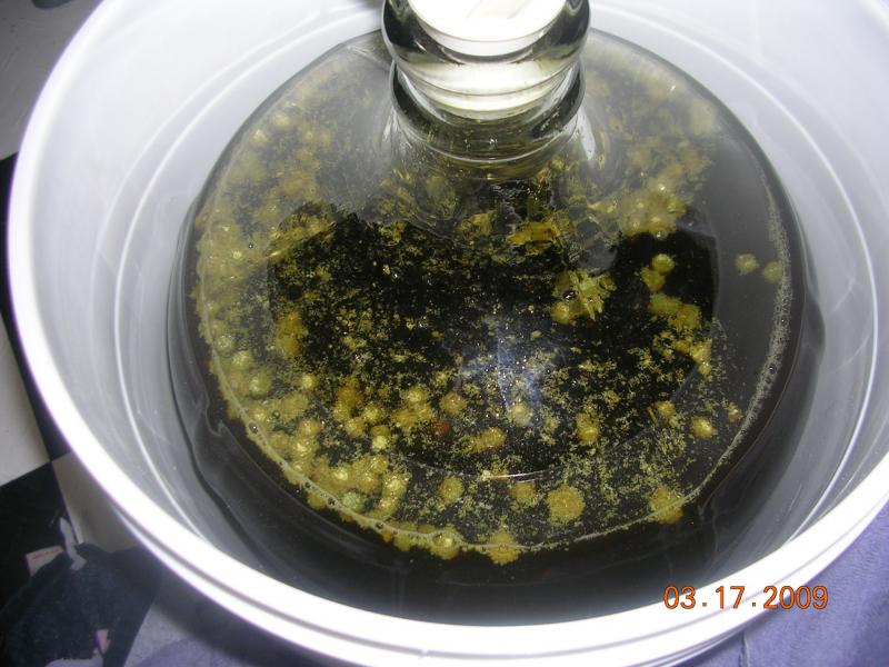

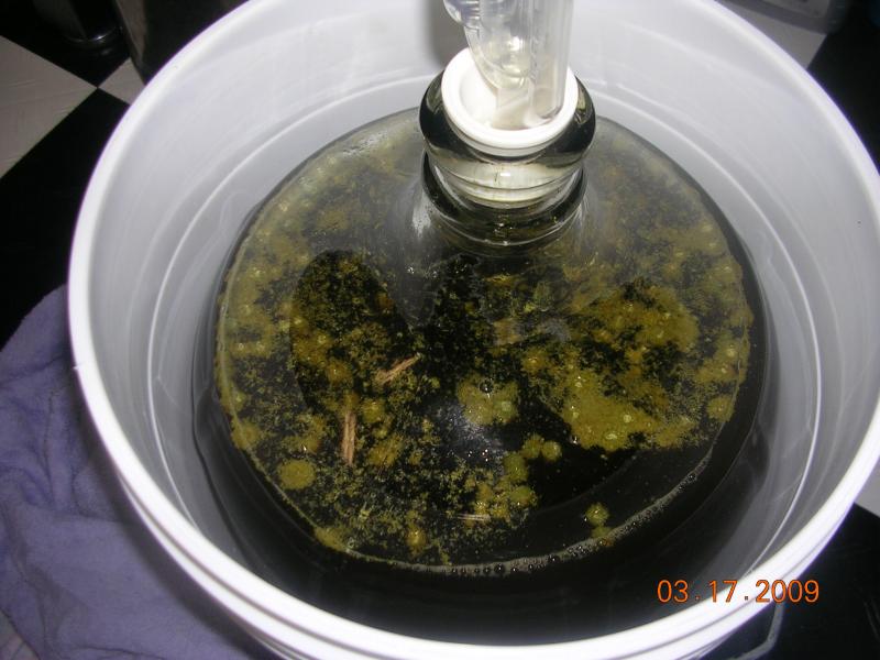

After 4 months in the secondary fermentor I figured it would be fitting to dry hop my double IPA (named "A Whole Lotta Rosy") tonight on St. Patty's Day!
Happy St. Patty's Day to all!
Added 3 oz of pelletized hops and she started bubbling again through the air lock...was 7% OH when I checked the specific gravity 4 months ago, so I'd say she's headed on up

4 months ago, you might have a bit of oxidation going on. What are is your dry hop and what IBU are you shooting for? I myself have been brewing for 15 years, all grain now.
Good to see another homebrewer is on the forum.
100 IBUs added Cascade & Crystle, I'm thinking it's cuz I stired up the yeast on the bottom cuz no bacteria can live in 8% OH can they?

Kind of looks like something I shat out after eating the Prawns in Thailand

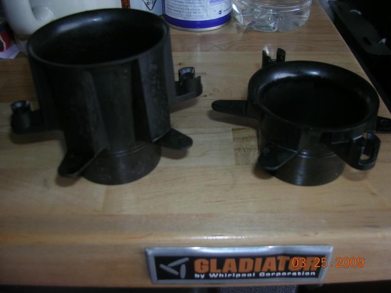

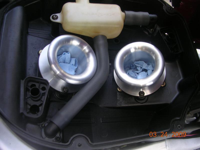

Long Velocity Stacks
Installed long billet velocity stacks and K&N air filter and I can really tell the difference! 9K rpm comes on so fast it's like I never even knew it was there before
Attached Thumbnails Time for Stage I-03-25-09-001.jpg   Time for Stage I-03-25-09-002.jpg

can I request a down the throught WOT shot please? I guess not since its all buttoned up.

Tried the airbox mod that removes the cross member inside the top (2 screws), but it didn't work with the K&N and long stacks. Not sure why, but guessing there was just too much turbulence...I cut the fin off the old filter and reinstalled it in the cross member on top of the K&N and she rips! Shouldda done this ages ago

How do the alloy runners compare to the OEM bits length-wise? Did you change your jetting for the K&N?

Mikster, the long billet velocity stacks are both the same size and are as long or maybe a little longer than the longest OEM and much much longer than the short OEM. They have a real nice shape to them for sweet flow and I didn't have to rejet, but I'm sure my air/fuel ratios are off cuz she spudders a little more than normal at <3K rpm, but man she rocks at 9K
Rear wheel spins easier and front wheel wants to come up when grabbing 3rd
