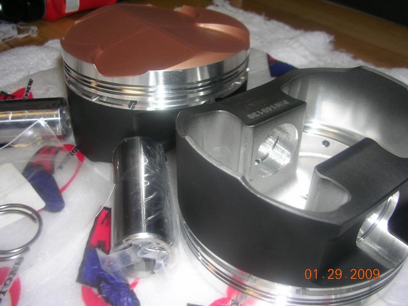

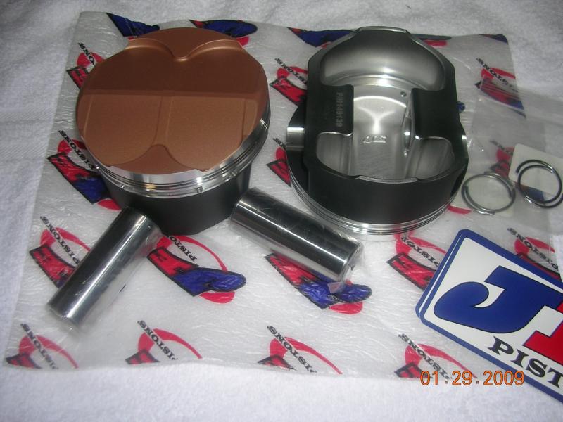

Just ordered a set of custom JE Pistons at 0.50mm oversized, so I have a set of STD 98mm 11.5:1 compression pistons, pins, clips & rings for sale. They are coated on skirts and crowns.
I paid $350 delivered for slugs and $75 for the rings. Let me know if you're interested? SOLD - THANKS ZMANIV!

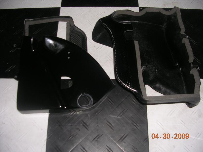

Received a nice set of air scoops in the mail recently made of fiberglass & carbonfiber to help keep the rads cool...now just gotta find time to put'm on!
Truckin, if you're in the neighborhood could you stop by and put them on for me?

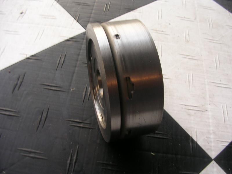

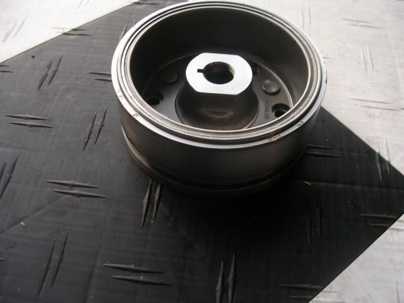

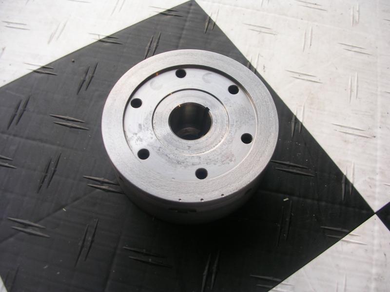

Okay, got my lightened flywheel back and here's some pics...anybody care to guess what it weighs now and what the weight loss was?
Attached Thumbnails Time for Stage I-05-15-09-flywheel-1.jpg   Time for Stage I-05-15-09-flywheel-2.jpg   Time for Stage I-05-15-09-flywheel-3.jpg

Rick, did you trim a set measure off the diameter or did you have it machined to Roger D`s specs? Mine is a Roger D version FWIW

I think the dia. is now 142mm & the width is 10mm
5.4 lbs!

Yep, stock it weighed in at 11.8lbs and now it's 6.4lbs...It should contribute nicely in the STG 1 motor
