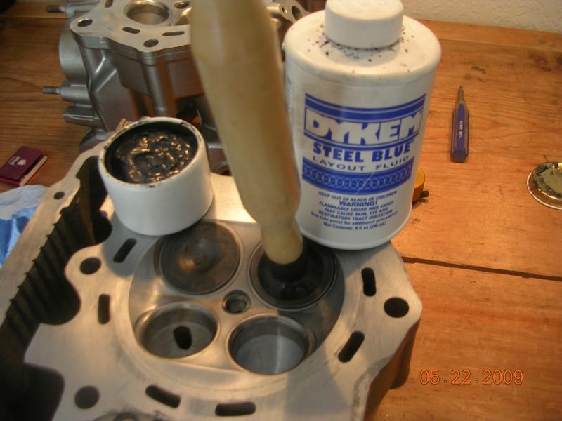

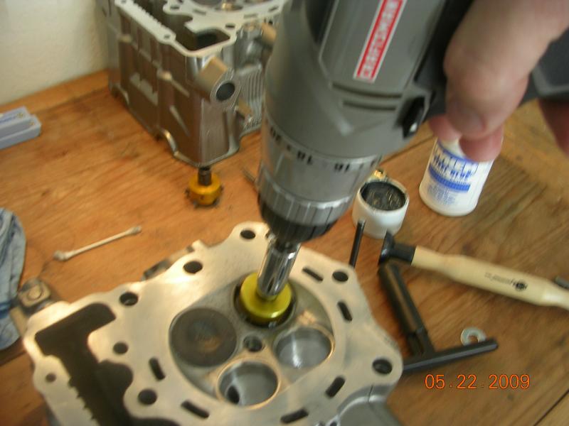

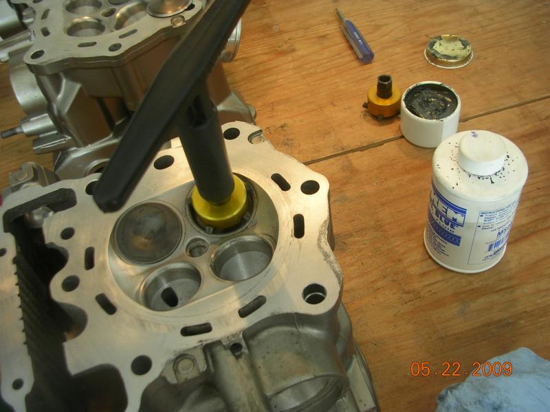

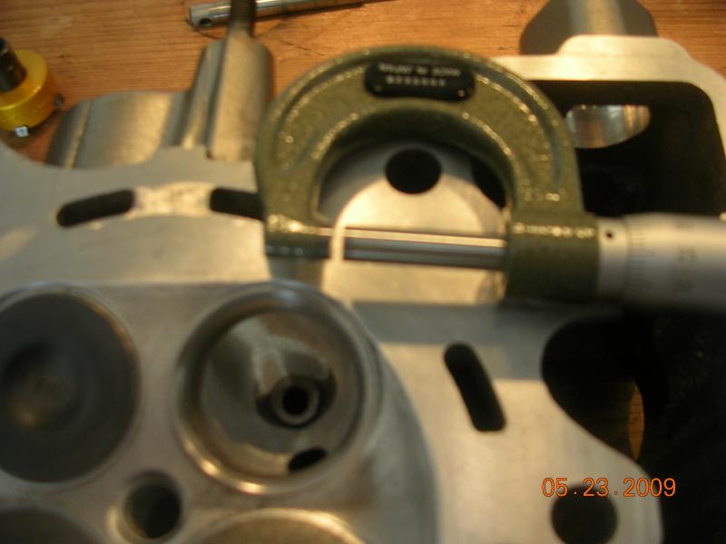

Okay, 3 angle valve seats are cut and all 8 seats are lookin sweet! This is the sort of thing you should do yourself if you can so you'd know they were done right...
31-45-60 I'll get some pics up ASAP too
The intake valves were the hardest to get right cuz they are 1mm oversized so the seat had to be moved out quite a bit using the 60 degree Neway cutter head. The exhaust were 0.5mm OS I think and they were easy as pie!
The procedure is pretty simple once you get the hang of it. Cut the seats where you think they should be and blue paint the valve and lap using fine paste then look at where the seat hits the valve and mic it for width. Repeat till they are perfect...any questions?

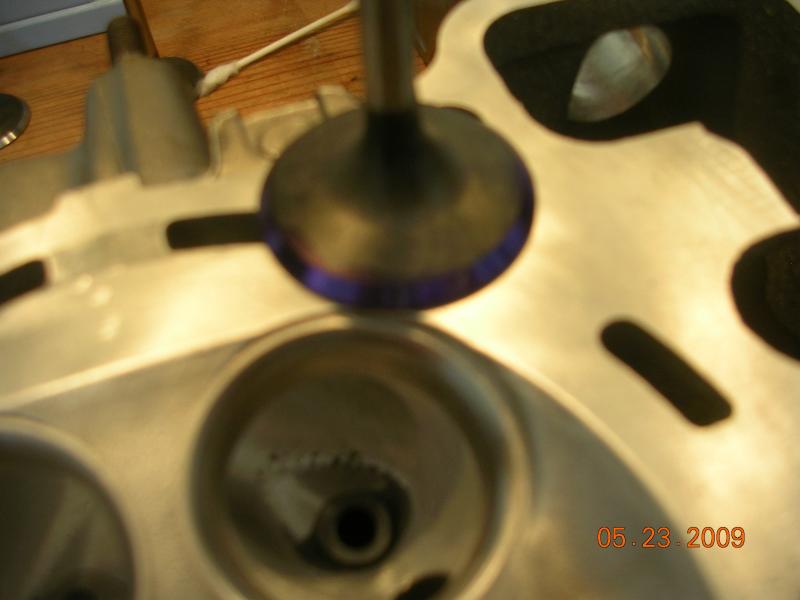

Here's some pics...enjoy!
Attached Thumbnails Time for Stage I-valve-job-020.jpg   Time for Stage I-valve-job-021.jpg   Time for Stage I-valve-job-023.jpg   Time for Stage I-valve-job-030.jpg   Time for Stage I-valve-job-033.jpg

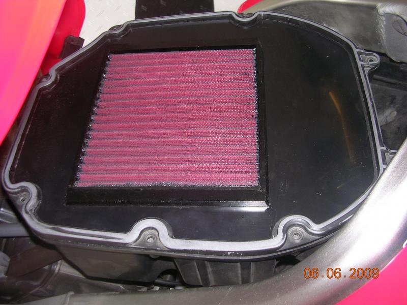

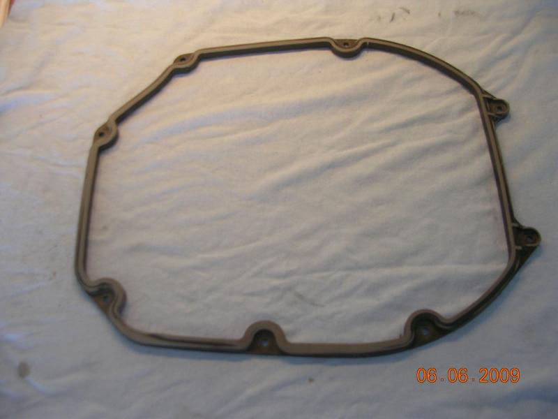

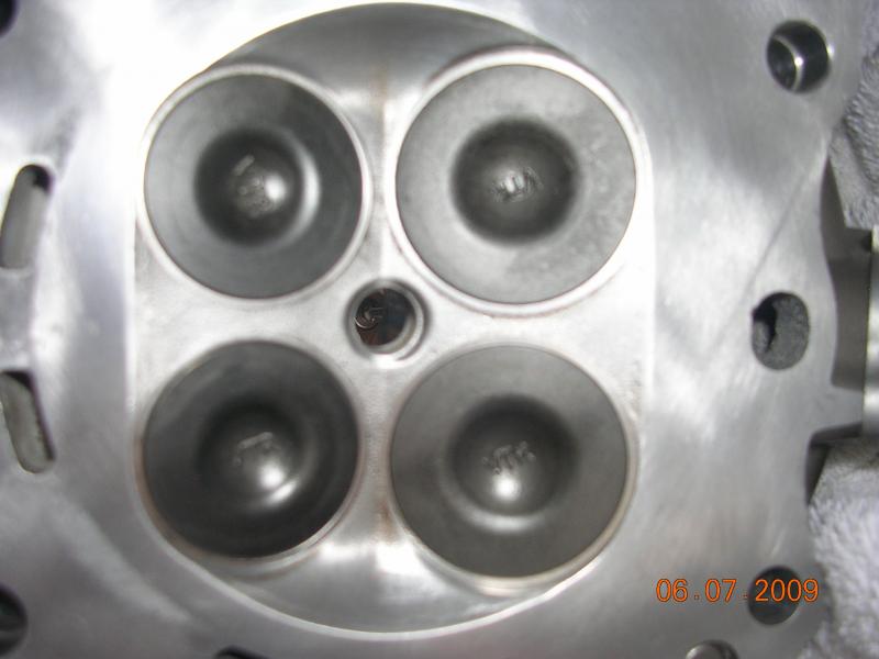

Finished my low performance 3 angle valve job for the OS Morwi valves on the ported heads and will be dropping them off today to my dyno tunner/mechanic for final assembly. Also, got the air scoops on and reversed the fan so it pulls cool outside air in through the rad instead of pushing hot air out...Also, wrapped front header in an effort to keep things cool. The bike definitely runs cooler going down the road...
Also, cut the top outta an old air box lid and installed the ring to hold down the K&N air filter and it is very evident re-jetting is needed with the open air box cuz there's lots of complaints above 6K rpms. The sound has changed too...much deeper grunt...
Stay tuned more pics to come...RC

It will be interesting to see how the tuning goes with your airbox mod.
The stock induction system has air entering the snorkel at the same pressure that the float vents see. Th fairing vents supply cool air to the region between the cylinders.
the tuning of the carbs relies on an accurate flow calibration with the vents and intake duct at the same ambient pressure. I'm not sure how removing the airbox lid will affect it.
I guess this is where you find out if your dyno tunner is worth his salt
I've done some research and found somewhere that he may need to start some where around 195 F 200 R & G3 needle with #55 slow jet, whattcha think?

It's not an easy mod to make work...... if you run into problems with it going lean in the mid range, I have a set of HRC needles that are made to run with no air filter (just more extra parts from my HRC jet kit) that I'll let go pretty cheep..... just let me know

Is that what those are for? I always wondered....
I think so. It's something I have pondered for a long time.
I finally came to that conclusion, when I made a mental comparison between the carbureted engine and the fuel injected RC51. They are analagous systems, except the carburetor uses a pressure signal to adjust the flow through the jets and the fuel injected system uses a barometric transducer in the intake tract and a manifold pressure transducer to convert pressure to an electrical voltage and uses them to adjust fuel injector timing.
Both systems estimate mass air flow and adjust fuel quantity accordingly. If the air intake on the carbureted engine is at a different pressure than the float bowl, the calibration will be off. If the ratio changes with vehicle speed, I'm not sure how you would calibrate it.

Two suggestions:
Feed the vent lines into the bottom of the airbox (use a T fed through a grommet, hook up the line from underneath and have it sense air pressure from the sides of the T located in the box), this will allow the system to stay in equilibrium (note: most carbureted snowmobile engines run this type of set-up, helps prevent teh possibility of pressure differentials developping))
As far as the jetting is concerned, as this mod was recommended by Roger D, he must be familiar with it and can surely suggest a good baseline setting at the very least.

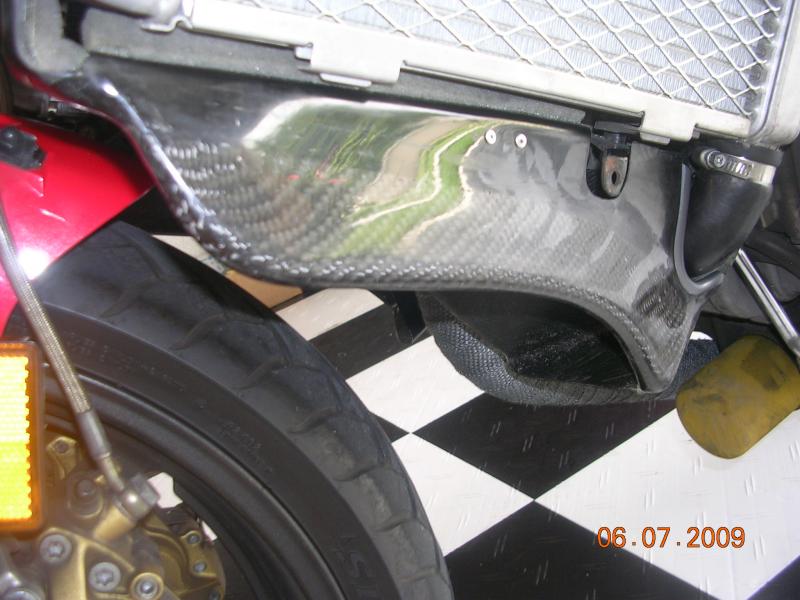

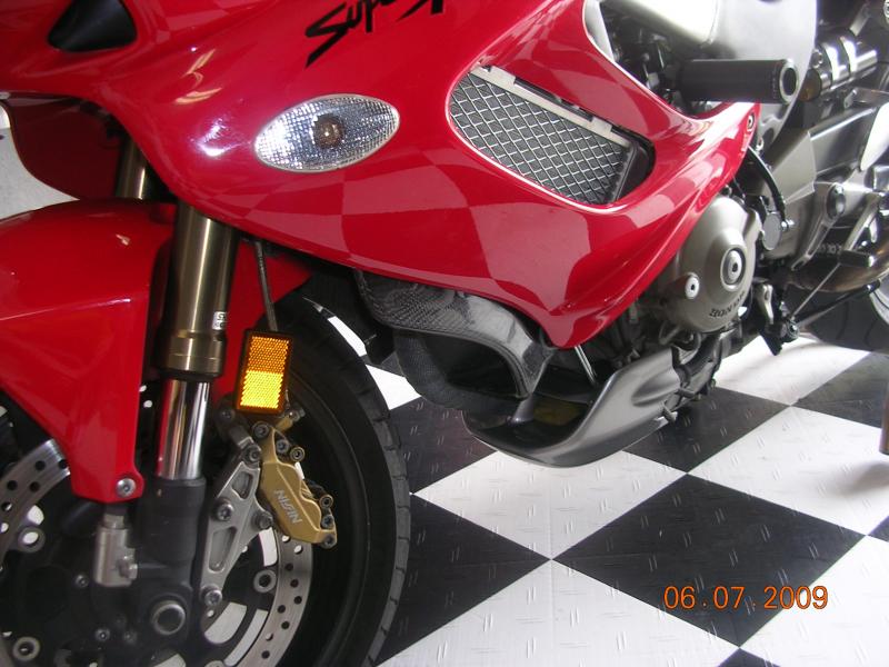

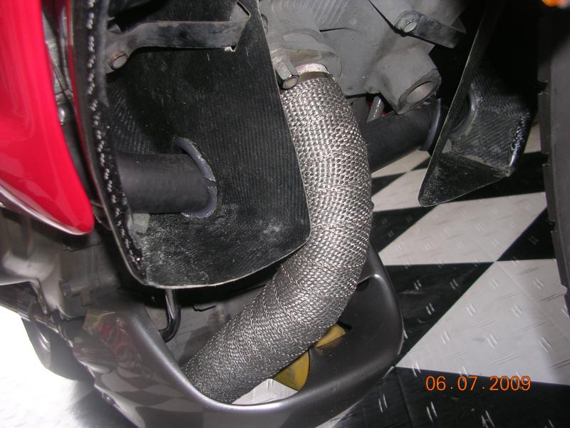

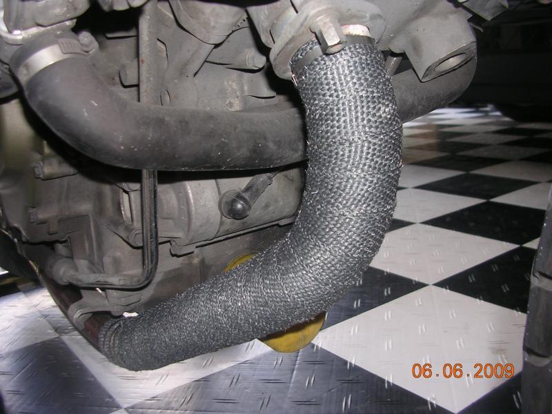

Here's some pics: topless air box, front header wrapped & new air scoops...
Attached Thumbnails Time for Stage I-06-09-09-sh-pics-035.jpg   Time for Stage I-06-09-09-sh-pics-036.jpg   Time for Stage I-06-09-09-sh-pics-037.jpg   Time for Stage I-06-09-09-sh-pics-041.jpg

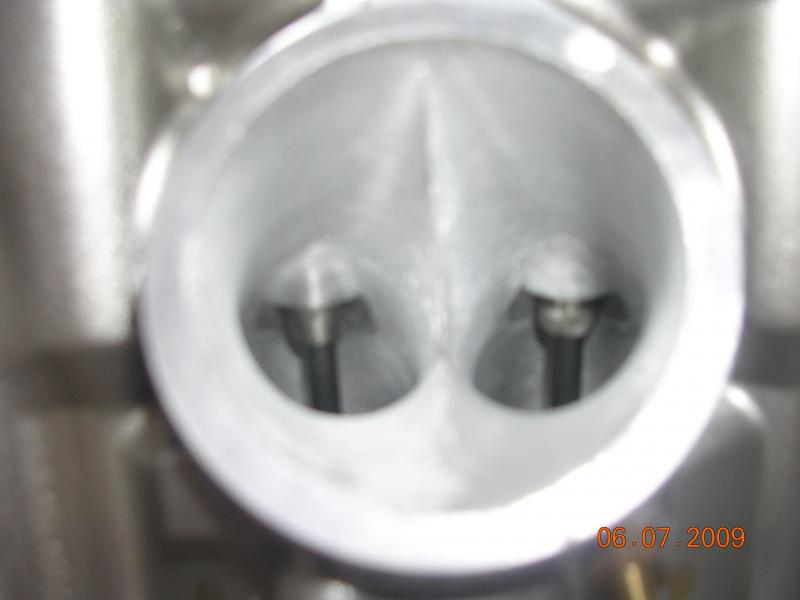

Here's some more pics: what air sees when hitting the scoops and one last look at the headjob...
Attached Thumbnails Time for Stage I-06-09-09-sh-pics-042.jpg   Time for Stage I-06-09-09-sh-pics-045.jpg   Time for Stage I-06-09-09-sh-pics-047.jpg   Time for Stage I-06-09-09-sh-pics-048.jpg
