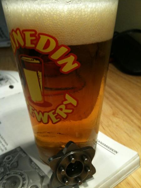

Tranny/shift issue found
Not sure why but the shift star failed and got cockeyed causing the follower to bid up = no shifts!
put new star in and shifts like a champ through all 6 gears
