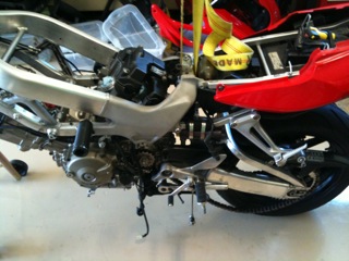

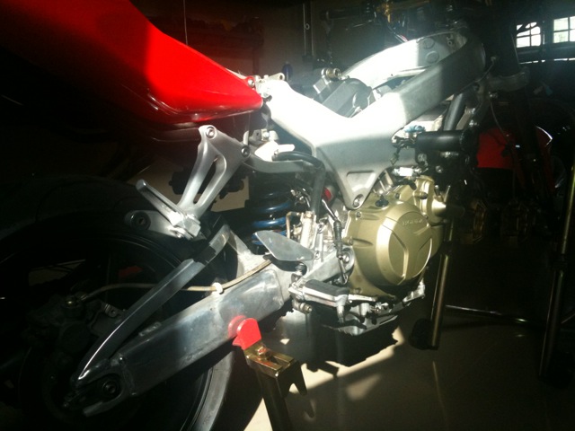

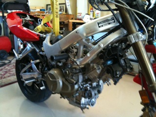

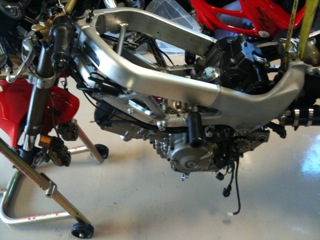

Busted a hemroid putting the fresh motor on the floor from the workbench by myself, but the heart it in the monsta!
Attached Thumbnails Time for Stage I-heart-in1.jpg   Time for Stage I-heart-in2.jpg   Time for Stage I-heart-in3.jpg   Time for Stage I-heart-in4.jpg
